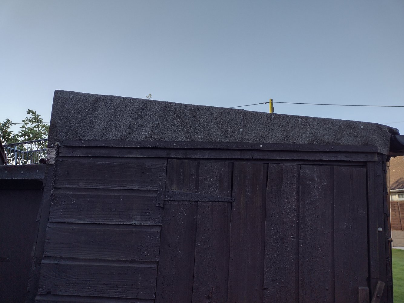

havent started on it....for the sake of argument it will just need a join on the epdm , old and new will be level ,i guess i would leave a few mm gap for expansioncan you show a photo of the flat roof thats butted up to the old build ?
evostick or suchlike? can it be roughed up with sandpaper firstContact adhesive with a decent overlap.
This ^^^^^^ contact adhesive will fail rubber to rubber, the jointing tapes Vulcanize the rubber much better but you must use the primer with it 1stApparently there's special rubber primer and magic tape for joining EPDM.
How to Join two pieces of EPDM | Rubber4Roofs
Video Guide Joining two EPDM Membranes on an EPDM roof. ClassicBond Roofing Systemswww.rubber4roofs.co.uk
Personally, for a shed roof I'd agree with everyone else and just stick it down with contact adhesive.
Additionally, dont use expired tape it doesn't take.This ^^^^^^ contact adhesive will fail rubber to rubber, the jointing tapes Vulcanize the rubber much better but you must use the primer with it 1st
They do a special glue and cleaning solvent.havent started on it....for the sake of argument it will just need a join on the epdm , old and new will be level ,i guess i would leave a few mm gap for expansion
or other words ...how do i join epdm on an overlap....
was prob just going to tiger seal it and lay something flat and heavy on it
