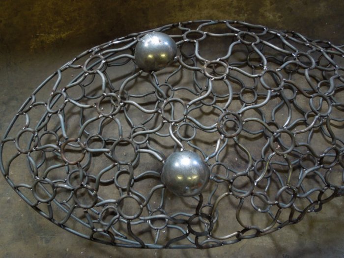

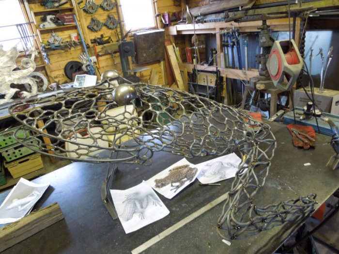

I make a lot of sculptures out of chopped off bars, and confess to thinking that there has to be a better way of cutting the bars, I have a good pair of bolt croppers that manage 10mm bright mild steel and claim to do 13mm but I am not fat enough to hang off the end of them.
Here is a recent ongoing project.
I agree I must be mad.
is there a better tool for the job?
I have tried using the bar cutter on my bench shears but it is hard to get the length exact, I am making dozens of pieces and they have to fit closely together, with my croppers mounted in a vice I just measure it using my thumb nail as the mark to cut to.
I need something with blades that I can access easily and have mounted easily to hand. The way I am doing it is very quick but is doing my arm in.
Any ideas? I have looked at hydraulic rebar cutters and they might do the job but look a bit pricy. Like these? http://www.metal-cutters.co.uk/bar-cutters.html
Are there any bench mounted tools with a compound lever action?
