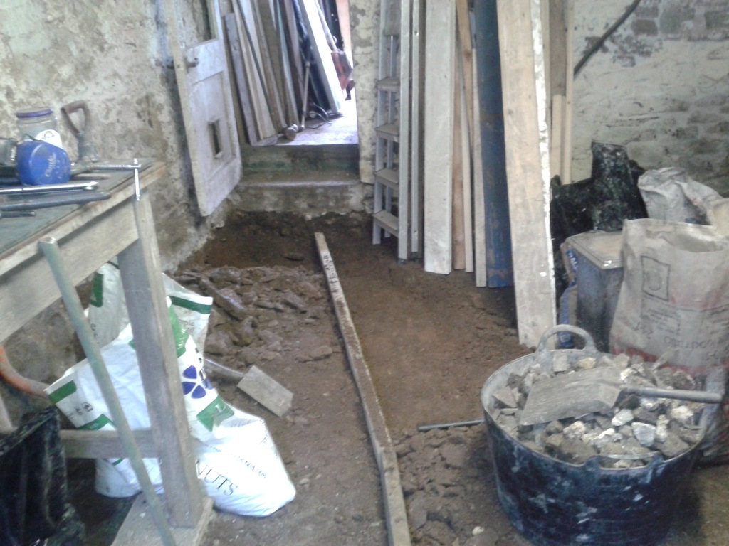

The access makes ready mix problematic.
As it is, im planning on buying the aggregate in 25kg sacks, so as i can carry it, by hand, through our kitchen....
When i last got a quote on ready mix, it was £70 per cube, with a £70 delivery charge. So about the same cost as doing it by hand, i think.
That quote is not recent though - again, its just easier with this one to mix by hand (with a mixer...)
Anyway, my next question -
This has been discussed before - how to tamp concrete when it is enclosed by walls. Someone suggested fixing batton to the wall above the surface and using a hanging tamper, but the walls are also not parallel which makes it more awkward.
What about shuttering off 8 inches or so along the walls, and casting a level edge that way. Trowel the top smooth, remove the shutter when its gone off, and then tamp off that surface? The join would be weaker though.
I have the corner in the photo, the corner to the right of that one, and then the last side will probably be accessible.
