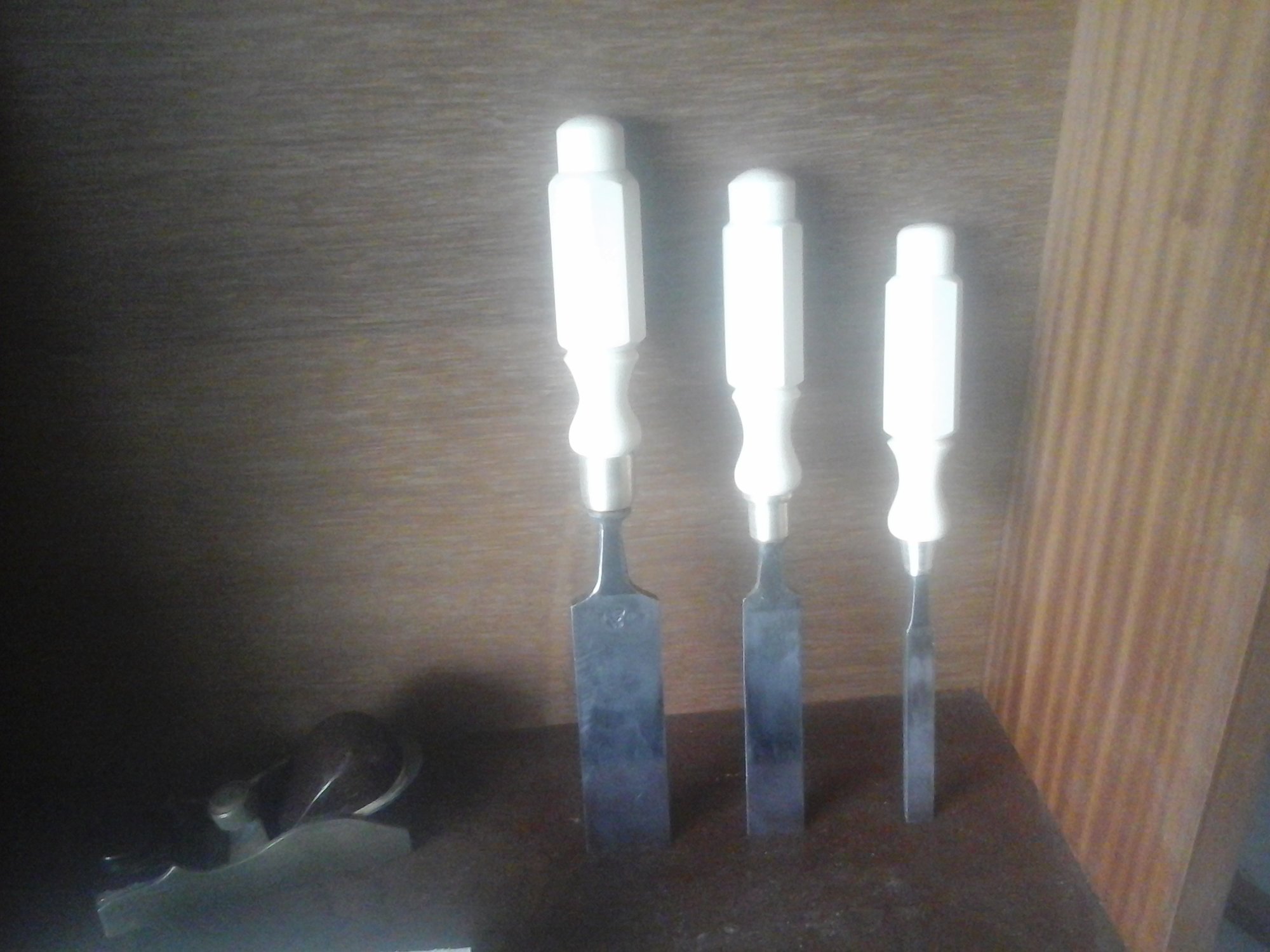

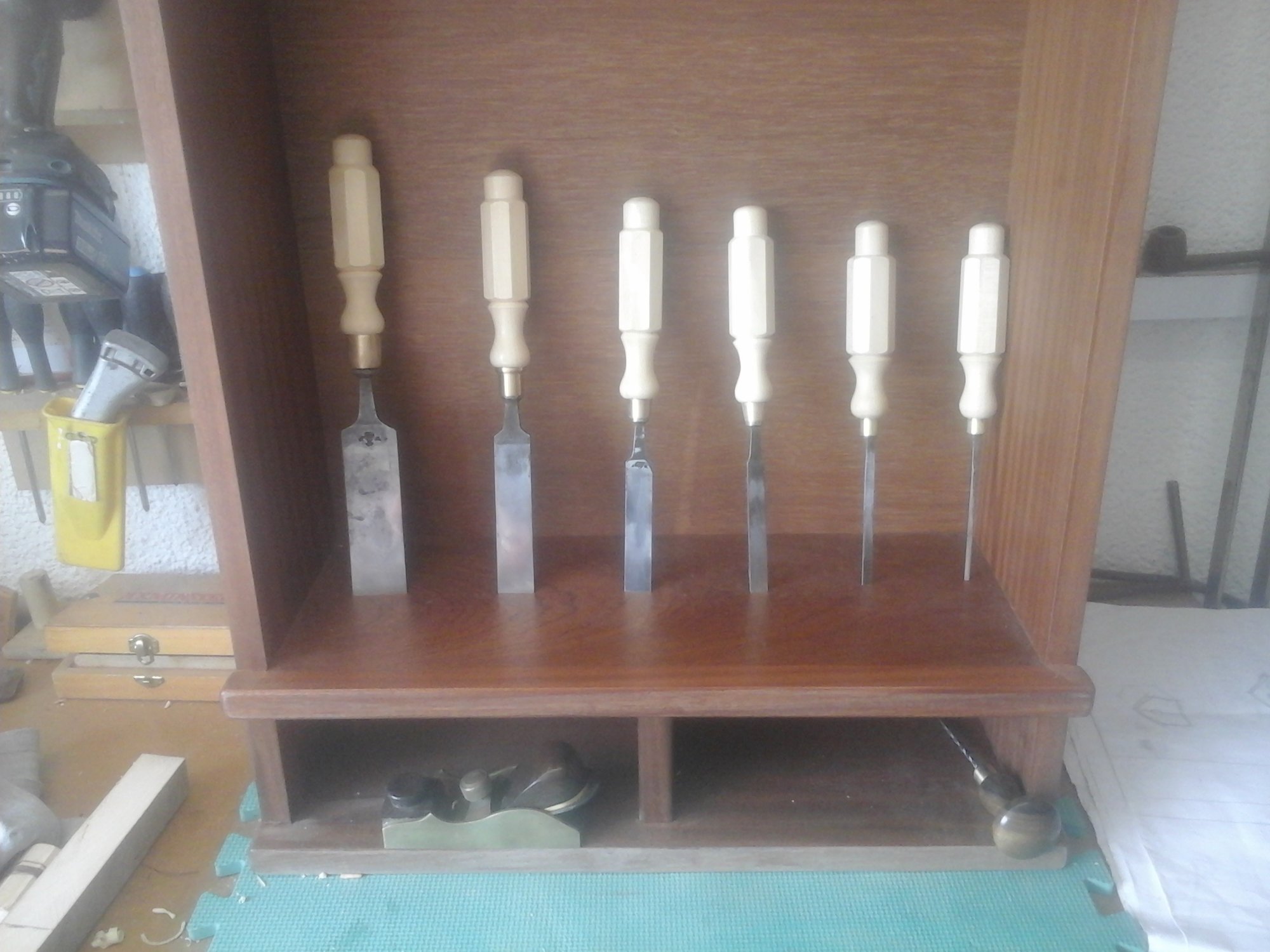

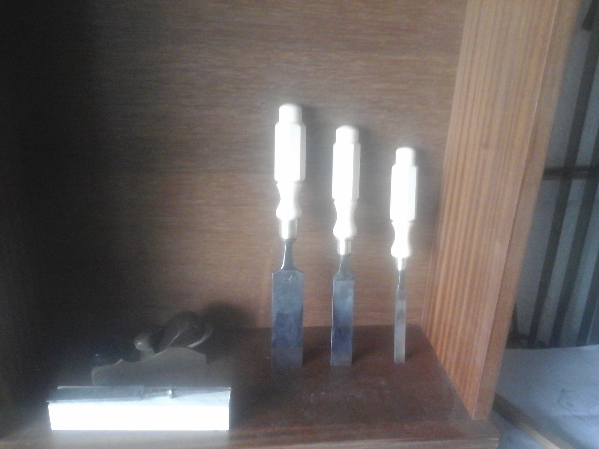

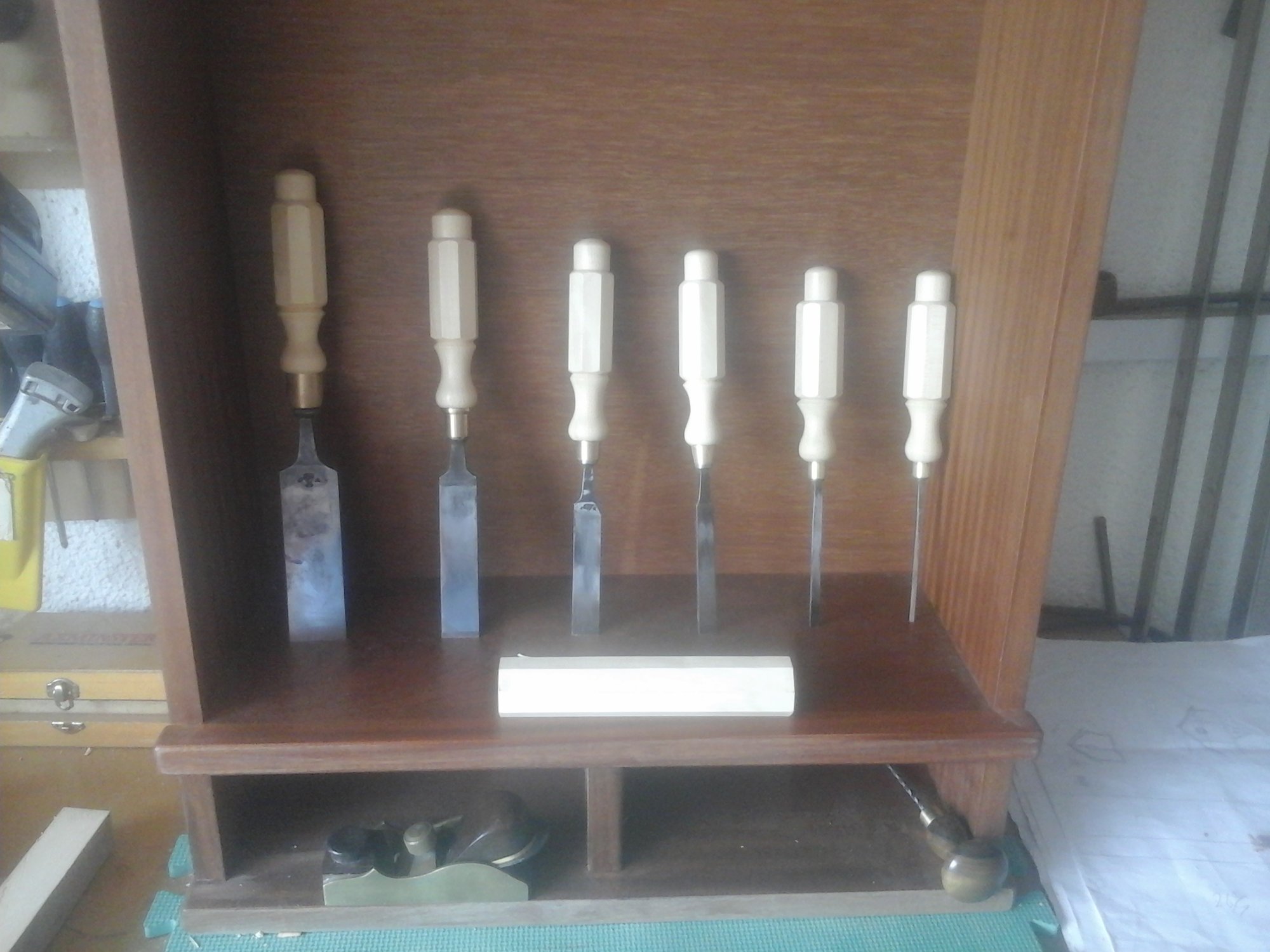

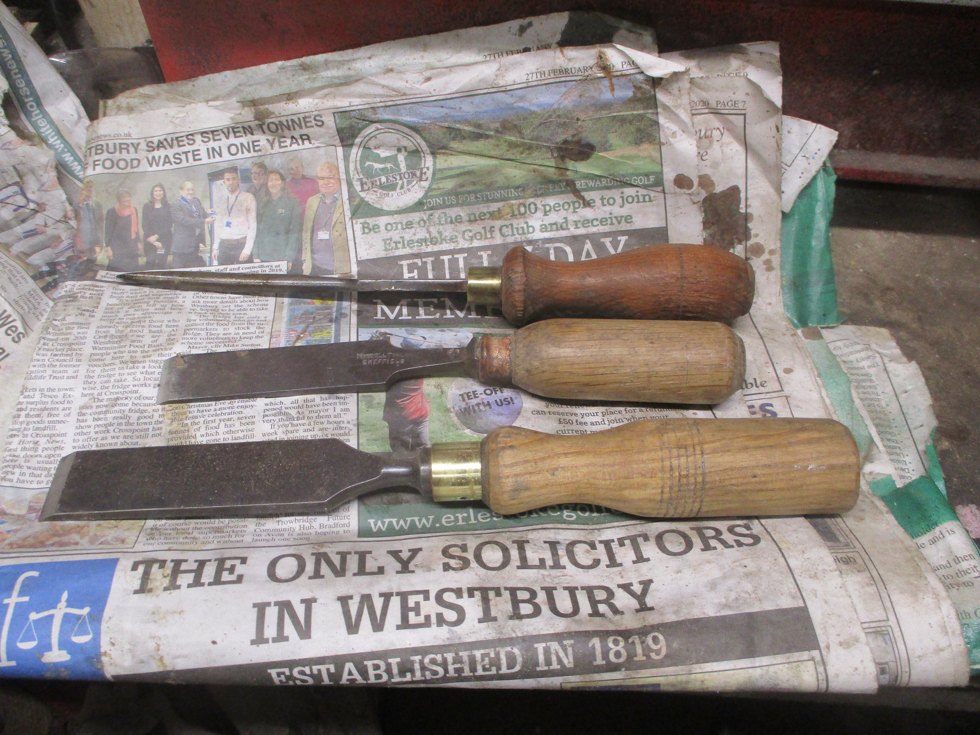

Hi , the snag is the handles all diminish in size to suit chisel, but wil bear in mind for future jobs, is that a Vic Marc bowl lathe in your pic , mine is a home made job with a tailstock liberated from Grytviken South Georgia in 82,Nice Job - try making copy fingers for accurate repition.

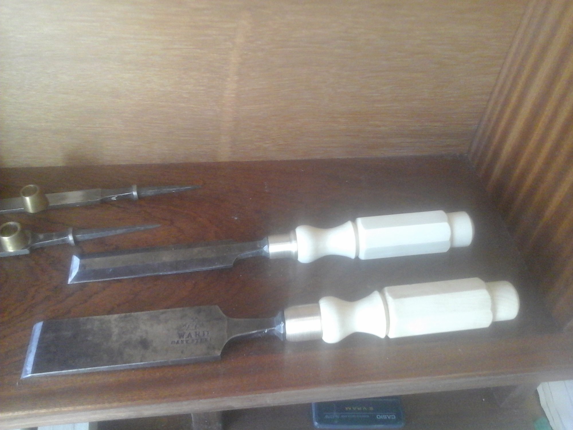

If you get a smooth finish with the paper, jus wax applied. On a slow speed will bring them up a treat.
Those blades will take an edge very well. @slim_boy_fat sent me some old ones once. They are great.
Don't be tempted to use a grinder on them. Use an oil stone and a guide to bring the angles back. takes time. but will be worth it
Hi the chisels are treasured , the backs are mirror finish , when I sharpen I only back off on a flat plate with autosol chrome polish on, easily shave hairs on my arm ,

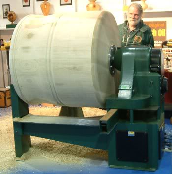

Hi that's what I meant VB , you must be a pro turner as these are VERY expensive ,No I am lucky enough to have a VB36 with the long bed. 36" over the bed and up to 5`9" with the bed bars removed, very nice bit of kit smooth and powerful. Not me in the image but gives an idea of the capabilities.
