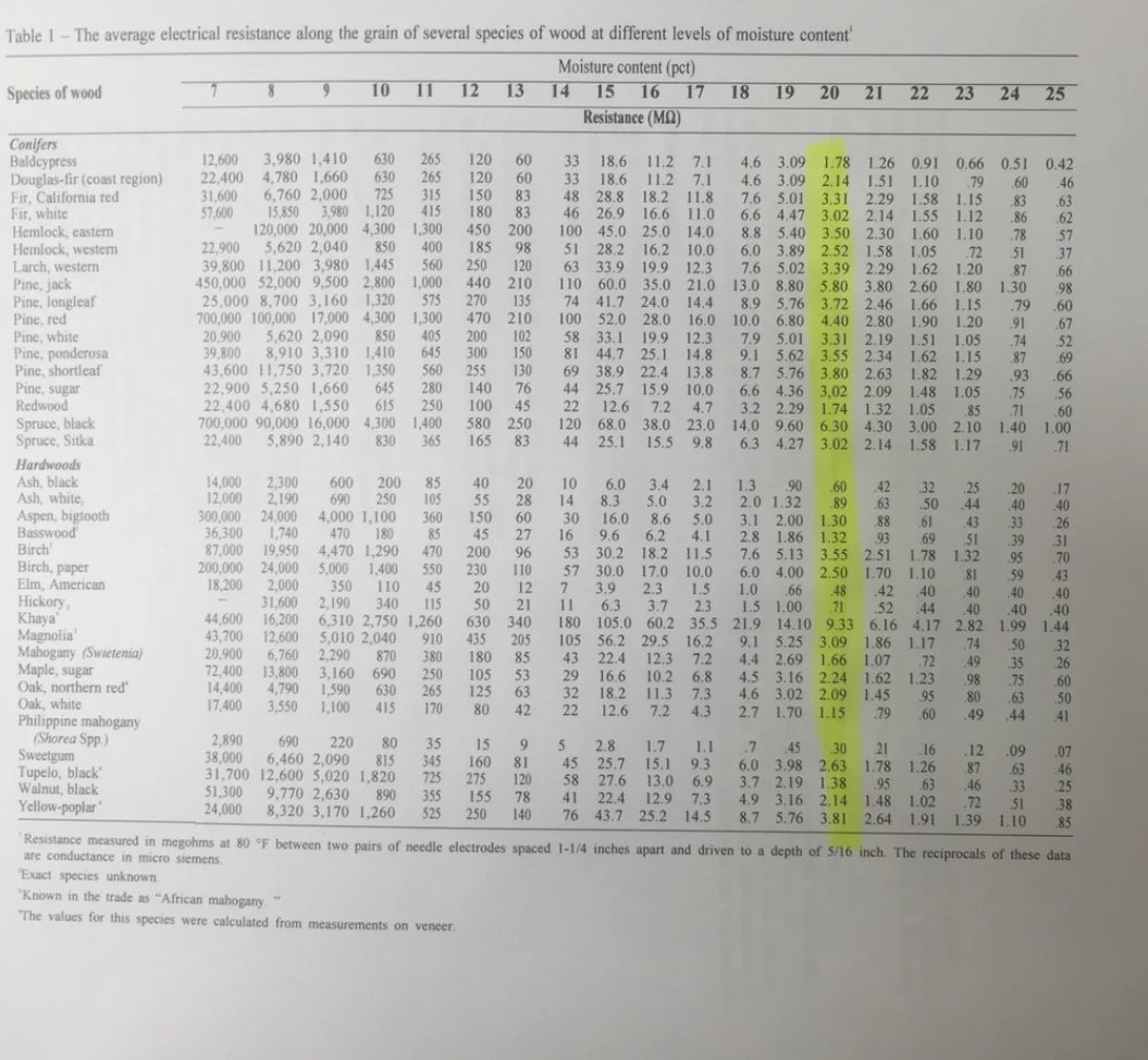

A firewood supplier, who gets inspected, told me the proper way to measure firewood moisture is to split it and measure across the grain in the middle of the split face. Try to keep the pressure consistent between measurements and don’t press too hard.
14-20% is the aim - too wet and it won’t burn well, too dry and it’ll burn too quickly, and you’ll have lost some calorific value. Opinions do vary, though.
Didn’t think of that. I assume the meter probes have to be the same distance apart for consistency?Looks like you could..
There are tables on the Internet that show you the resistance for the moisture content.
They even cover different brands of wood!

I found that and tried last night. Reading more it seems like I'd need to drive nails into each bit of wood about 1.5" apart and then put the probes on them. I tried sticking my sharp.multimeter probes into the wood but couldn't get a reading. Then gave up and ordered the stihl meter.Looks like you could..
