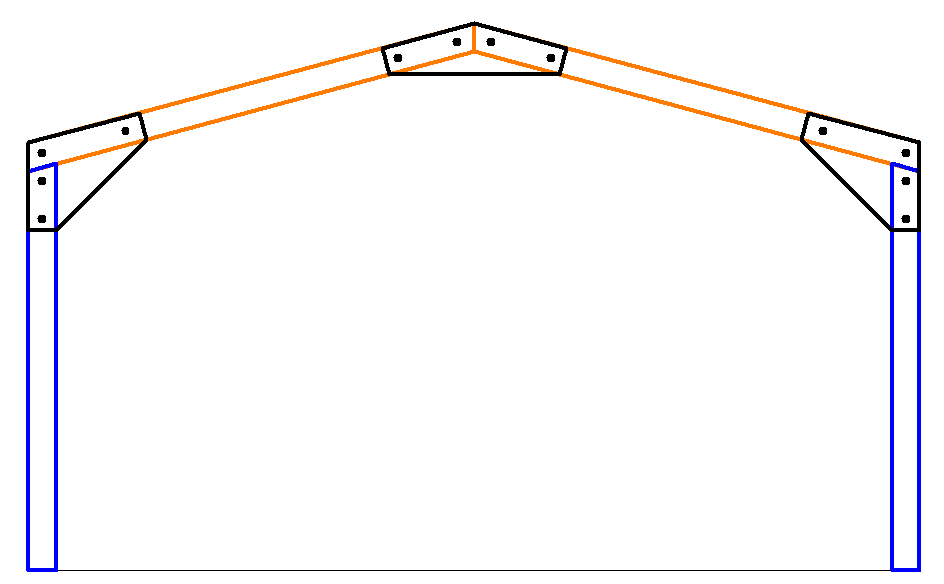

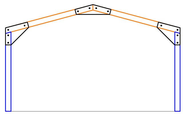

You might consider installing portal frames, allowing you to remove those two trusses altogether.
Portal frames of my 15ft wide shed are made from 47x150 timber, in pairs to produce 94x150 stanchions and rafters. Stiffness is provided by triangular gussets, cut from 12mm plywood, everything held in place by 12mm bolts (located on the neutral axis of the timber).
There are big washers, and the bolts were tightened so that there is a lot of friction between the plywood gusset and the timber.
