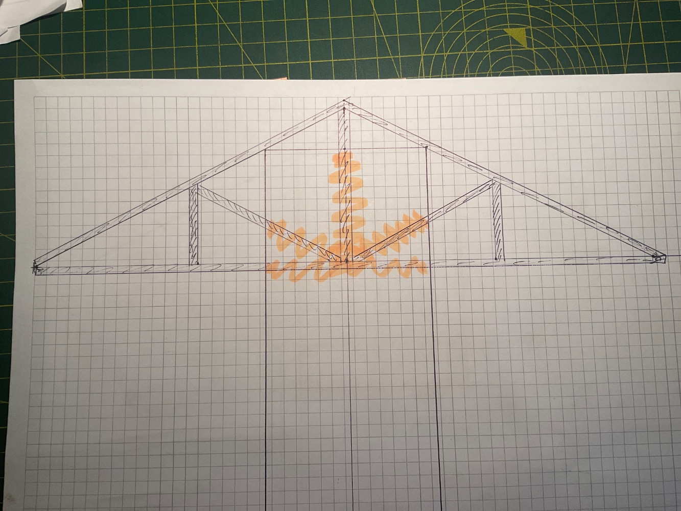

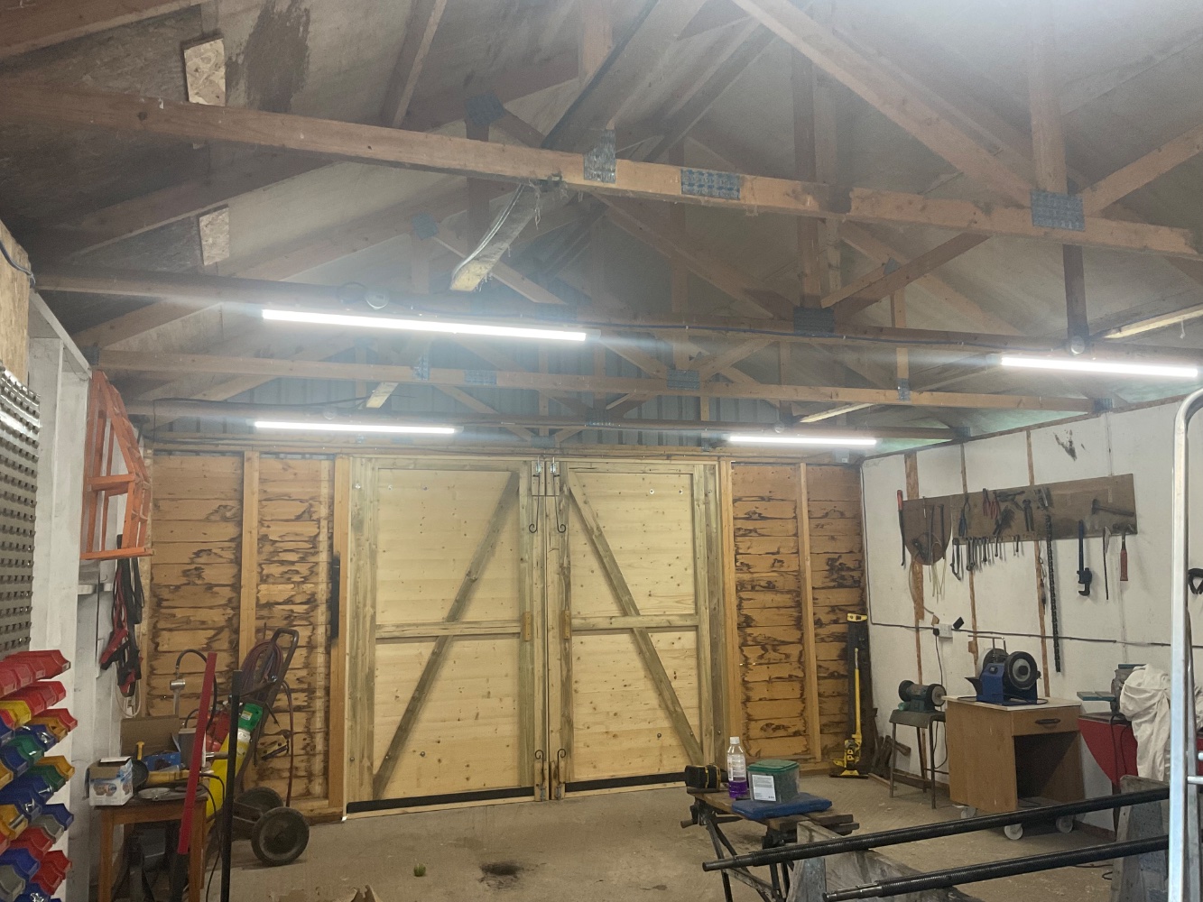

Here is the area. If you start counting at the back truss, above the doorway, I need to remove all members of trusses 2 and 3 (ideally 4 as well, but not essential), apart from the top rafters.

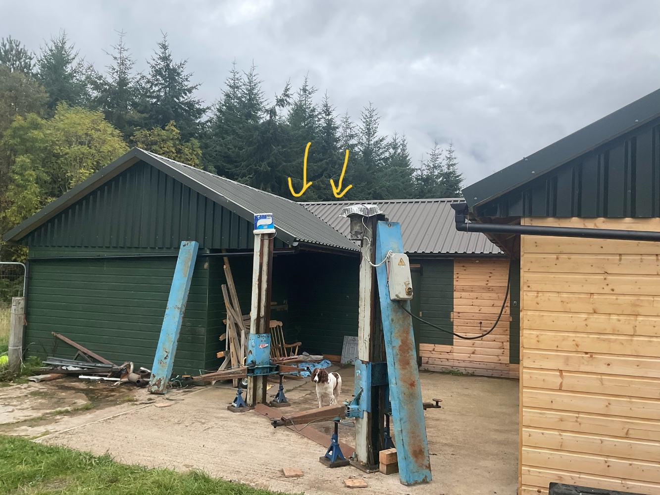

The roof is box profile with ply underneath. Approximate position of the trusses arrowed:

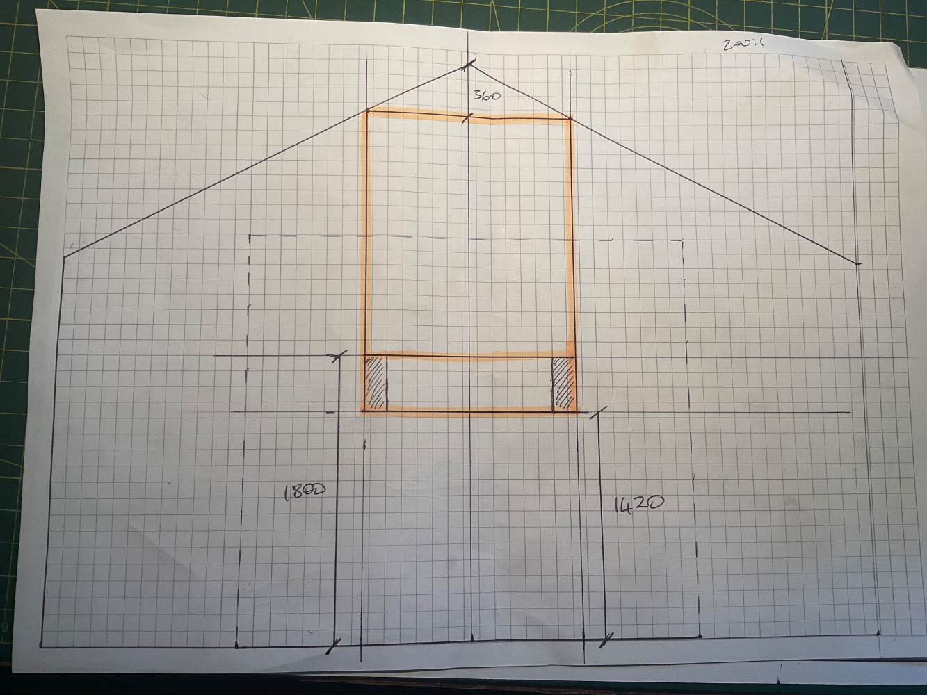

Looking longways on the scale drawing, there’s plenty of potential room to lift my Landy. It doesn’t need to go this high (one benefit of being a short*rse). The 1800mm dimension is to the bottom of the chassis rails. 1600mm would be plenty. Angled lines show the bottom edge of the rafters. Dotted box is the outline of the car lift:

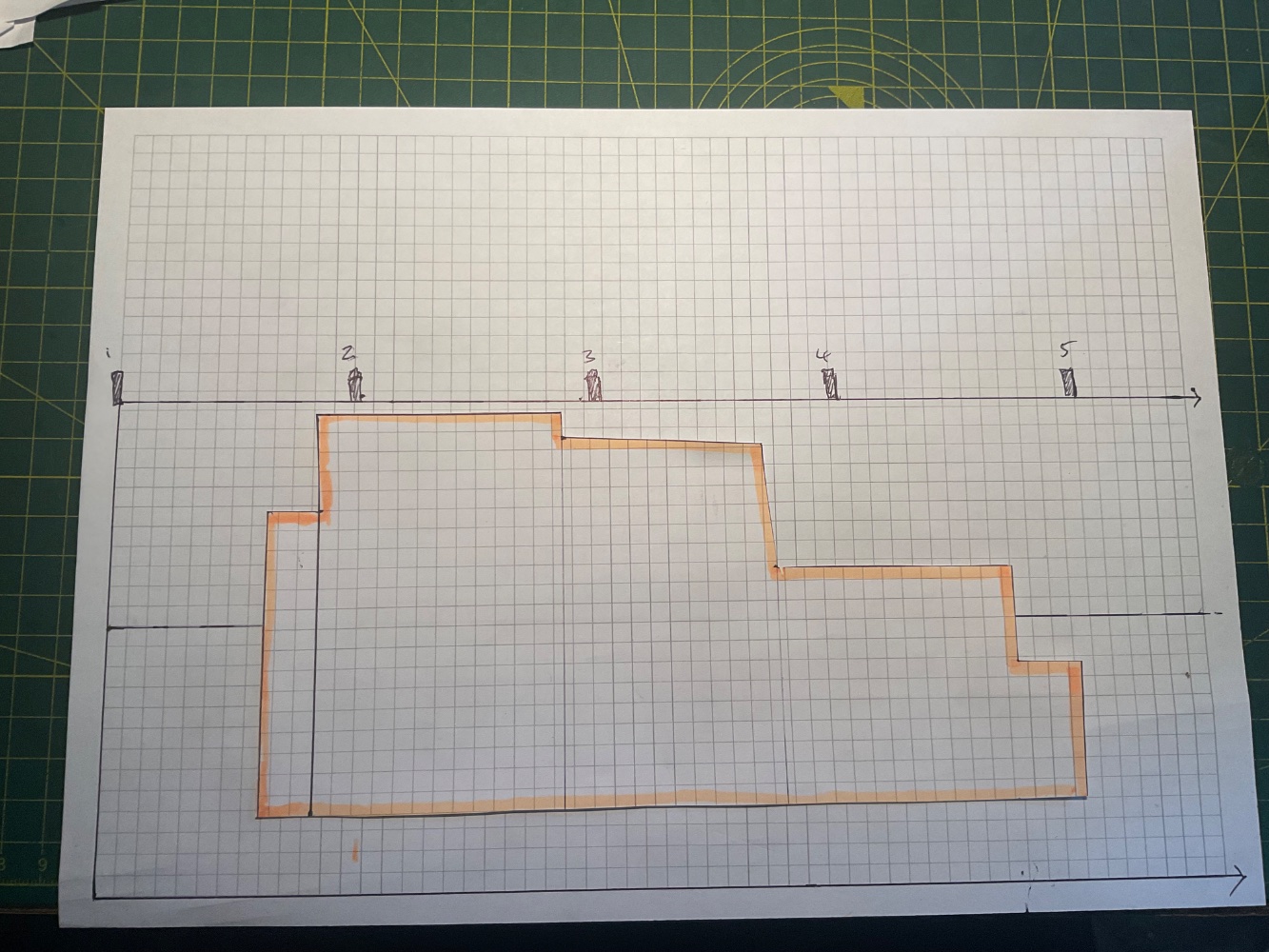

Side on, you can see that truss 4 might be a problem if the bonnet is open, although you can remove the Landy one. Line of required lift shown:
So, advice, please, on gutting trusses 2 and 3, at least, and maybe modifying no. 4 less drastically. Some points:
- The workshop is well sheltered by trees, roof pitch is decent and snow loading light here in the Moray microclimate.
- I’m half thinking the posts of the lift itself could be used structurally.
- Otherwise, stout plywood gussets at the apex, as big as I can make them, maybe some brackets to the walls?
