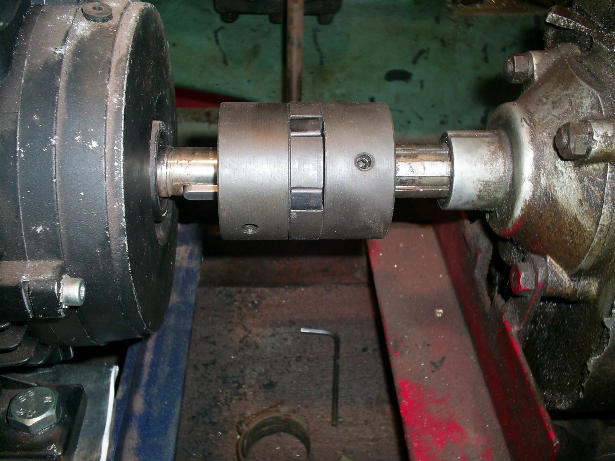

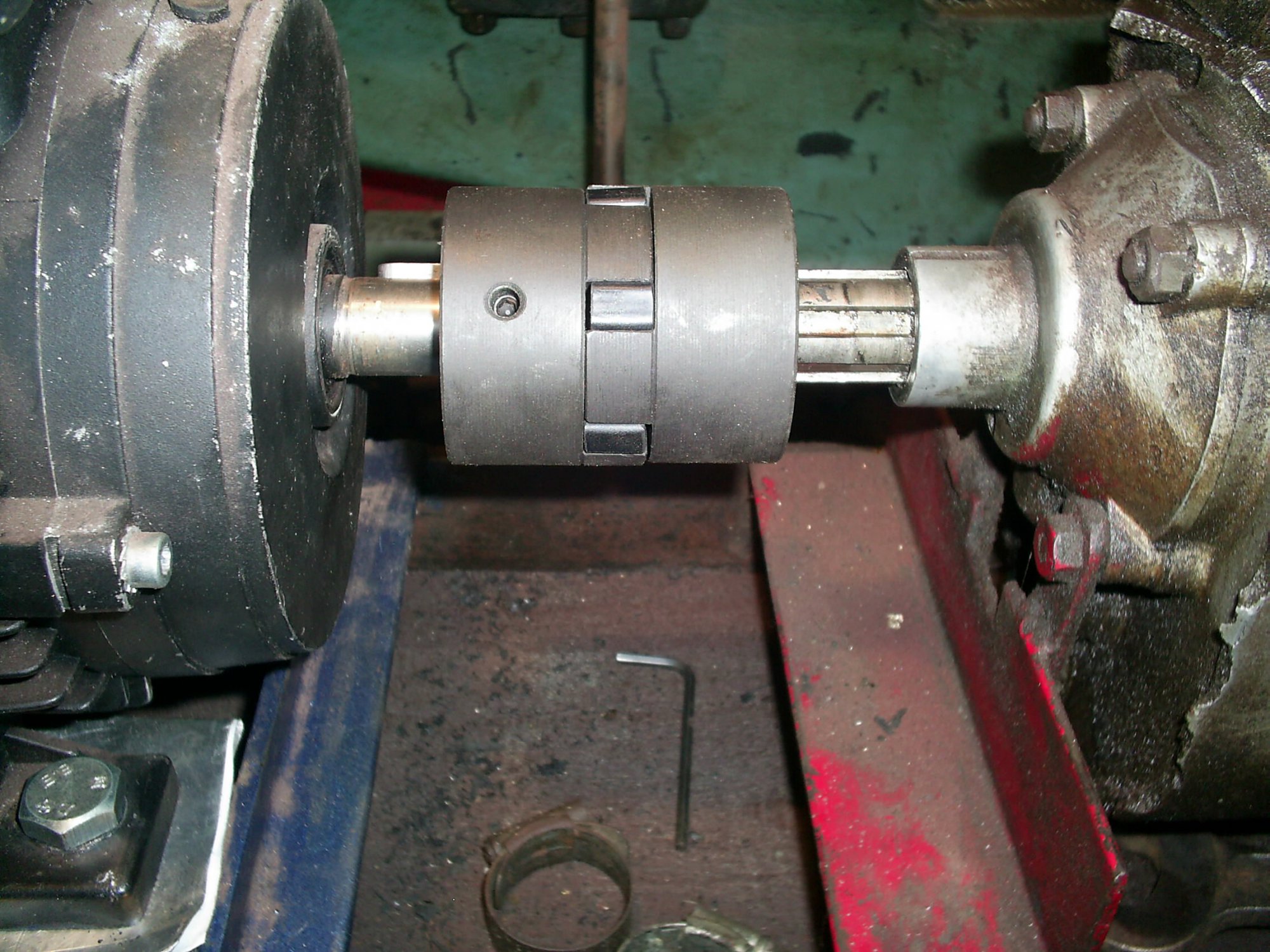

An update of this is that johnnybravo kindly supplied and machined a lovejoy coupling for me and it fits and works a treat. I will post a photo of it tomorrow.
So I decided to check the speed of the lathe now it has got a working coupling. The gearbox had been modified selection wise to give just two speeds by restricting the select lever to be moved forward or rearwards. The gears that are selected must include reverse as one powers the chuck clockwise and the other anti clockwise looking at the chuck from the bed end. So in clockwise rotation it spins at approx. 460 rpm and at 374 rpm in counter clockwise rotation. Does it matter much which way the chuck turns as regards the cutting?
