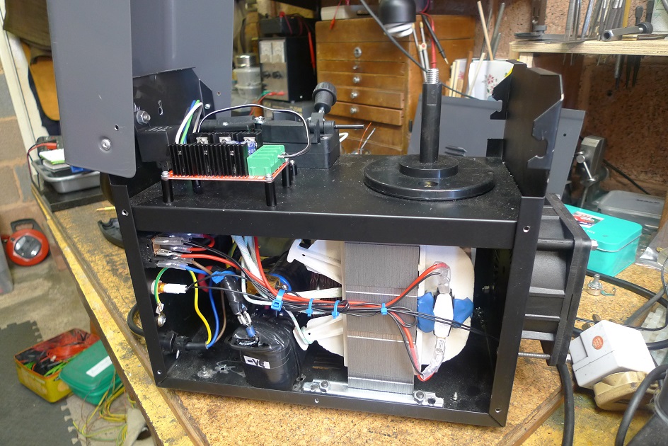

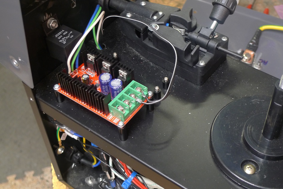

If you wire from one end to the other end of one gang of the 50K twin-gang pot, ignoring the slider, that will give you a 50K "fixed" resistor. In series with that, use the "start" and the wiper of the second gang as the actual speed control. This gives you an effective value of 50K to 100K, covering the ~75K "sweet spot" with a higher degree of control.
