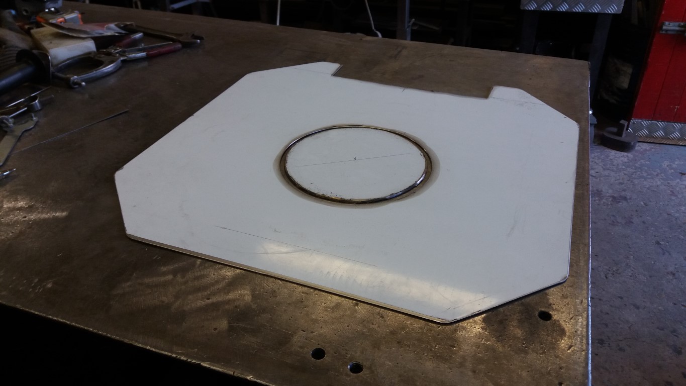

The scales come with a mounting bracket for the head and the battery, so that was welded direct to the frame, the load cell has three adjustable feet, these are located in some rings welded to the base plate

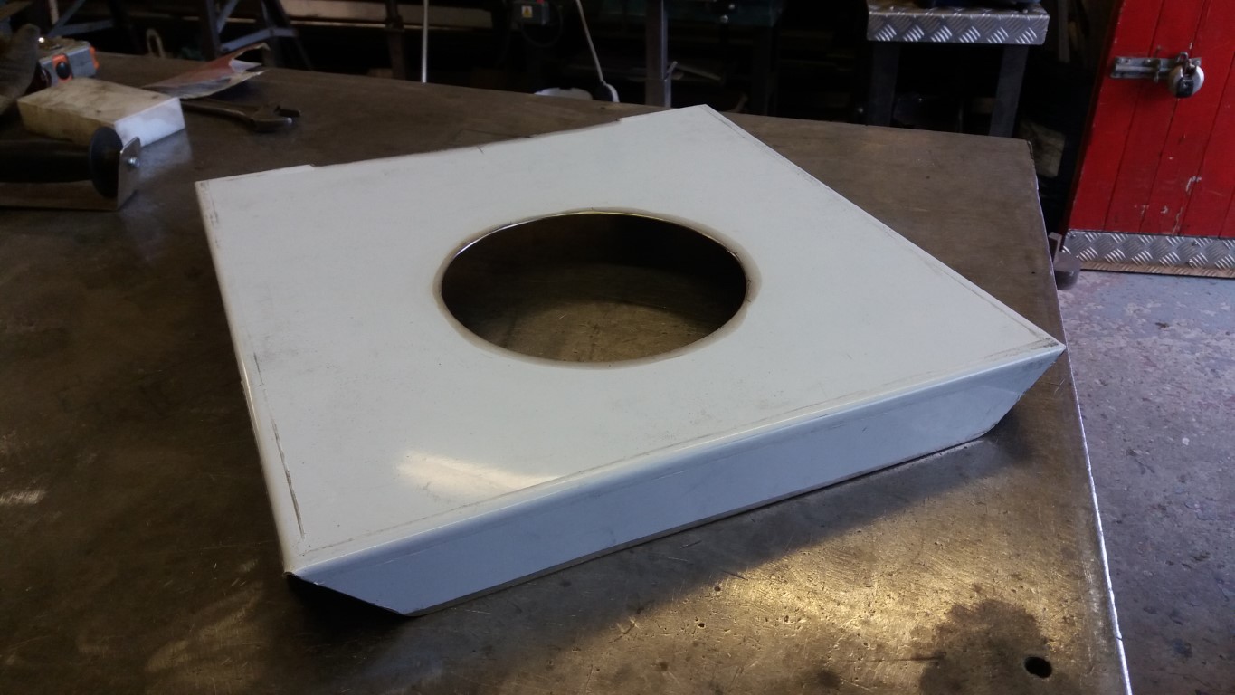

Next a sheet metal cover, this is 1.5mm, the hole cut out with a thin cutting disk, and finished to size with a flap disk, then bent up on the flypress.
And finished, the top is fixed on with a couple of button head screws, surplus cable hidden under the top cover
