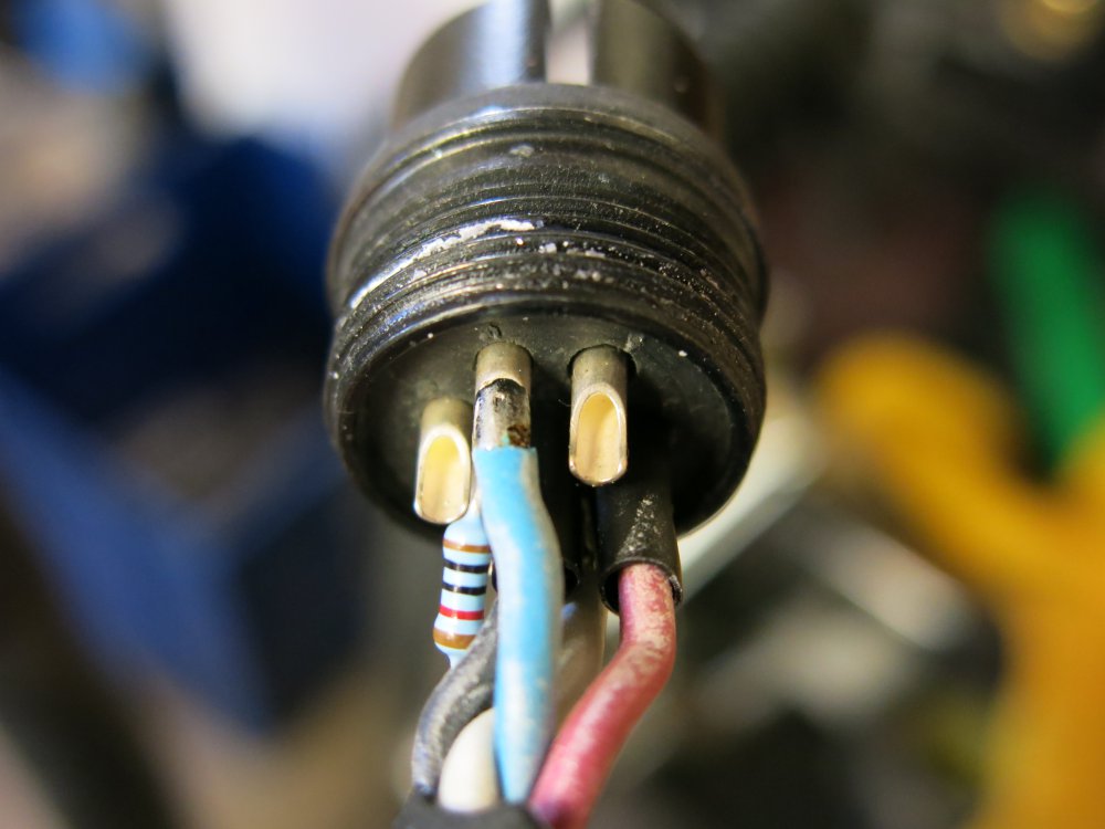

    Hi Guys,
    I have had all the wires cut on my torch and they are all black so no way to know how to reconnect.

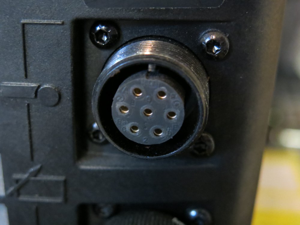

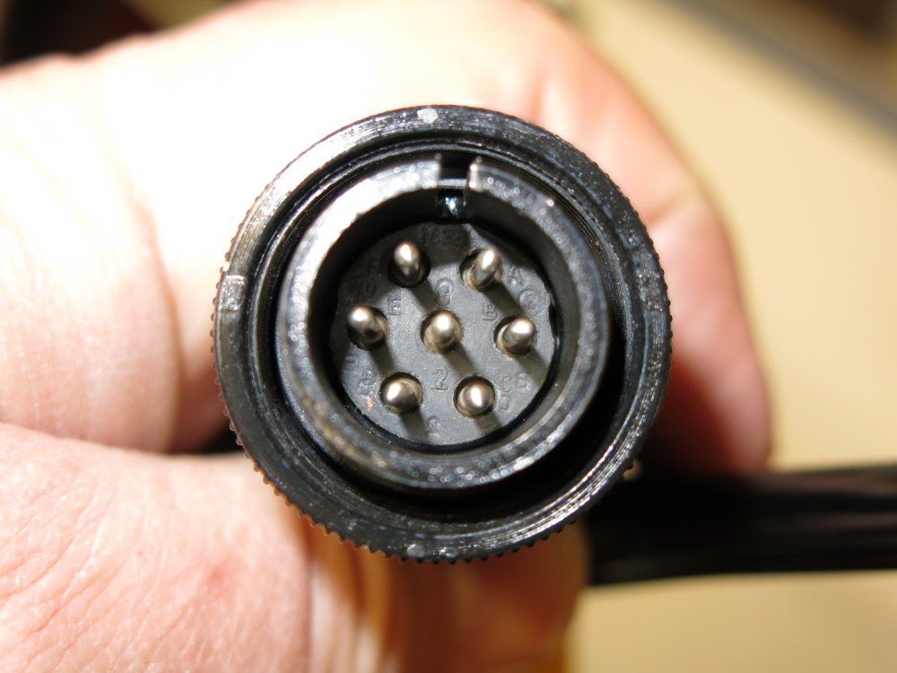

    The plug is a Mil spec with pins "lettered" from A to F.
    It should be easy as there is only "on/off" and "power up/down" to connect.
    Can anyone give me some simple instructions - i.e. A to B is on/off etc?
    Thanks
    Ben

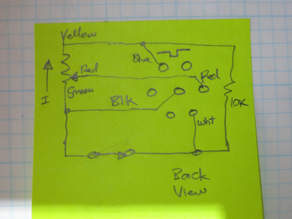

    i can check it out in the morning, about 12 hours from now. I only have a switch on my hand piece. This is the wiring for the foot pedal, note the resistor in the plug. Does your torch have the variable current control?
    The other thing you might find is trace numbers on the wires, they can be small.

    There was no trace information on the wires and they were all black so THANKS KEMPPI for the "Joy of Welding"
    For technical information i have the TTC220 Torch with the RTC20 "Linear" current controller (an up down switch) that is really too hard to use while actually welding (at my skill level and projects i work on)
    The wiring diagram looks exactly what i need and i do not have any water cooling.
    Thanks also for the wiring diagram for the foot pedal, which was going to be my next upgrade. I have managed to find them on Taobao (China Amazon) for 230RMB (~25 Quid) so ill buy one and see how the wiring looks, it may even plug and play.
    Does anyone know how sensitive these plugs are to mis-connections, shorts etc? Can i blow the machine up if i get it wrong, even perhaps the wrong resistances? kinda seems like something Kemppi would do, to booby trap their own machines! Whats the resistance range on the foot pedal?

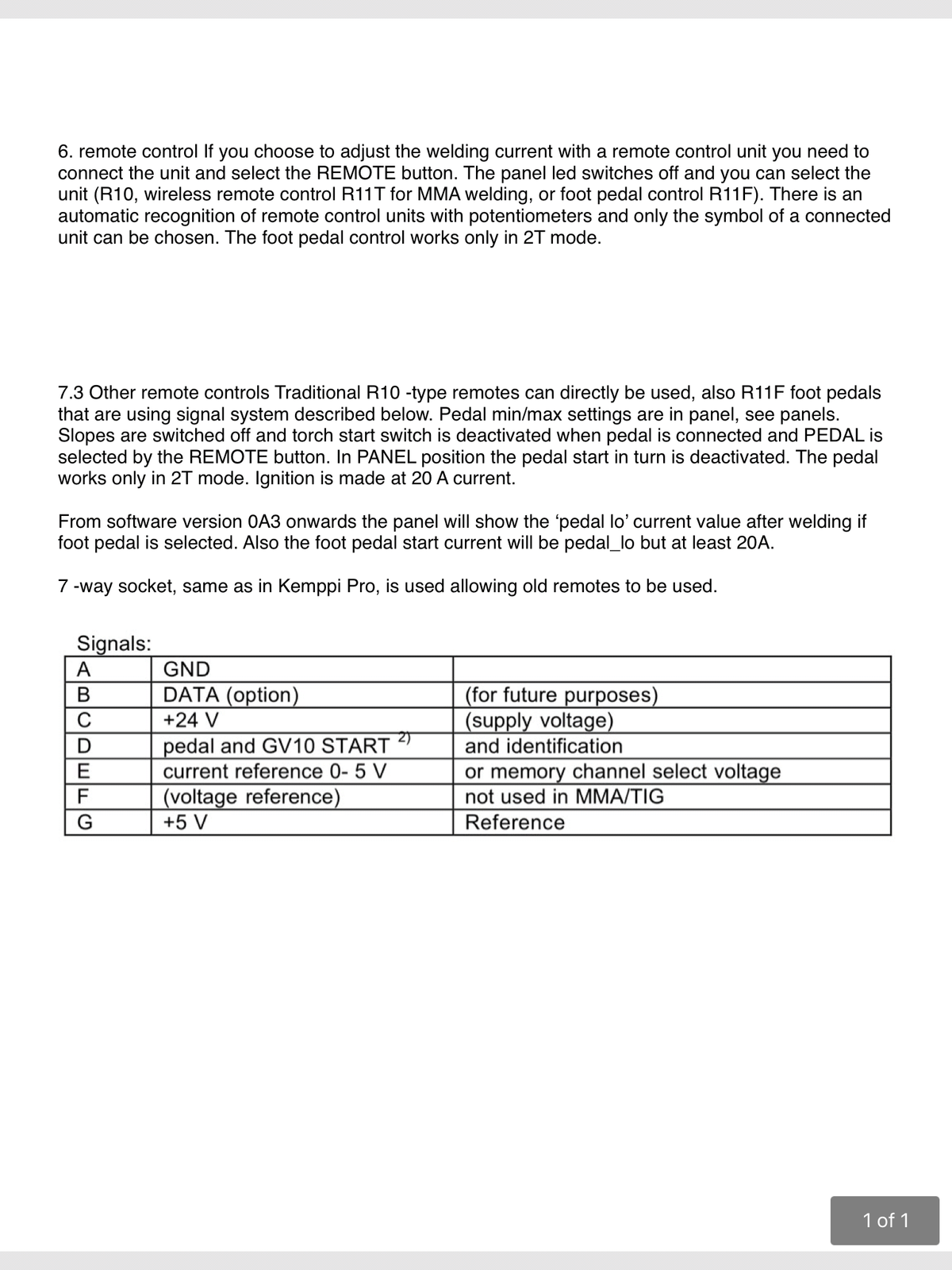

    Can you access min/max when pedal is not connected?
    Is it also right to have access to set up and downslope even in pedal mode?
    Here is some info from Kemppi manual regarding remotes:

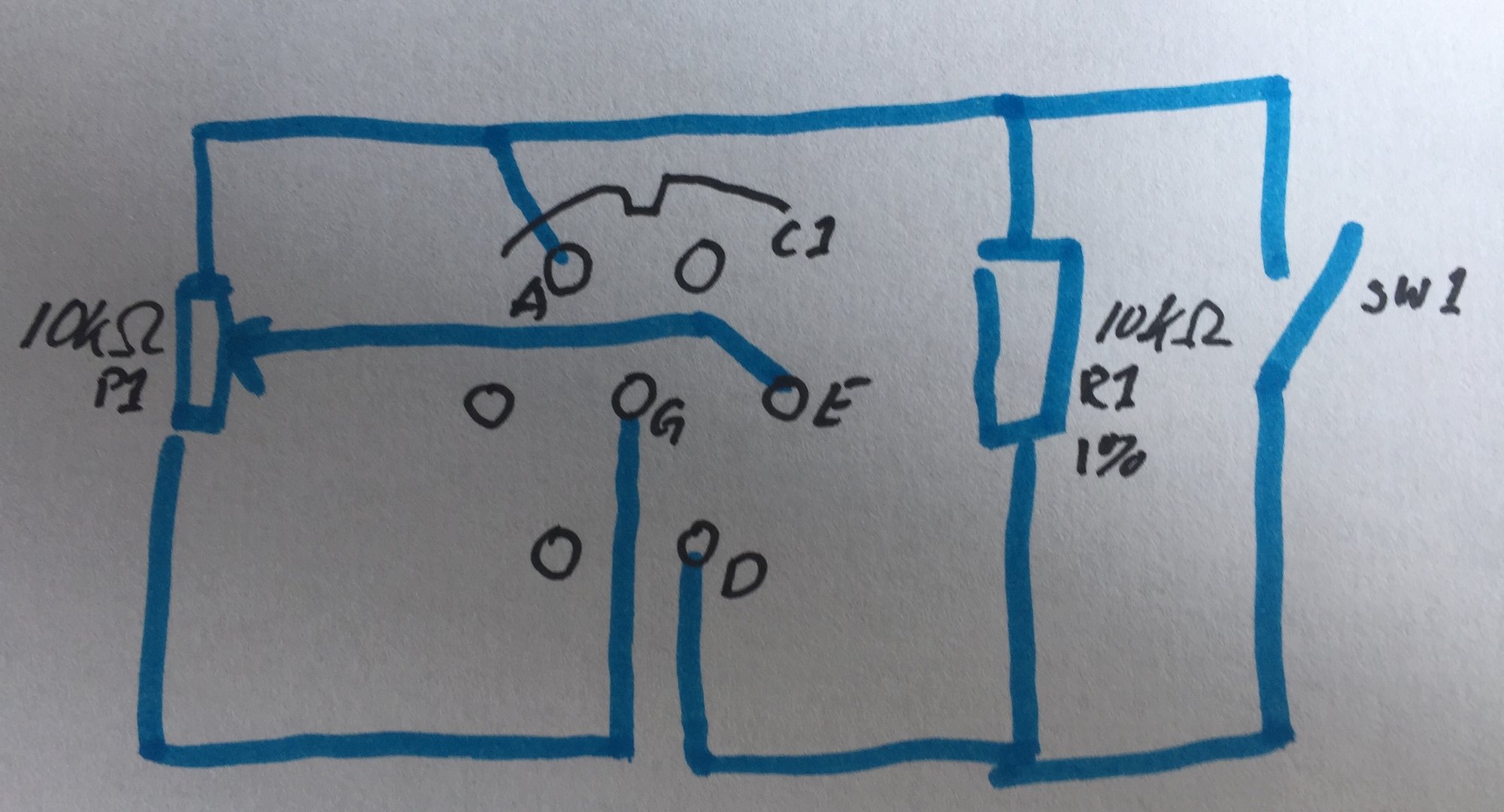

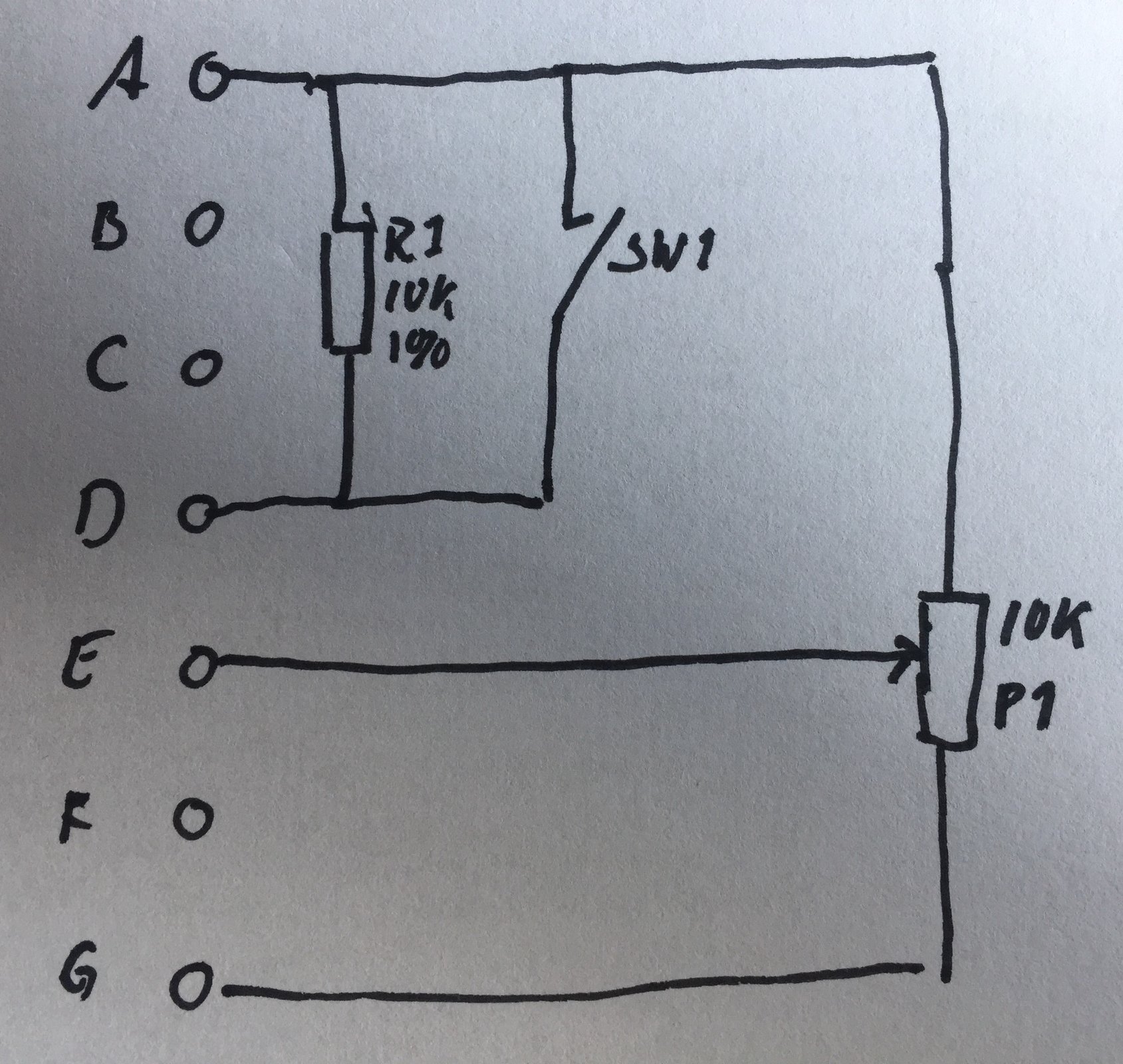

    I know this is an old thread, but when you google on the internet, it looks like this is the only info you can find. I'm making a pedal for my Kemppi. This thread helped me further.
    In te drawings of Gavin, the switch is between 5V ref (G, the centre pin) and D. This didn't work on my machine (Kemppi Minarc TIG). I needed to switch it to ground, just like the drawing Hans posted. I also used a NO (normally open) switch, just to be precise. So without trying being an ass, I think that's a little error on the schematic (yellow post-its).
    The extra 10K resistor (also post of Gavin) was very useful information though. This resistor is used to recognize the pedal (in combination with the 10k pot). That would explain "and identification" from the previous post in this thread. Without this resistor the machine things it's just a remote pot like the R10. With the 10K resistor, my machine refuses to go in 4T modus when pedal selected, as it should. Without it it just goes into 4T mode, which is weird with a pedal :)
    Just wanted to share this info and make this thread complete.

  16. Gert-Jan Member
    Messages:
    21
    the Netherlands
    Certainly, between A and D, in parallel with the switch. The resistor on the photo that Gavin posted is 1% tolerance.
    Drawed the schematics. Just like Gavin did, the first one is from the backside. Just look at the letters on the connector.

    0,6w is just fine. Hardly any current will flow with 10k.
    The connector is a Amphenol type, mostly clones are used. But you can unscrew them. The terminals are quite big, shouldn't be a problem. Make sure you don't contact other pins with the resistor ends.
    Or solder inside the pedal, would work also I think. Soldering inside the connector might reduce noise from the long cable, that might be an advantage I can think of
