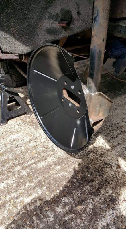

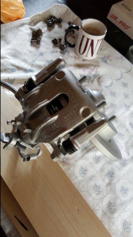

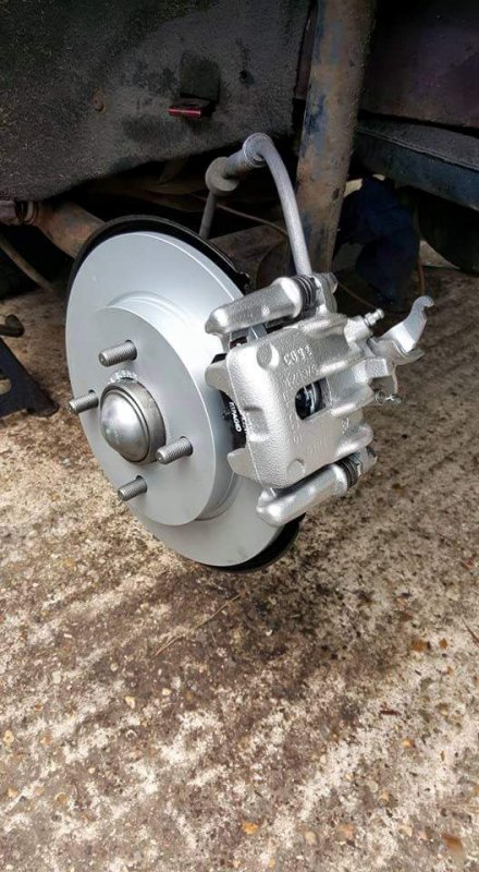

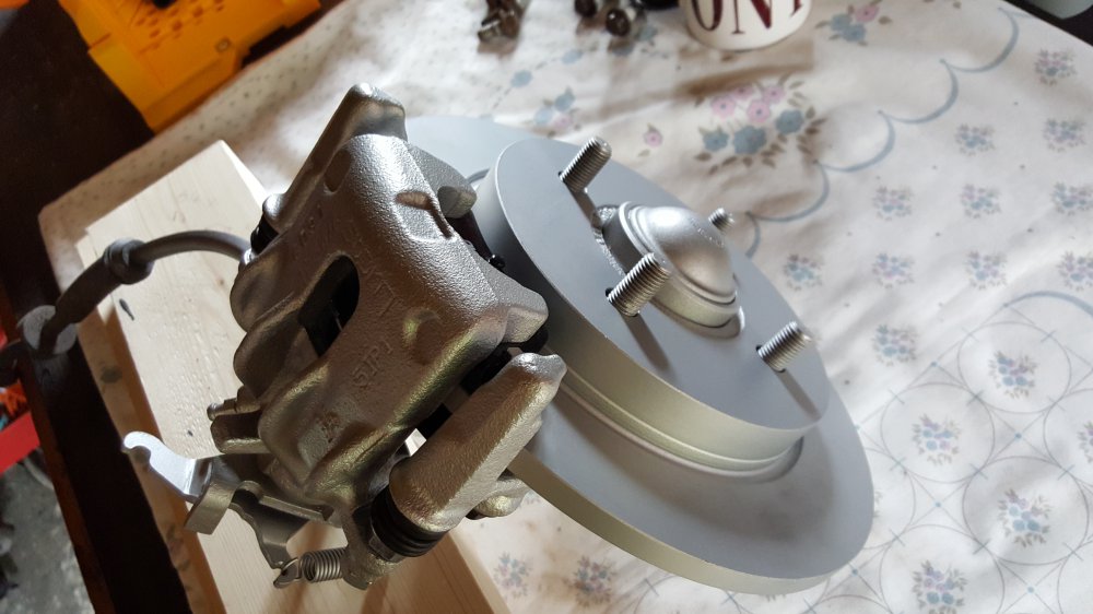

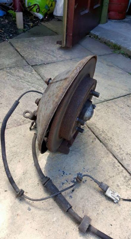

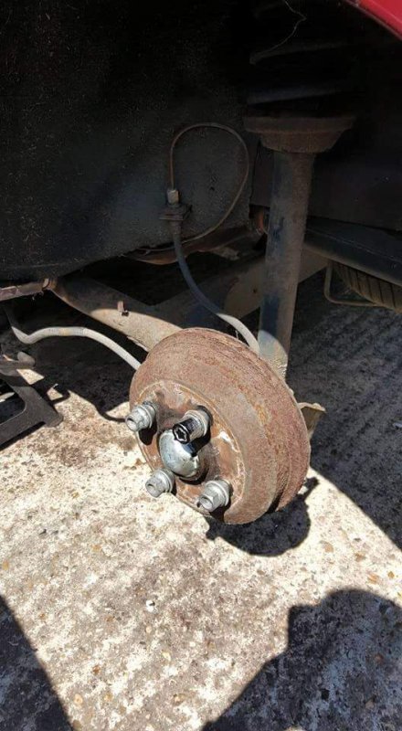

His all.just thought I would post a few pics of a rear disc brake conversion I am doing. .
Luckily the fiesta doesn't have abs..but might have to fit a bias valve on the rear..will see how they lock up when I have finished......
hello where did you get this conversion kit pleaseHis all.just thought I would post a few pics of a rear disc brake conversion I am doing. .
If I can remember I think they are mk1 ford focus rears. Its such a long time ago now. The fronts I think I fitted mondeo calipers/discs. You have to shave the calipers. I might have the photos somewherehello where did you get this conversion kit please
