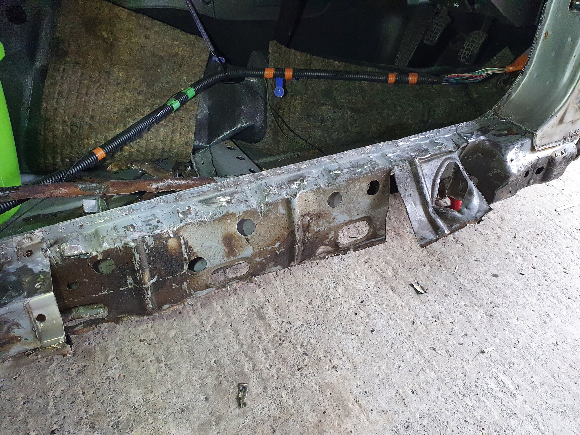

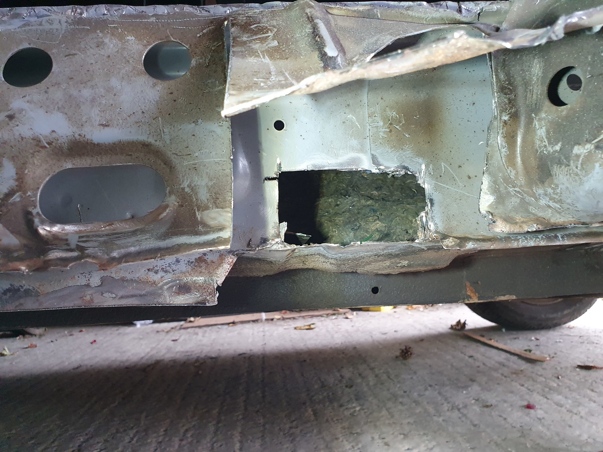

    In my case what started out as an OS rear arch/sill repair has now turned into outer arch, inner arch lip, sill end plate, full sill, inner section of sill, under sill and going up to front inner arch :doh: and on top of that, the NS rear inner arch is full of fiberglass and sill is crumbling, both front chassis rails are shot, there's a rusty hole under the rear cross member, the battery tray is rusting away and both A-pillars are rusty which seems to have caused a small crack along the screen! MOT expired on 1st August so all of this + a few mechanical bits would need sorting before I can get it back on the road!

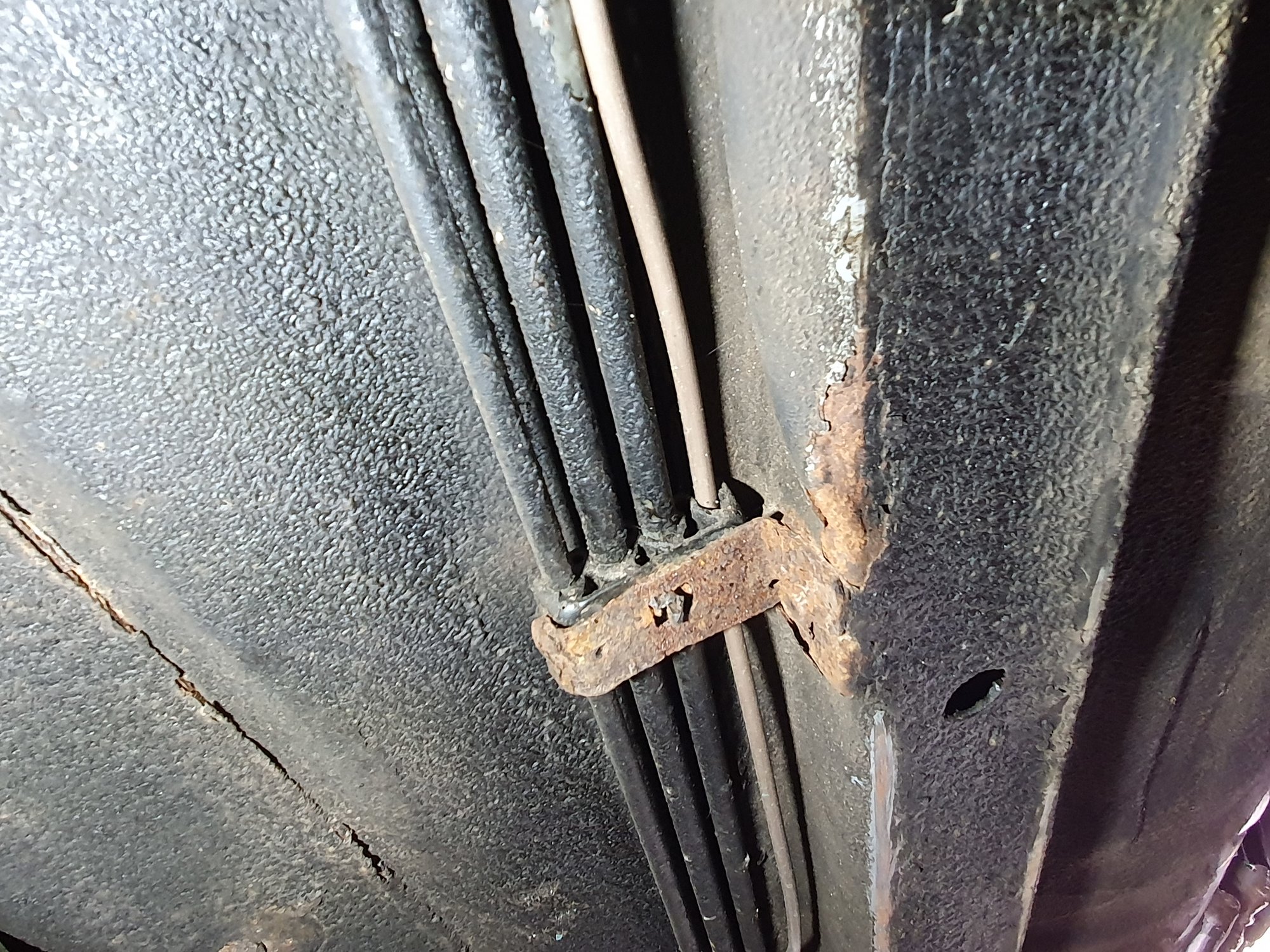

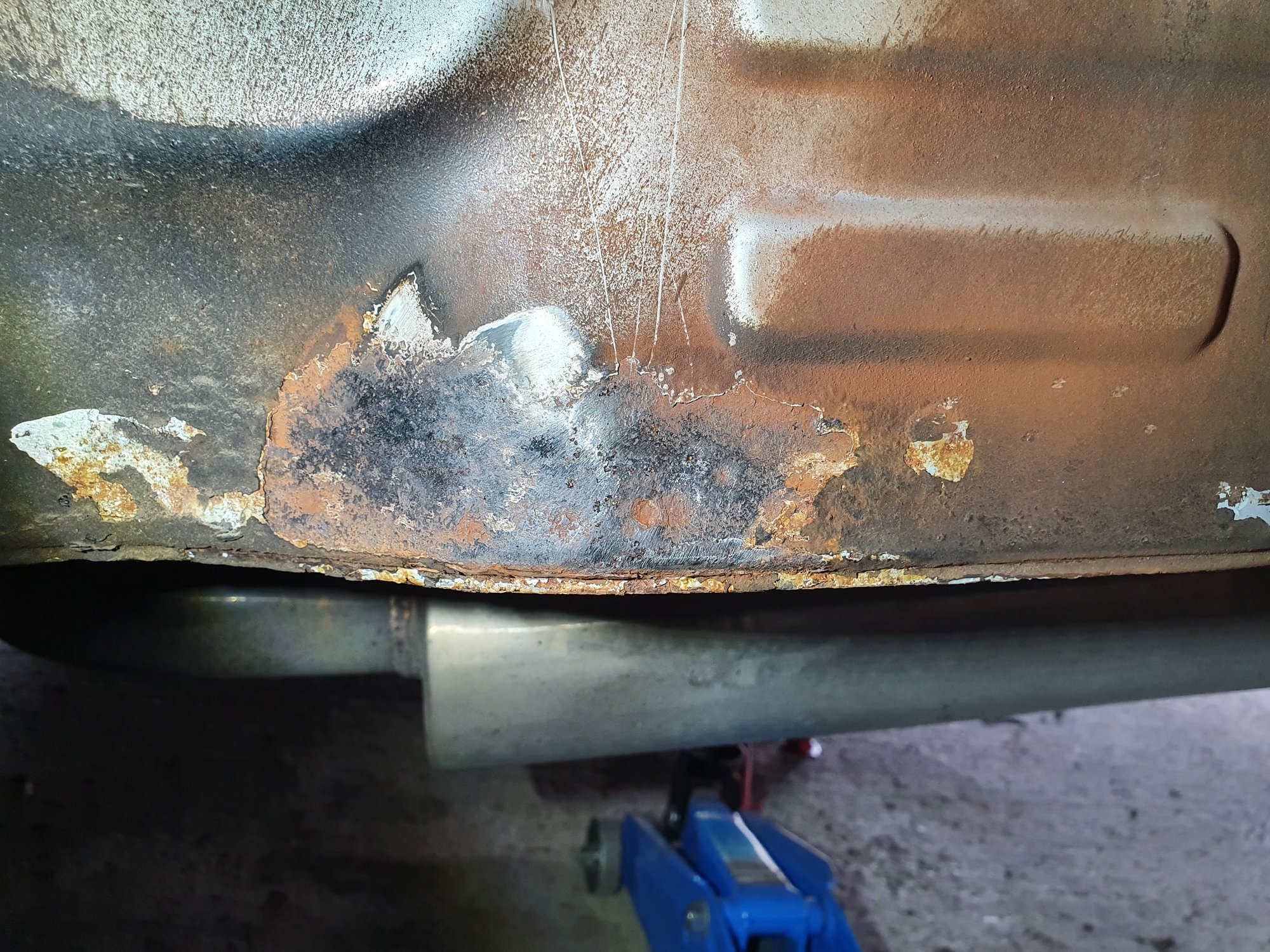

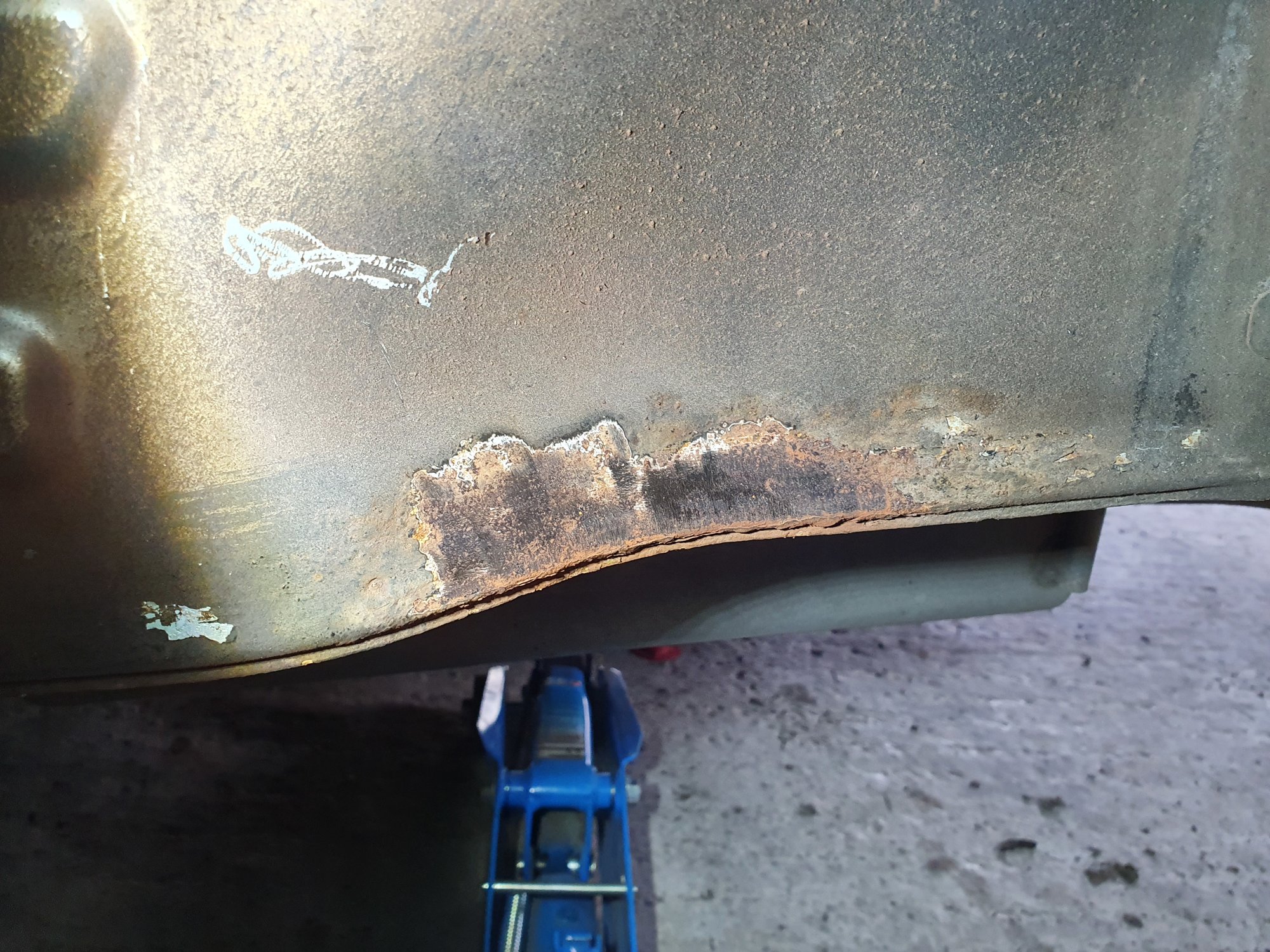

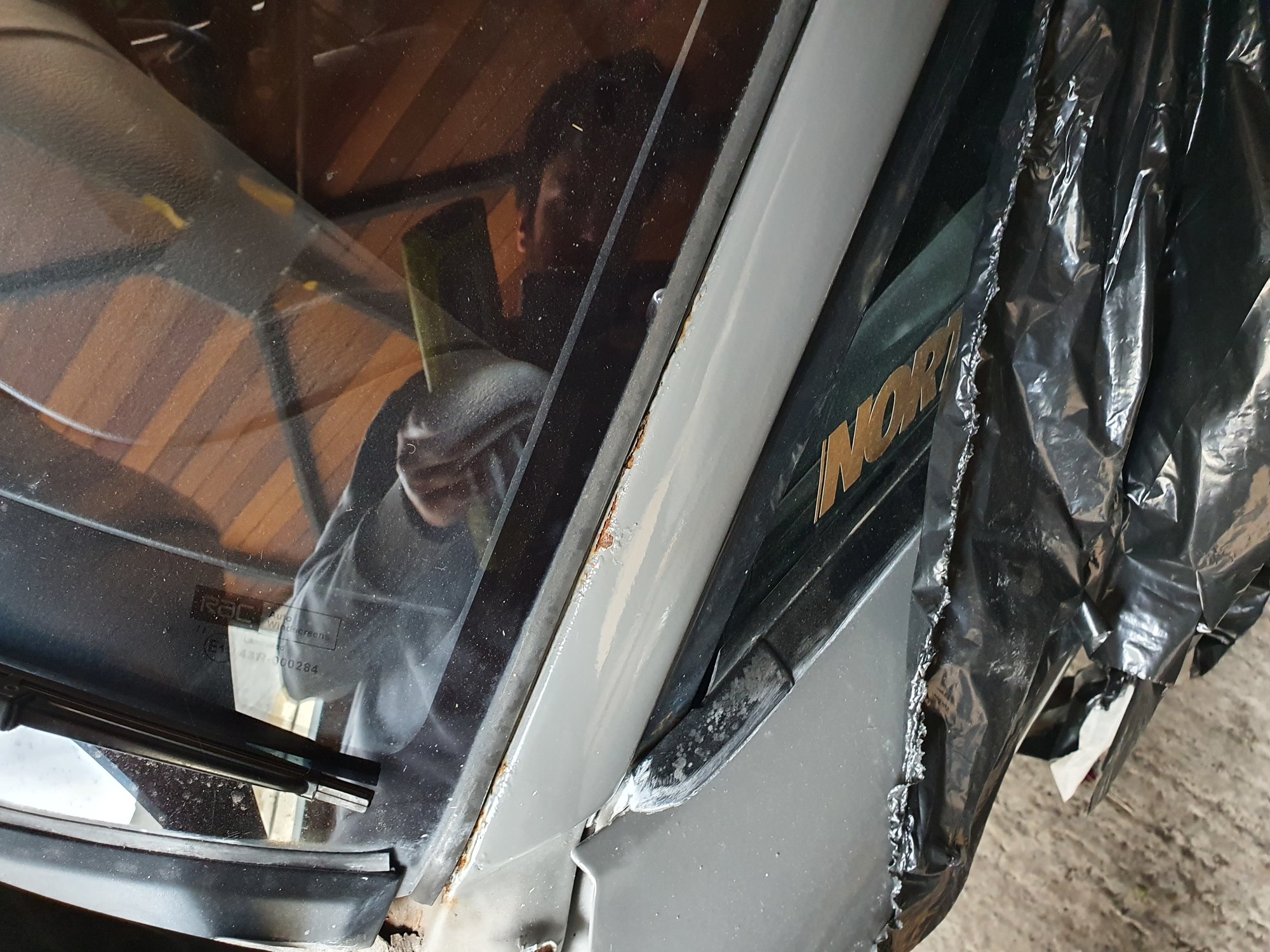

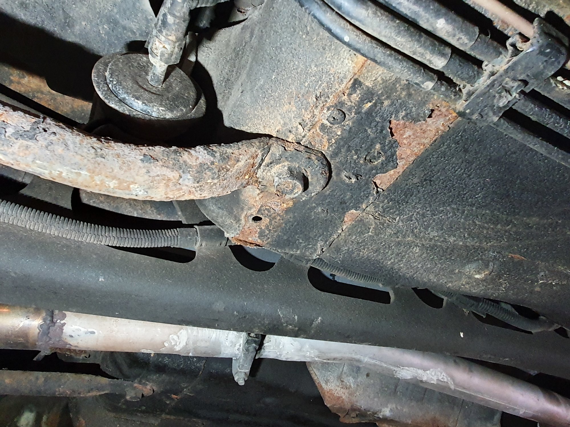

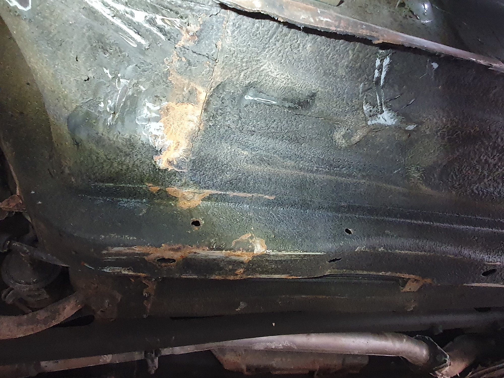

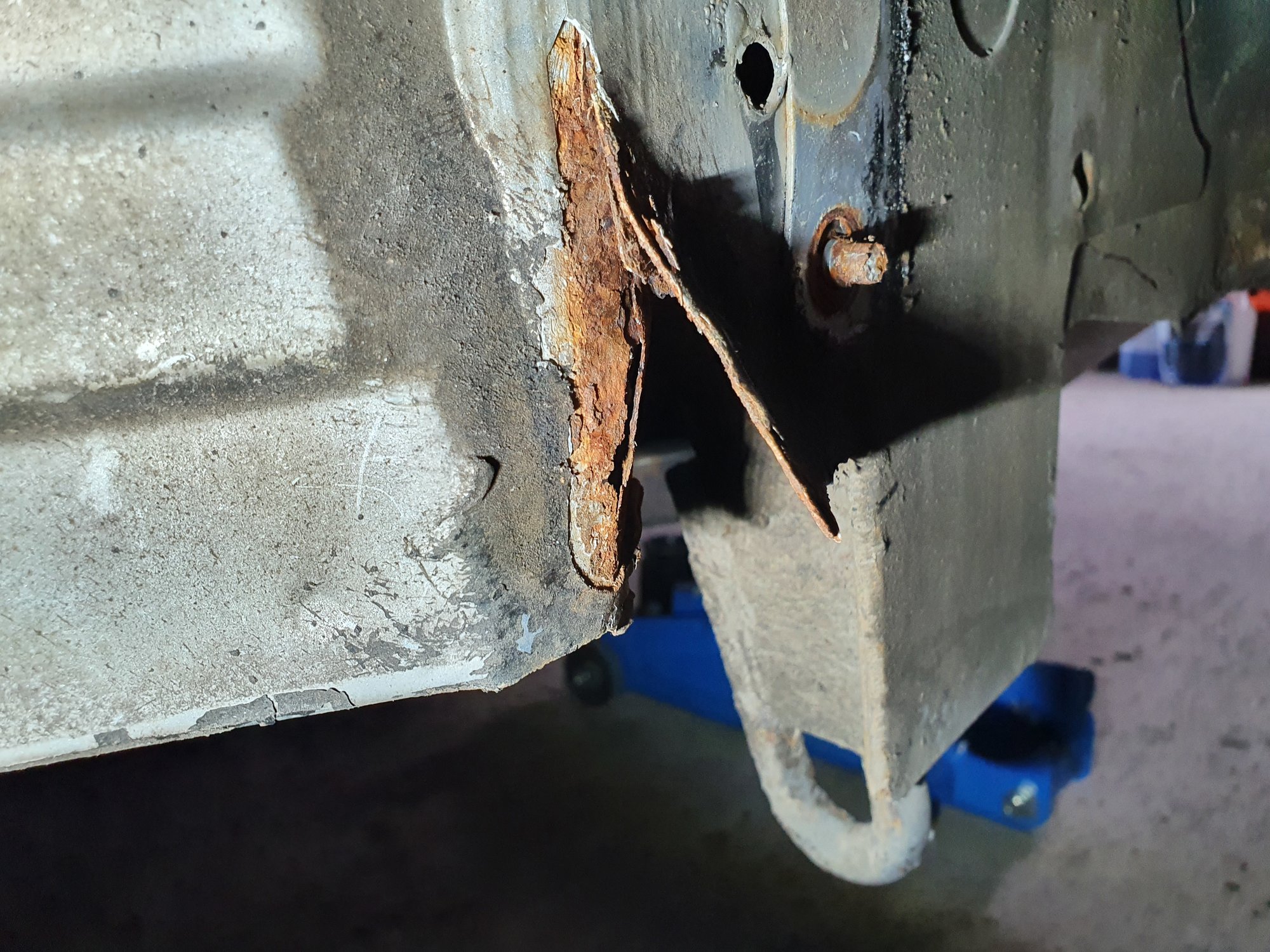

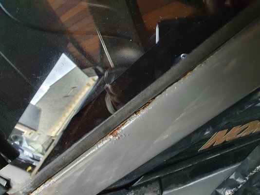

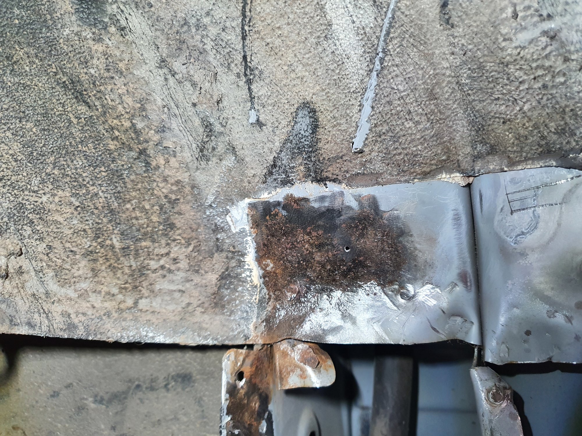

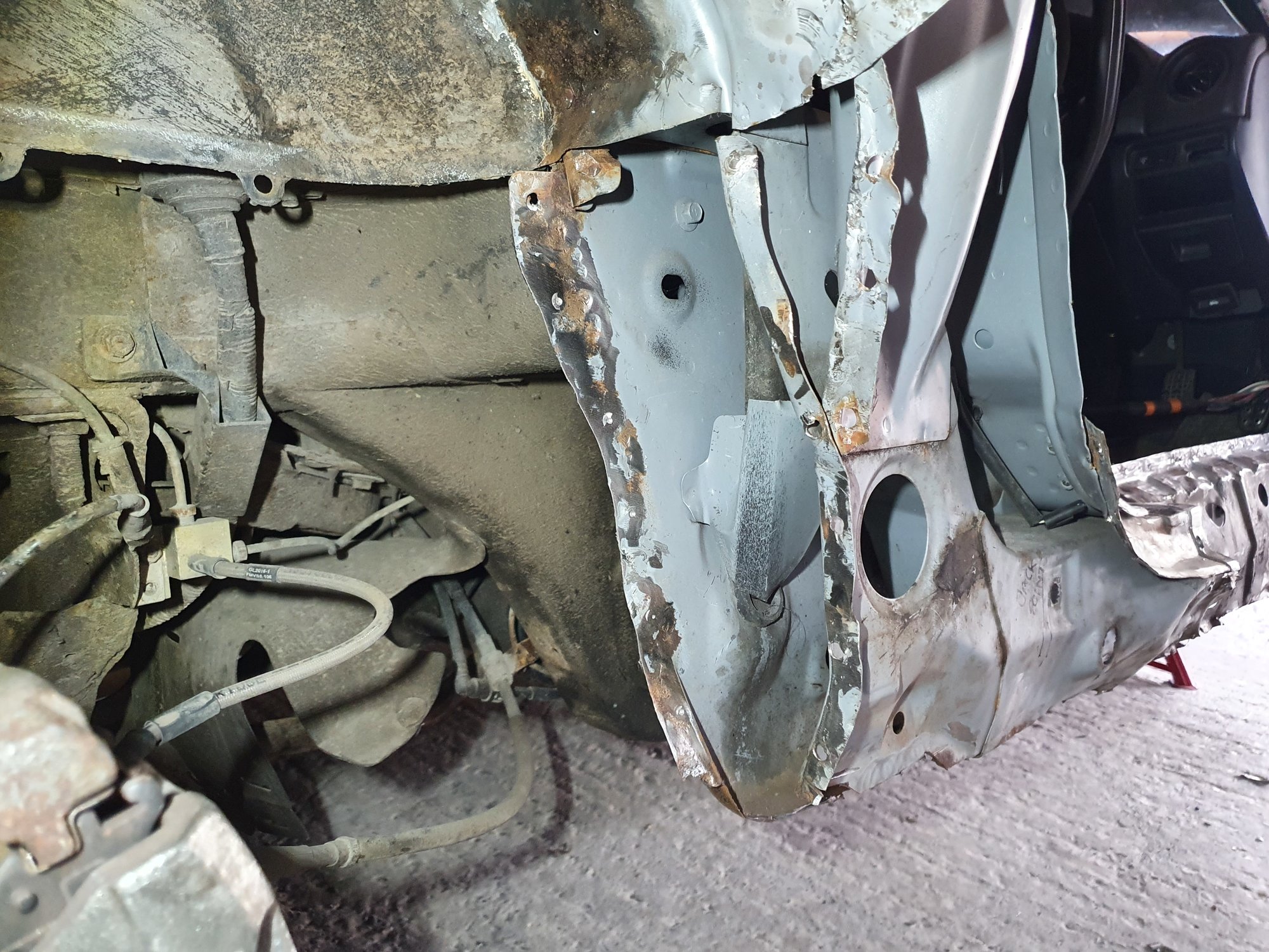

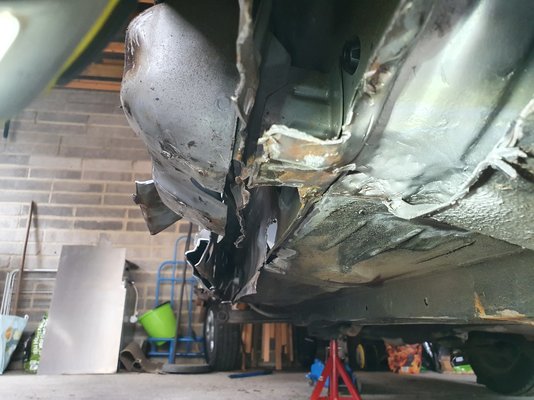

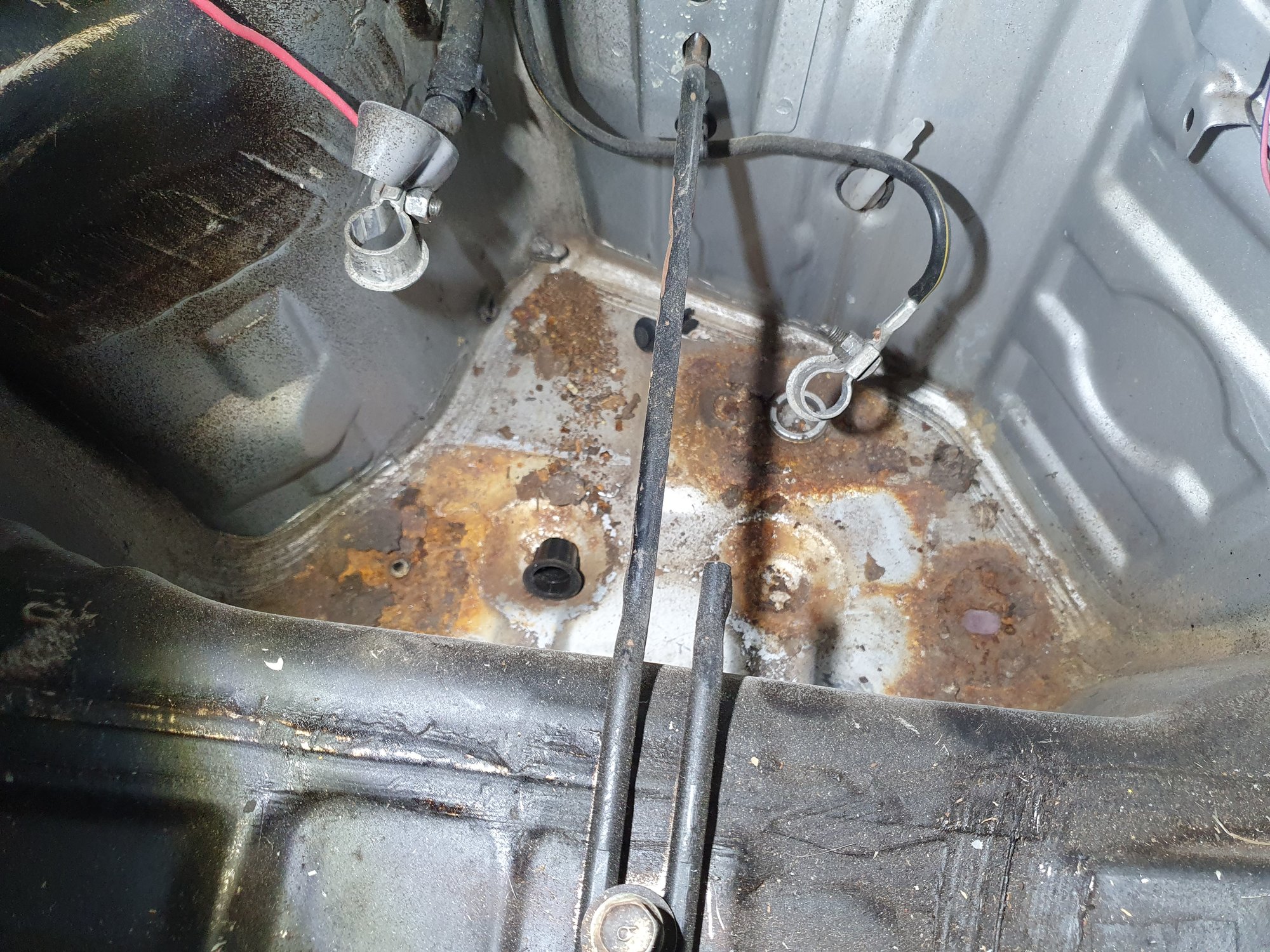

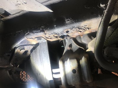

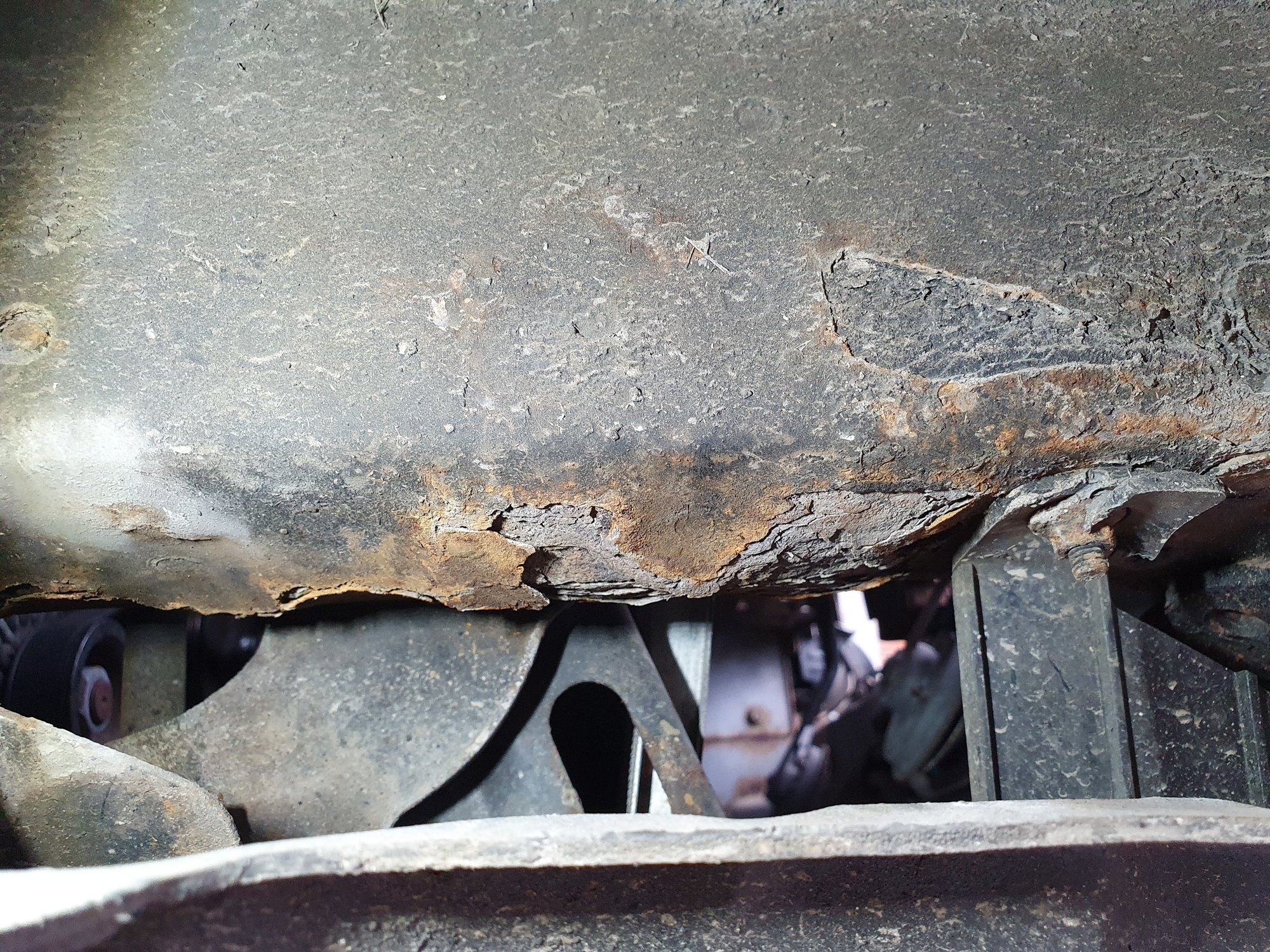

    I took a few photos of the car this afternoon.
    Battery tray:
    NS A pillar:
    Front chassis rails:
    Underside:

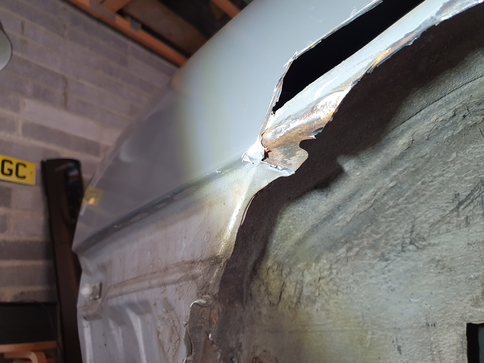

    OS rear quarter/inner arch/sill:
    Rear end panel:
    So a fair bit of work! Plus the very rusty subframe and suspension arms that'll need to be cleaned up and re-coated or replaced, lots of very tired suspension bushes and a few oil leaks. Despite this, it passed it's MOT last August with no advisories!

    I have thought about doing this as the amount of work needed would probably justify it and there's a lot of welding that would be needed on the underside which I'm dreading! I'll have to weigh up my options and see if it's worth carrying on with but at the very least it'll take me a very long time to finish, especially given my limited experience doing rust repairs!

  11. rtcosic
    rtcosic Member
    All entirely OEM factory fit rust.
    Nothing unusual there at all.
    They all do that sir.
    Patronising phrase of choice here.
    Seriously that is fairly average.
    Nick DV and stuvy like this.

    My son bought a mk2 for the turbo kit that was on it, the plan was to repair it & sell it on after, keeping the turbo. The front chassis member was rotten & we repaired that, I then started looking at the rear wheel arch & rear sill. When looking at it I gave it a tug & it all came away in my hand, at this point we decided it was too far gone, saved the bits we wanted & called the scrap man. Luckily my son bought it at the right price, got some good bits off it & sold enough that he didn’t loose on the deal. I suppose it could have been repaired, but we weren’t happy about it & felt the safest thing was to take it off the road. Between us we’ve had 5 mk1’s but I’ve never seen anything rot like this mk2

    Yeah I've seen many a thread about rusty MX5s and so I know this isn't a rare thing unfortunately. Its a shame really as I can't imagine many people willing to spend the money to get them all sorted and with the MK2 being less desirable than the MK1 I guess many of them would be scrapped!
    I think my concern is that there's so much rust that has eaten into the structure of the car that I'm wondering how safe it would be to repair. And I haven't started digging into the nearside sill/arch yet, so to be safe I'm expecting that side to be just as bad, if not worse! I might cut a small section out of the back end of the sill/lower arch and see what that looks like inside.

    Have a look at the MX5 restorer’s web site, they do repair panels for the rear sill area.
    These people do repair panels as well, never used them, so can’t comment, but have used the MX5 restorers chassis leg panel & that was good quality & they have instructions on the best way to do it as well.

    I'd hit that with a screwdriver, at this point you might as well probe away !

    Didn't look too bad to me.....bit of rust but not real rot. The main difference between rot and rust....with rust you cut it out with a grinder....rot you use a broom.
    I mainly do Jap cars so to me it doesn't look that bad. Next car will be done on a rollover jig.....they can be had for a couple of hundred on ebay and allows you to rotate the car 90 degrees....bolts to the axles.
