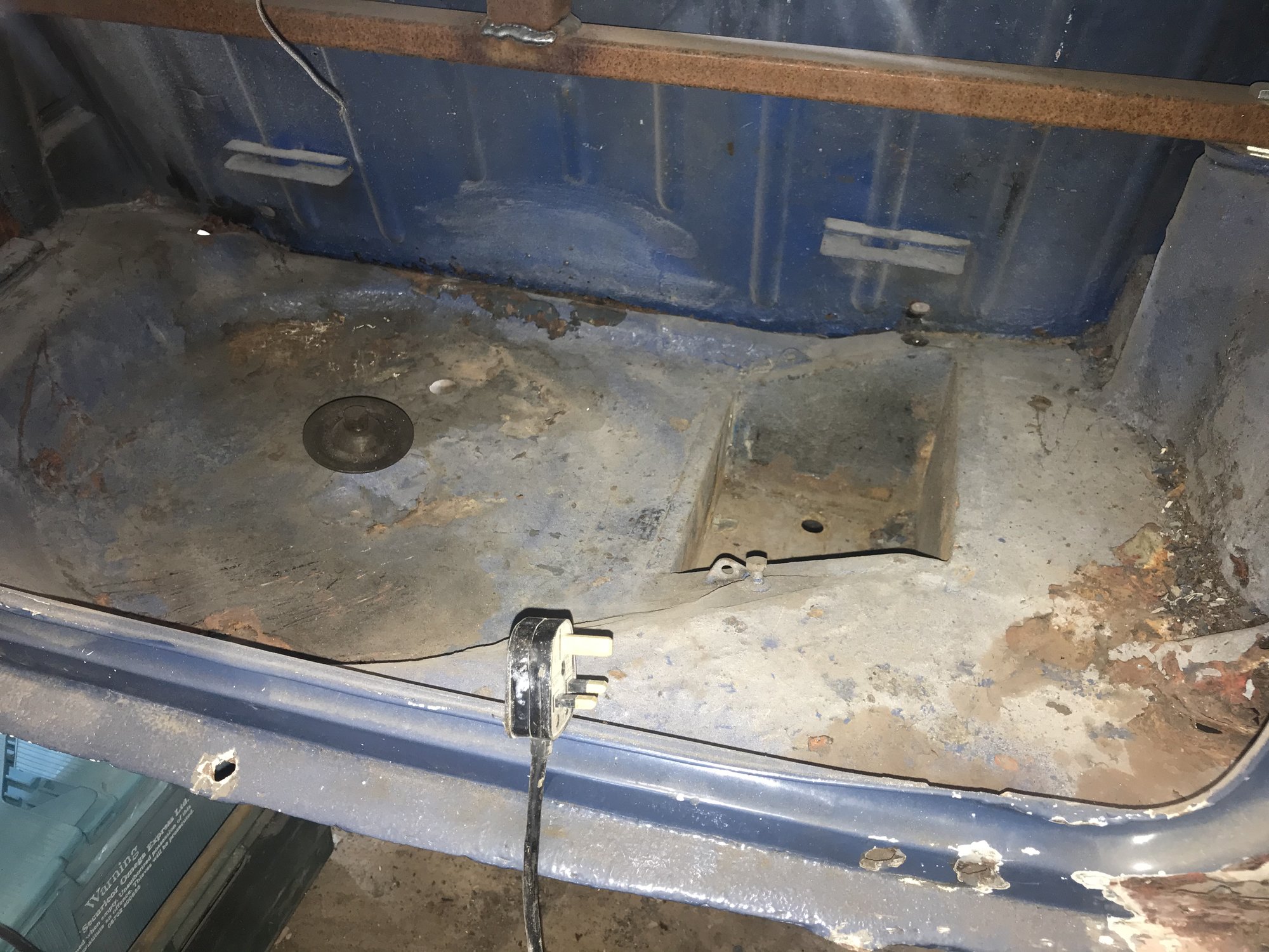

Put up a picture of the battery box and the rear subframe … our mini was a net of rust in that area … skillfully disguised by well painted glued on thin card that was given a coating of spray on underseal on the outside , sprinkled with sand & dust etc on the inside .. it's a wonder the battery didn't fall though in the second month we'd had it as it was the first time we'd taken it out when it was chucking it down with rain .
