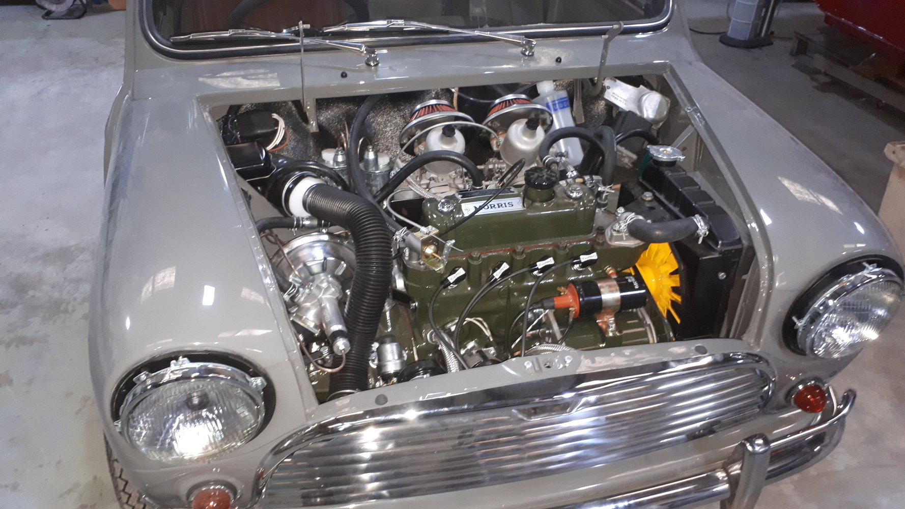

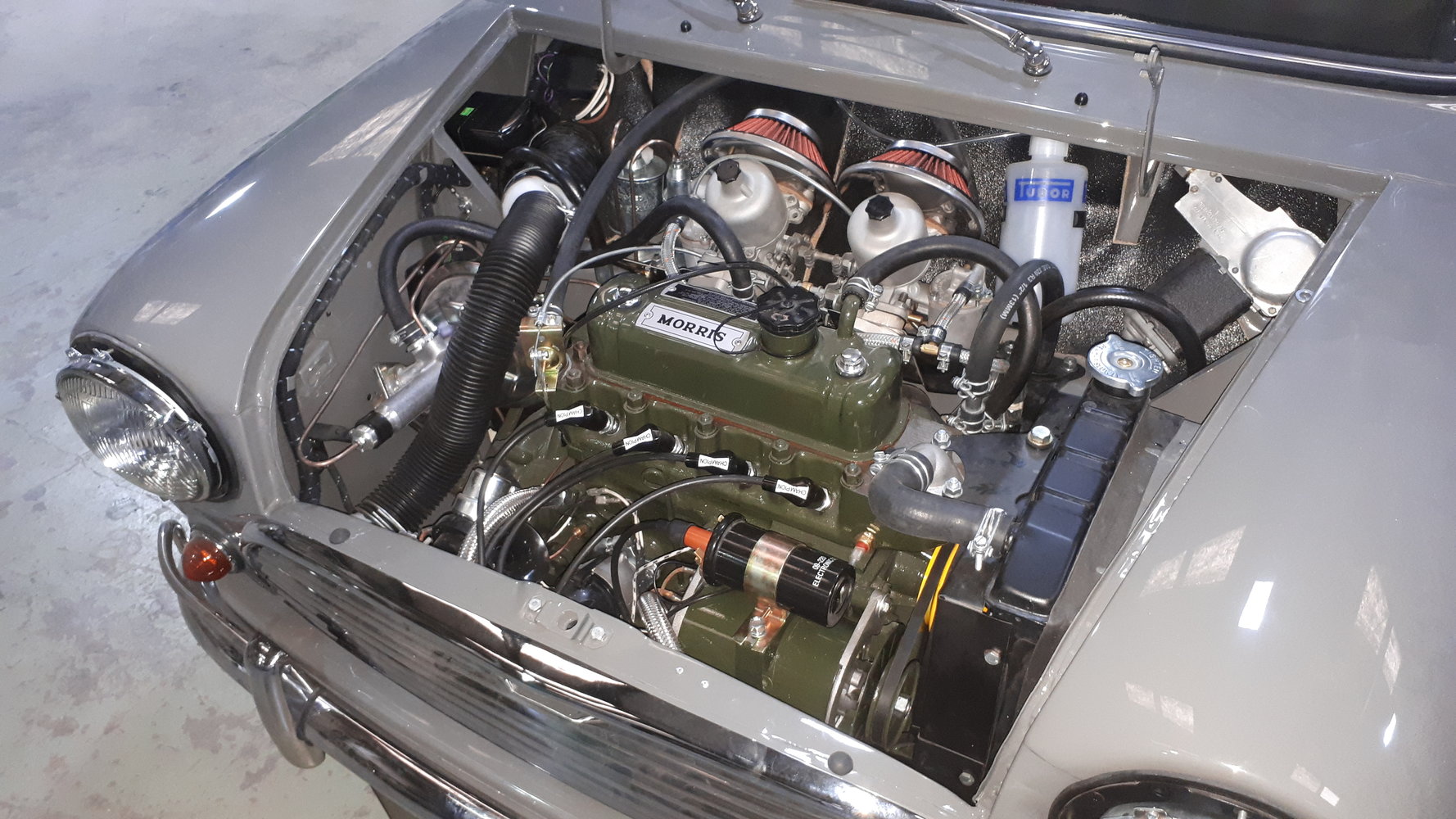

Please carry on posting your work.I love to see it!

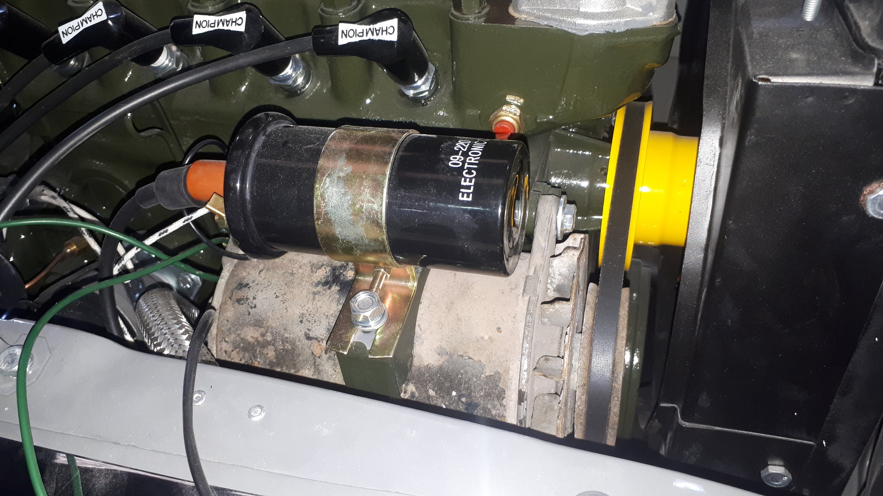

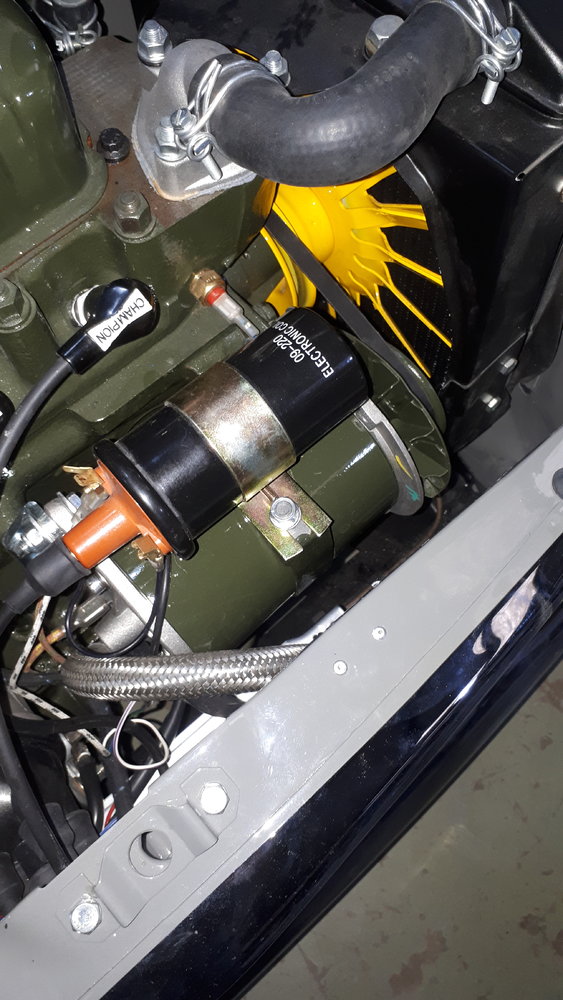

Well maintained points are fine for show/weekend cars. The problem is few people know how to maintain them now so they become an issue for non starting and breakdowns.I know it's not original but they do need it![]()
They never did with my Mini Van back in the day,yeah puddles become a bit of an issue aswell![]()
Points and condenser for me, sorry..
I'm a time served electronics guy, and while I see the advantages, sometimes the environment you put these things in just gives you grief.
