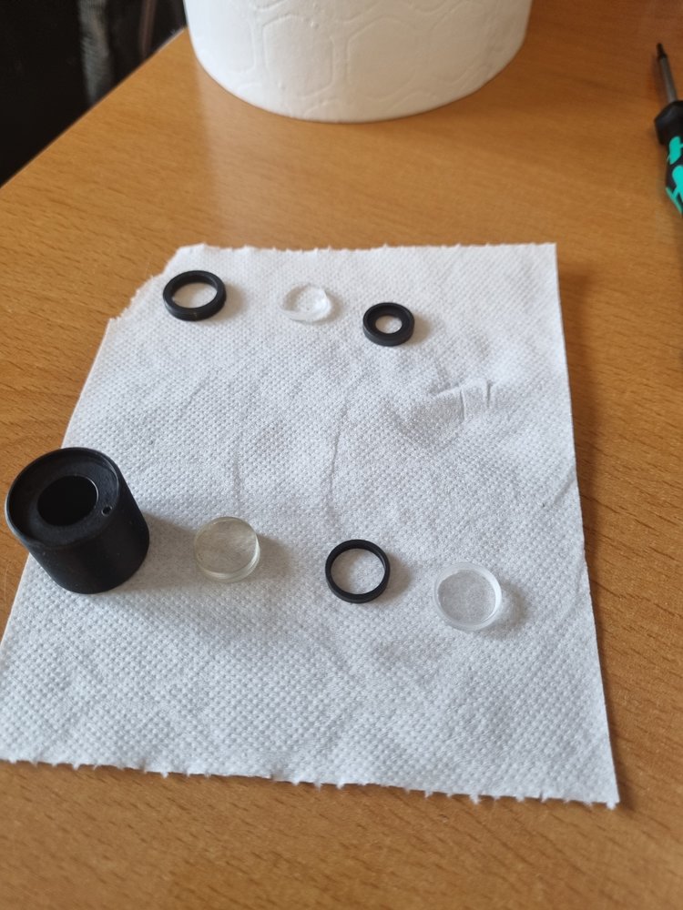

I’d drop the lenses into a specialist with a clean roomIf anyone's wondering what I'm gonna do with it, here's one example;

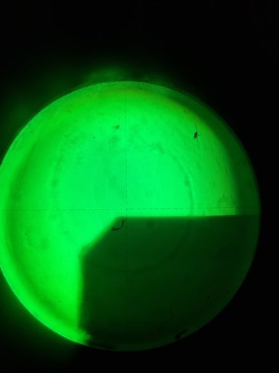

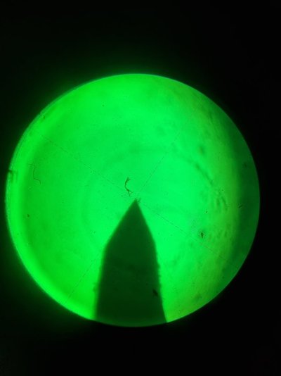

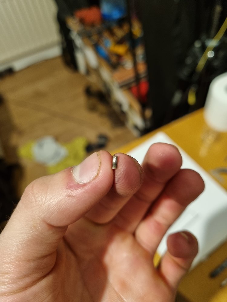

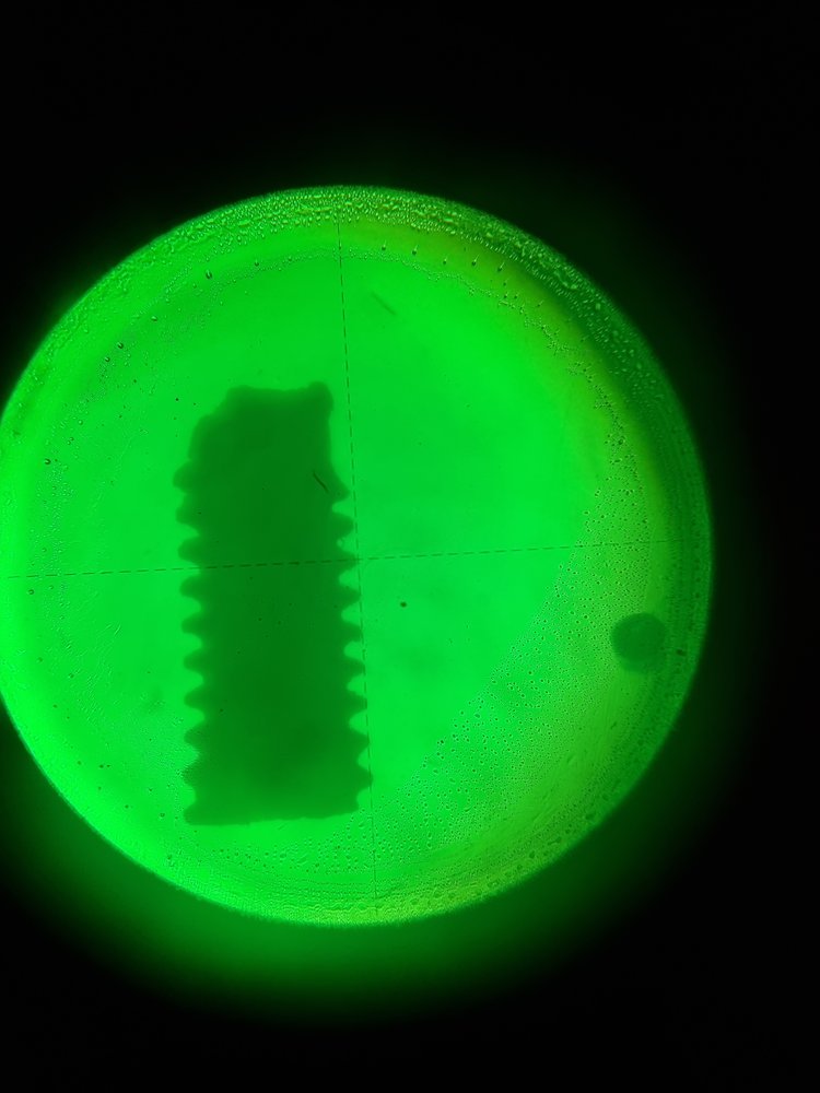

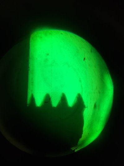

I managed to wind out the sheared off part of the vernier lock and need to measure the thread.

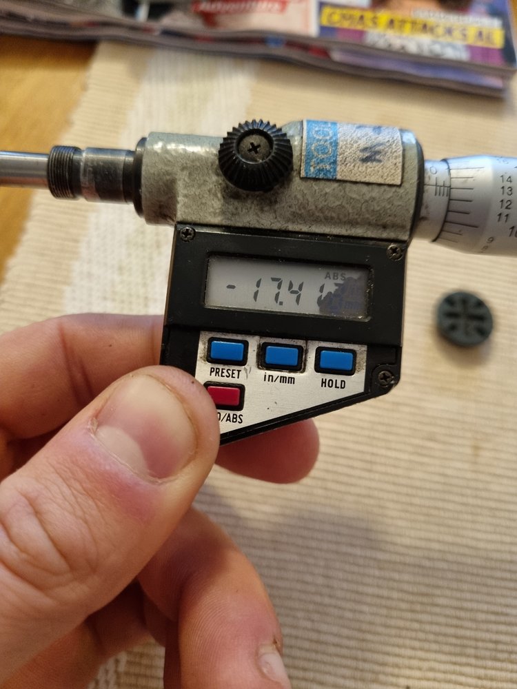

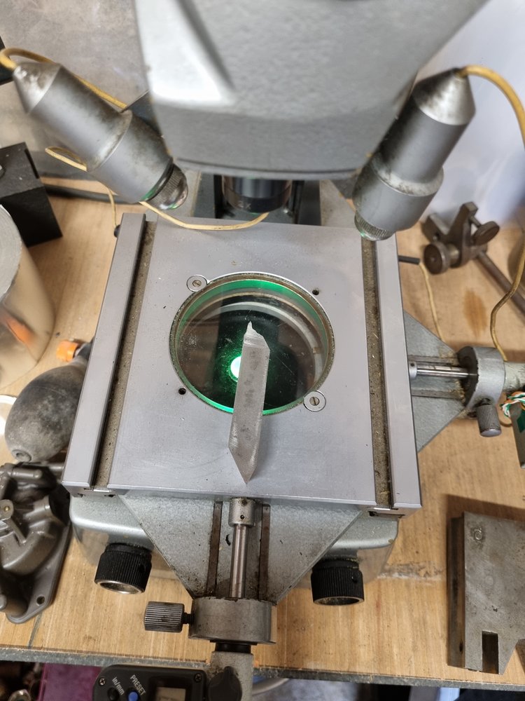

Line it up, zero the mikes and measure the pitch and diameter quicker than you could even find a thread gauge. View attachment 286022
You could even measure the root angle if the angle vernier worked. It's M2x0.4
Notice how grimy the reticle still is.
