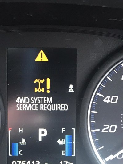

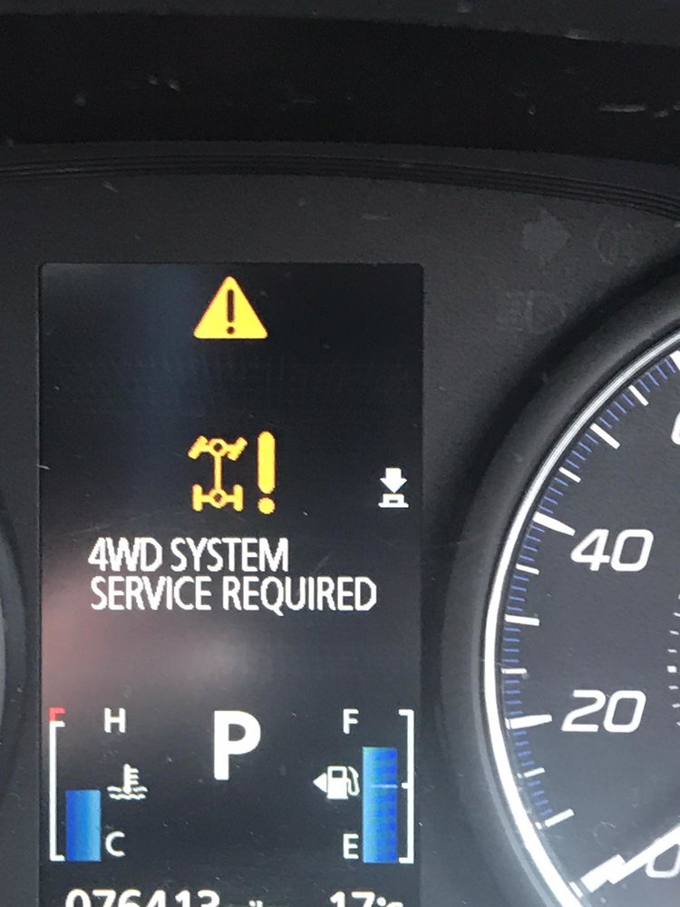

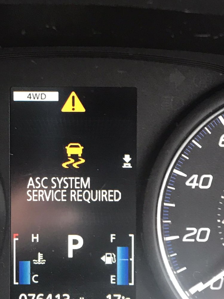

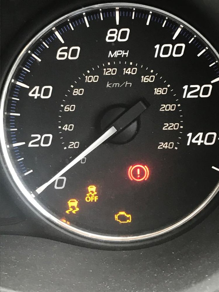

My wife called the other day saying the dash on the car has lit up like a Christmas tree with various messages. It's a 2015 Mitsubishi Outlander 2.2 diesel with 76000 miles on the clock.
Here they are!
I've plugged in my OBD2 reader but only got this code P0089,
much Googling points towards a suction control valve on the fuel pump being a common failure so I have ordered one just to rule that out and fitted a new fuel filter (fuel looked clean) I'm not sure why a fueling issue would cause a problem with the ASC & 4x4 systems though, any thoughts?
I've checked the abs sensors with a multi meter and they all measure 3.7 megaohms between the pins and infinity to ground, I also had the live data up while driving and all wheels are measuring the same speeds so I THINK they are all ok.
Does anybody have experience with these cars or code readers?
She's meant to be driving to Southend on Friday and has been using my Surf for the school run GRRRR
If I had hair I'd be pulling it out by now!
Thanks
