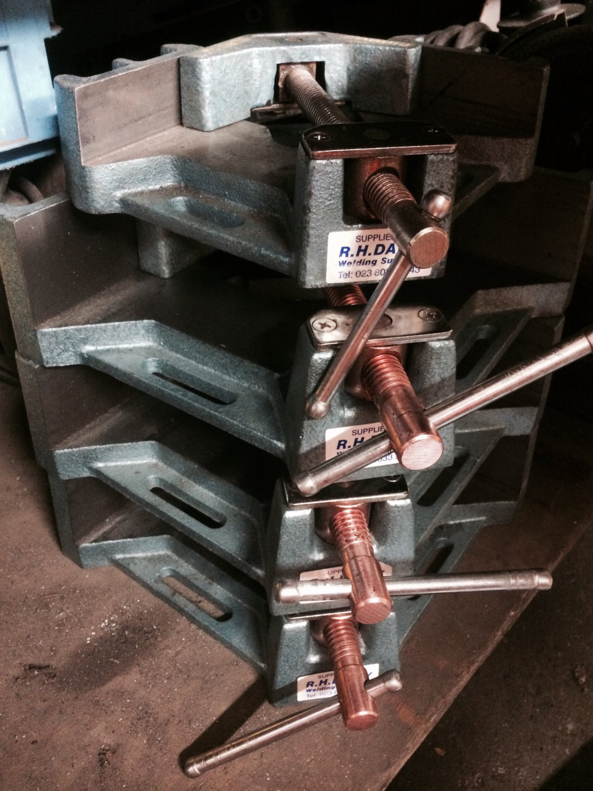

I've got a couple of the woodworking type, but I never use them, mostly because they are generally too small. If its a one off I just clamp the pieces to my bench check for square, tack, check again then either adjust or weld it up. If i'm doing more than one I weld some scrap to the bench to make a jig similar to Richards.
