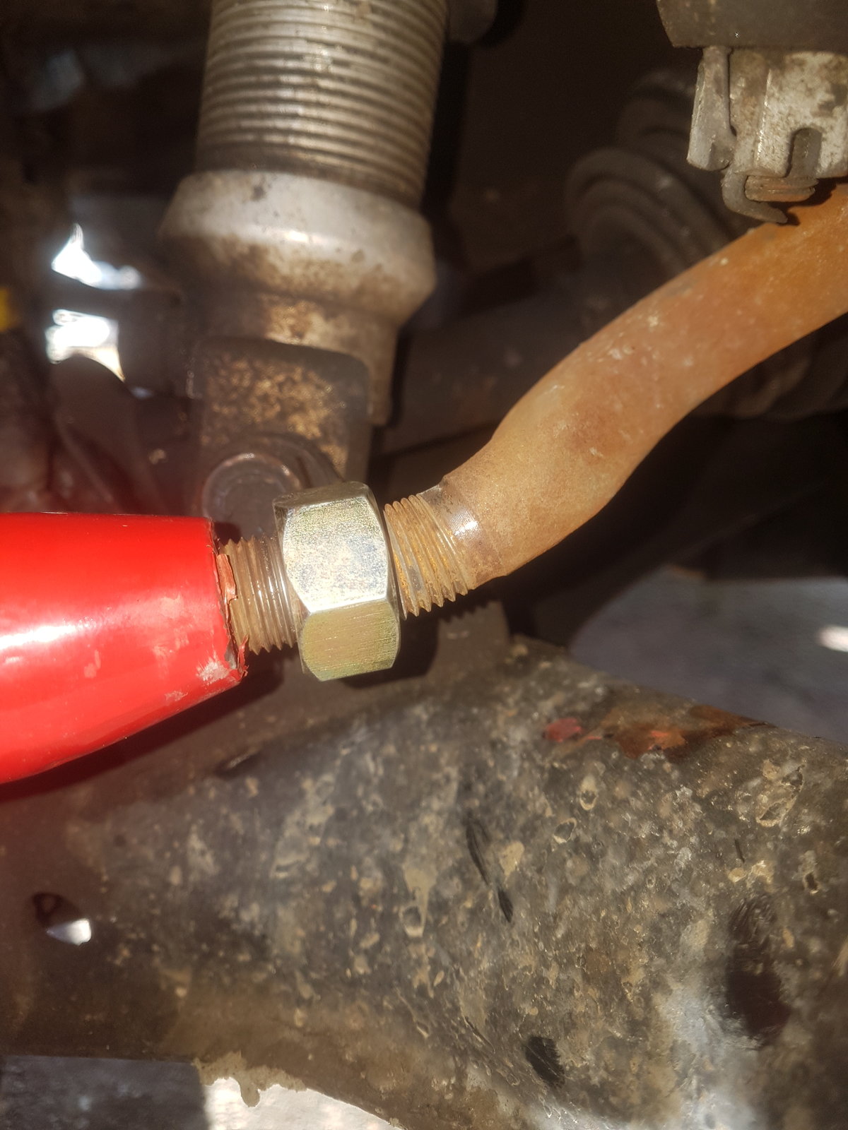

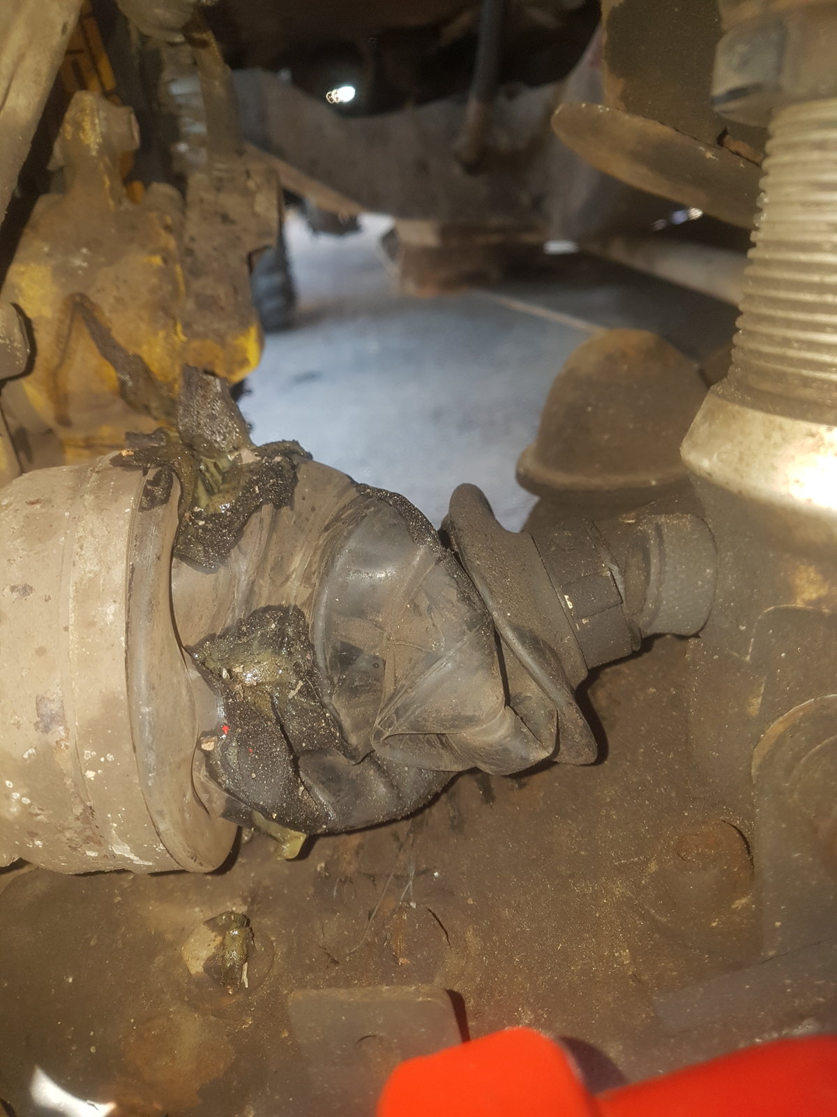

they are going to vary the angle by quite a bit the front end has about 15cm of travel, maybe these are not the best things for the job, they are better suited to a stiff track car

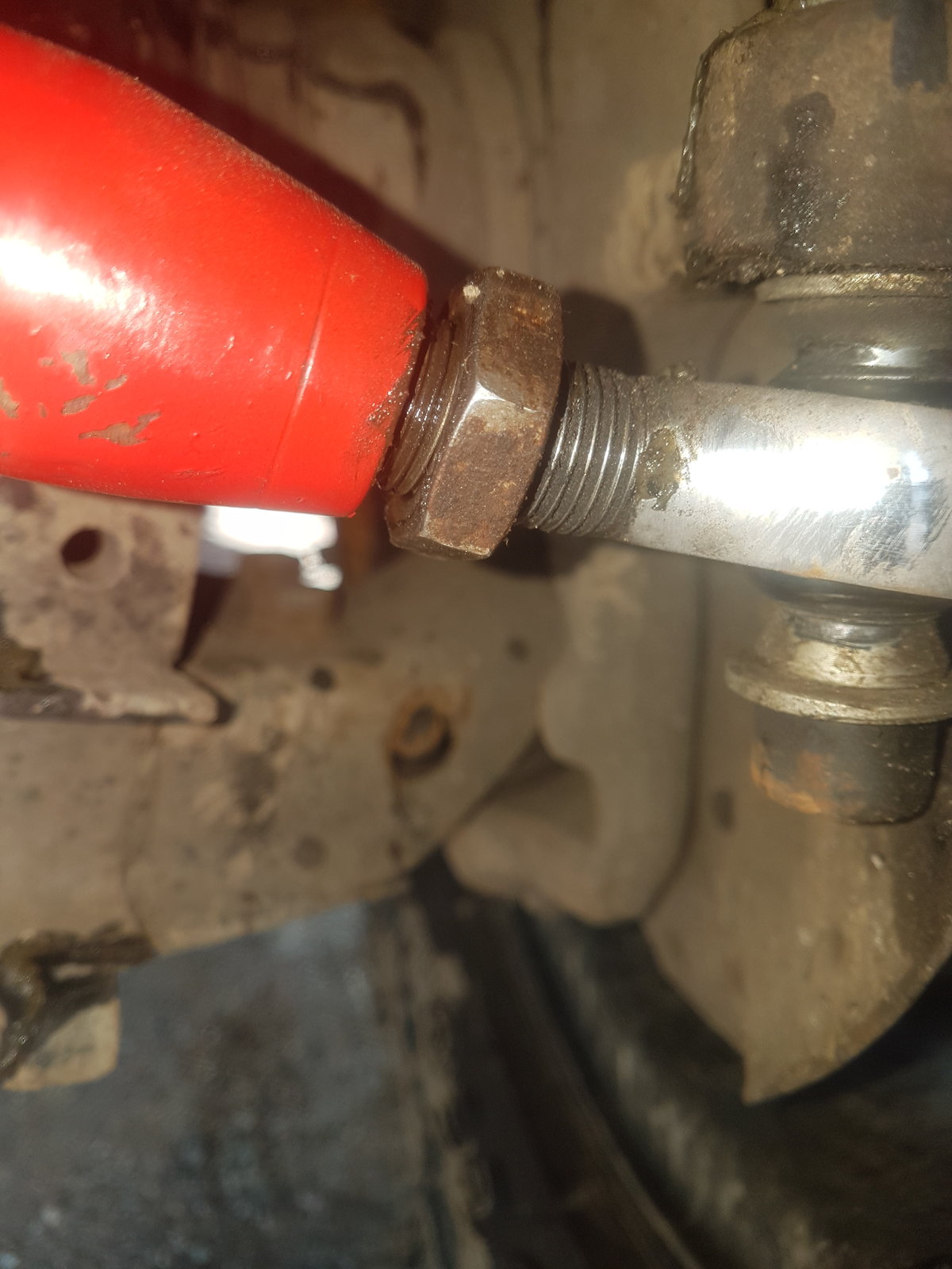

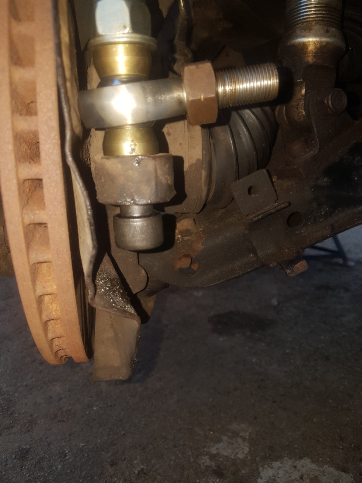

I meant the faces of the spacers inside the joint. If you measure the joint width and the step on each spacer I’m fairly sure there will be a clearance and they do not touch each other as the spacers would have to be machined/ground to very close tolerances. I’m wondering if either the bolt compression is causing the relatively small lips to crush and fail or the spacers are tipping when the angle is exceeded.
I have tried that mate I drilled the tapered fitting out from m12 to m16 but the m16 spacers didn't offer as much movement as the m12 reducers.I was trying to think how to machine a pair of top hat spacers that touch inside the spherical rod end and tighten down on the outer faces, not an easy job unless you use a crush washer or leave a clearance and rely on the spacer lips compressing slightly when tightened. Maybe going up in size or two with the rod end would be a solution using the same bolt size.
I was thinking reducers and a even bigger joint with the same size bolt.
