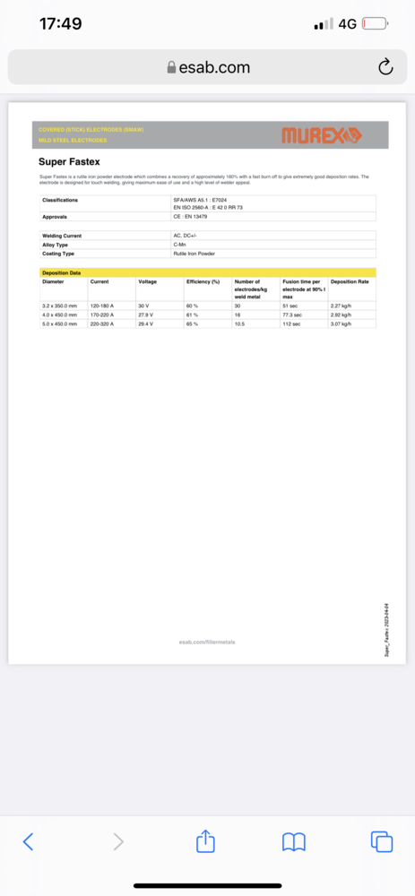

what breed/size inverter probably ould be usefull to the opAs Matt said, stick is the way to go if you're outside, way cheaper too.
Might be worth looking at the power supply, I ended up with about 50m of extension leads running a brilliant little inverter stick machine. My previous mig an old transformer machine couldn't cope & most of what I did was 4 - 6mm with occasional 8.
I'd been reluctant to go stick as previous experience with an old buzz box had not been great but the inverter made the whole thing a pleasure.
