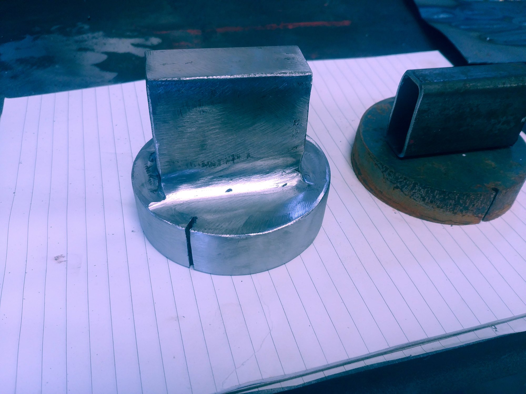

I often get round bits of steel plate about 1" thick that have been water cut, Most are 3"-4" diameter and a while back i made one into a vice mounted mini anvil but welding a bit of heavy gauge box section on, they work quite well for holding behind a panel to bash car metal, They have a small slot in the side where the water cutter starts so i cut them deeper to put metal in to bend it at 90 degrees.
