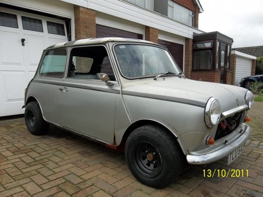

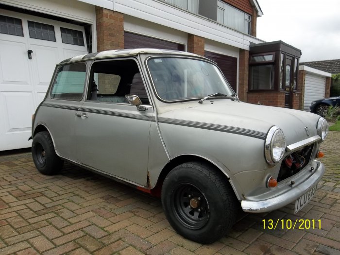

Bought a classic Mini (1977) last year in a fit of nostalgia. It looked asthough a quick polish maybe a bit of paint and it’d be on the road.

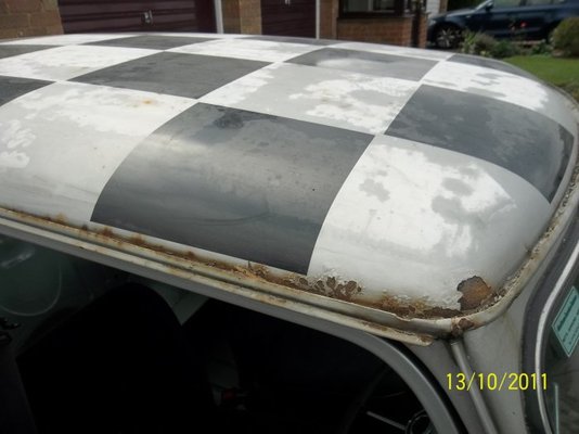

Removed the carpet and found lots of damp, bit of rust but hey ho it’s a mini. Replaced widow and door seals and found ........yep more rust. Bit concerned about the rust in the roof gutters, decided to start there and keep it restrained so I could use the car.
By Xmas the roof was stripped of paint and primed despite the lack of space. Did I mention restraint......

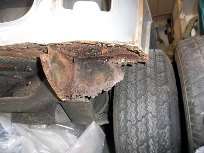

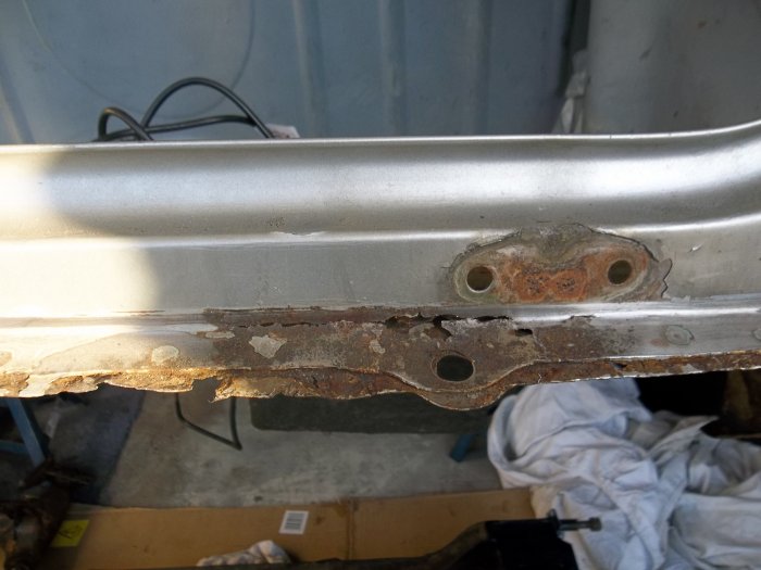

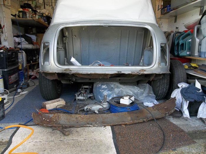

Rear valance was rotten and that’s where my plans started changing. By Christmas the rear subframe , all glass, seats etc stripped. I knew the A panels and bits of wing need replacing then discovered the boot was a bit religious (holy)...

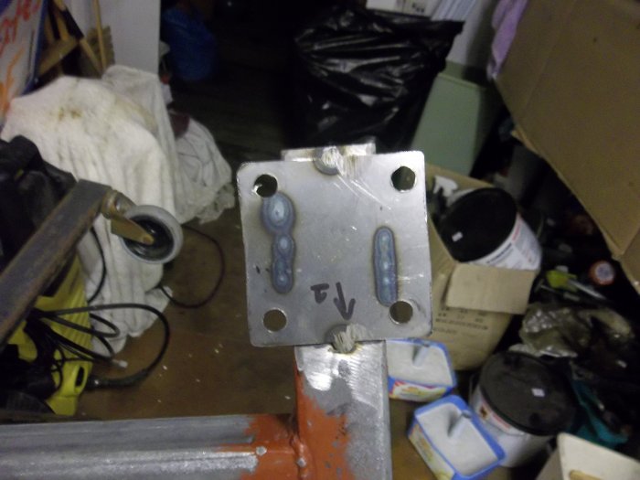

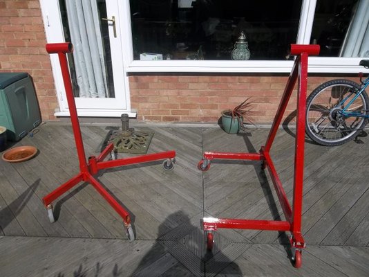

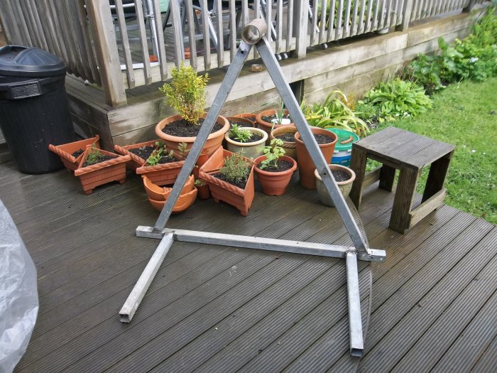

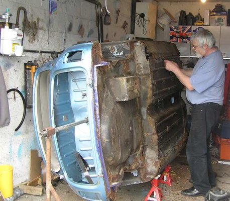

Another change of plan. Didn’t fancy welding upside down in a tight spot under a precariously balanced Mini. Rotisserie is the way to go. Bought a Migtronic Rally 166 (after reading reviews) off ebay and some box section from a scrappy...

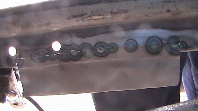

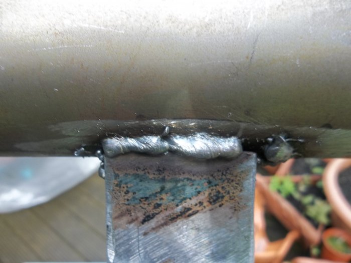

Pleased with some welds, others rubbish and had to grind off. Learnt a few lessons eg don’t guess where you are welding, you’ll get it wrong. And turn your work so you are comfortable.
Welded on some pates for the castors, just needs painting.
At the same scrappy found a TV/video stand on castors, built for a 90s telly so very robust. Bit of scaffold pole and that’s the other end sorted.
Now need to get the car out of the garage to remove the front sub frame, engine etc but got no wheels on the back! I was concerned that supporting the back end on a trolley of some sort would do some serious damage until I’ve welded the boot floor.
I posted some practice bits in Learning Mig welding and am following the advice.

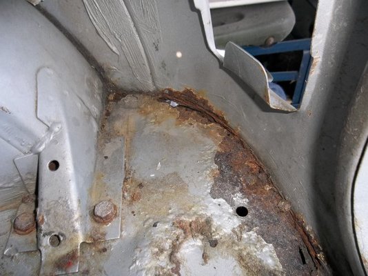

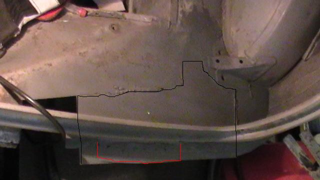

Last weekend I started cutting..

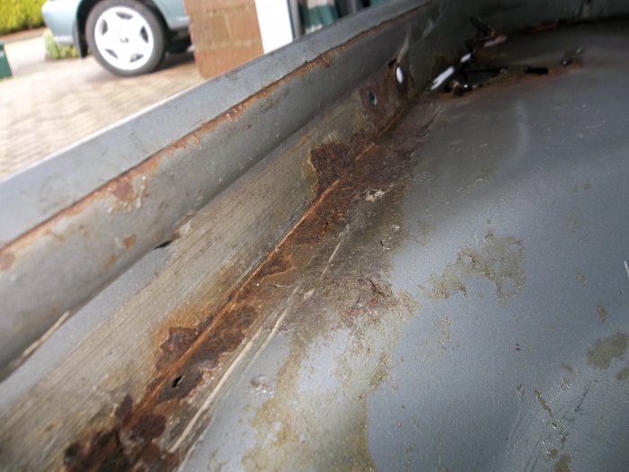

This is looking into the right side of the boot, battery box at the top, hinge panel at the bottom and hole where the right side floor was.
Here I did show restraint. The whole rear end of the boot floor needs replacing, along with bits of the hinge panel. Concerned that if i cut too much without bracing the I’ll lose the geometry for the subframe mounts. How do you cut straight lines? I’m using a 1mm cutting disc on an angle grinder but can’t seem to go straight. I’ve had to cut back to the marked line with a grinding disc.

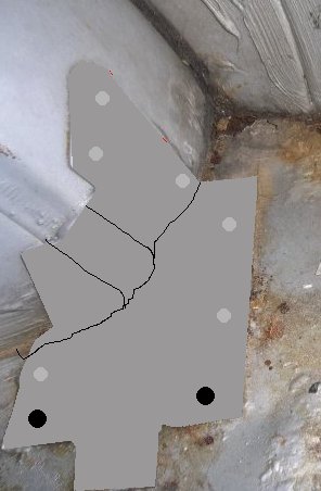

Started cutting patterns with cardboard.

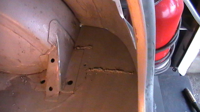

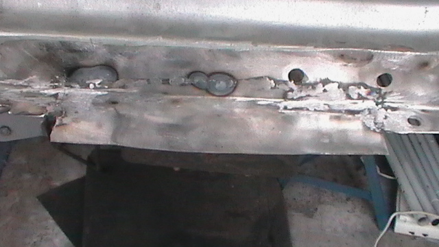

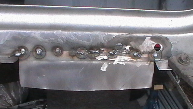

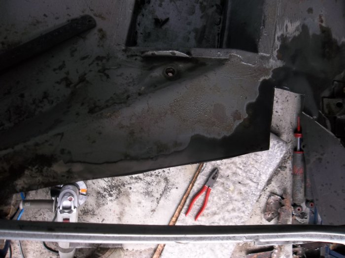

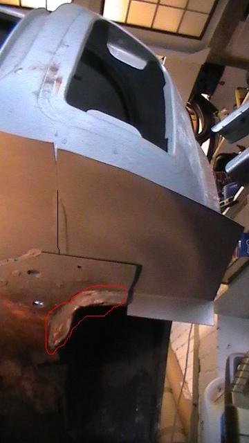

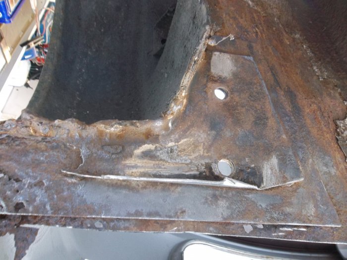

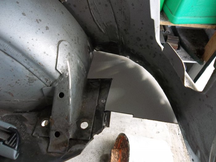

that will be really nice when you've finished and you will have the satisfaction of knowing you've done it all yourself. Hope all goes well as you progress.

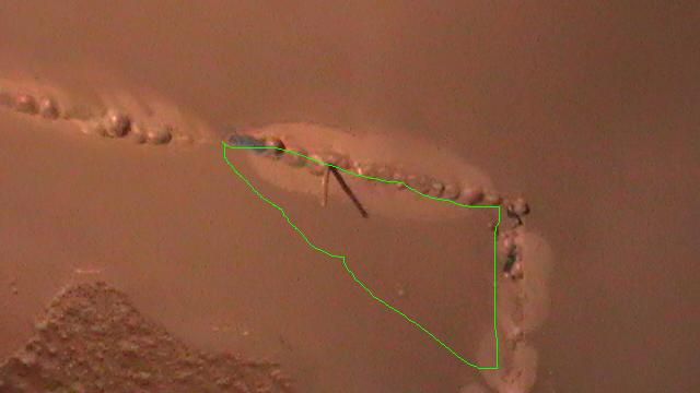

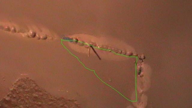

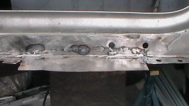

- I tend to nudge the power & wire speed of the mig up when attempting a 'tack' or 'spot'. You will need to refine your technique before moving onto the sills - plenty spots required there
- either way, the repair to that area looks OK. If there are any blow-holes that need fixing: gather together some 'heatsink' (Copper/Brass block), and return over the area filling as required.

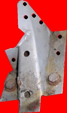

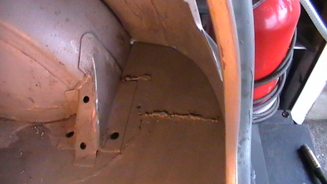

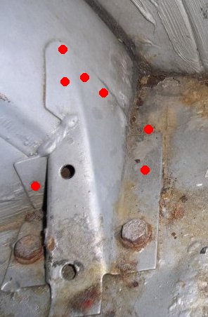

). I'm still thinking of removing the subframe reinforcing bracket thing but will end up with holes in the wheel arches, boot floor and other places where I'm not replacing panels.
