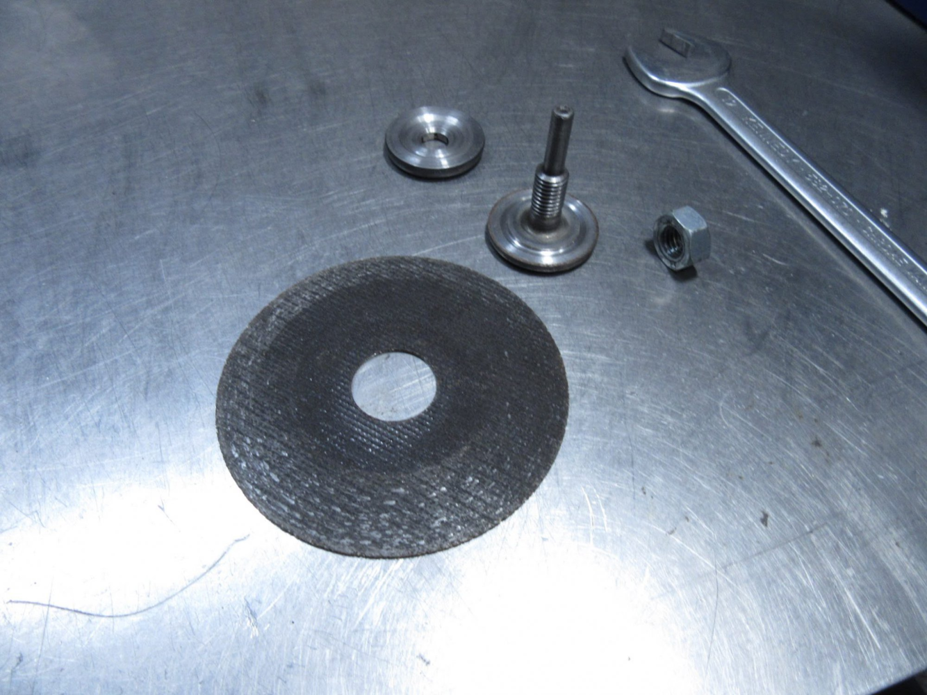

I watched a u-tube yesterday where a body repair shop has a small air grinder that uses worn down standard 4" grinder discs in a small pistol shaped air tool.
[I know old worn discs can shatter!]
Anybody know how you do this as the only adaptor I can find is a shaft to angle grinder so you can make a drill use grinder discs.
The reason to ask is 2" grinder consumables are expensive and you can obviously use old 4" stuff on a smaller setup letting you clean up stuff in restricted areas.
I'm thinking a 2" air grinder with adaptor maybe but 'how to' is the question?

...........I've never, and I mean never had one explode in the many hundreds that have been used on it, and like you said is great for tight spots which I find myself in regularly whilst playing with bike frames. My experience of any "exploding" disc is normally down to operator error in selection or use of the appropriate abrasive disc. Ive not had one disintegrate, or any vibration issues either. Perhaps its the make but mine tend to suffer obvious cracking or damage from man handling in the tool draw where they live so end up straight in the bin.
