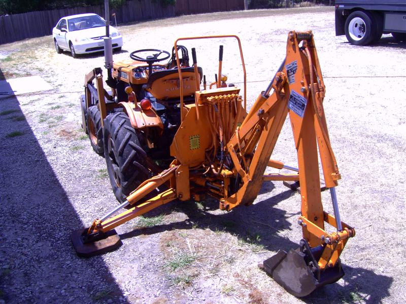

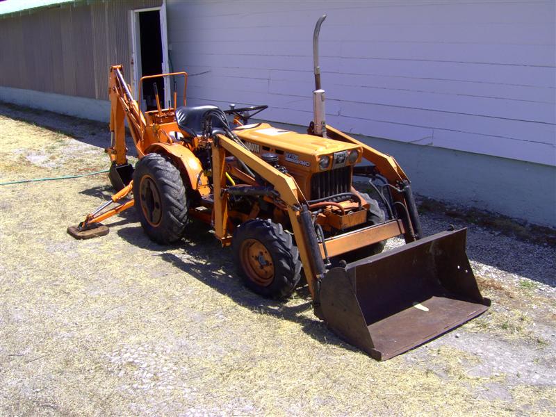

Over seas I had a lightly used Kubota 7100 series tractor with a quick detach backhoe, which served me well for over thirty years. It was the perfect size and a very useful type of machine for almost all our small ranch needs.Gents,

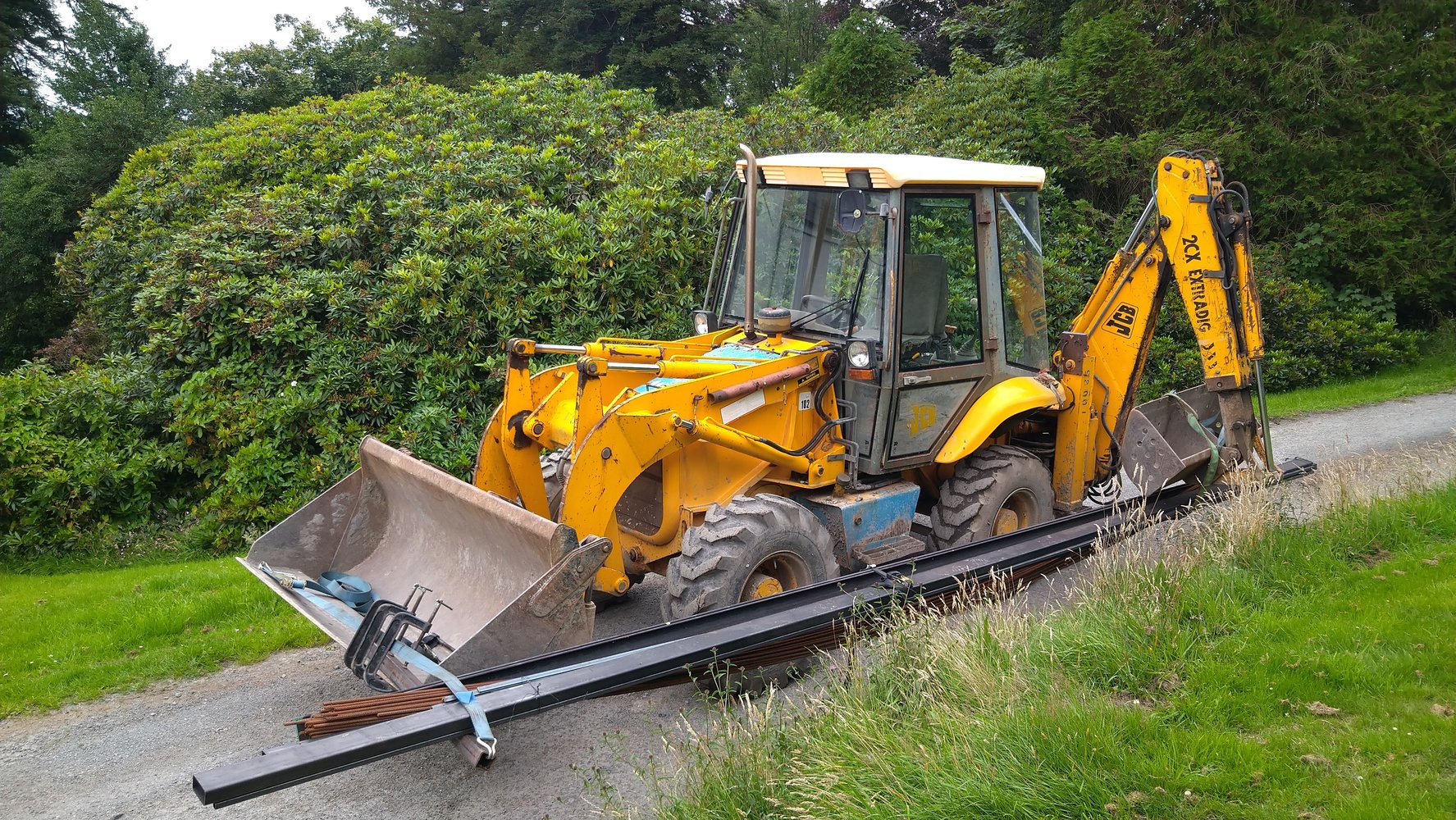

Was just called the 2CX and they did a variant called the StreetMaster (which I have) which was all the options ticked. Extradig, auxiliary hydraulics on the back actor and side (for hand tools). Hydraulic quick hitch on the front and 6 in 1 bucket.Didn’t they do the 2CX air master with a back hoe option? Or am I remembering it wrong? Happy to be wrong![]()

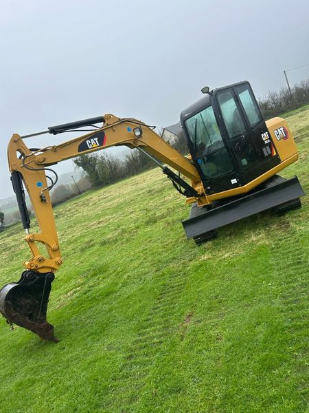

What do we think of this machine for a bit of ditching post driving and a bit of pad digging for sheds on a smallholding?
Airmaster was the one with a compressor, no backhoe though. Sitemaster had the backhoe.No
Out of that choice, mini excavator every time.
As above, go as big as funds allow then sell the excavator if it’s no longer needed then get a good tractor for land work. Not a compact one.
If you go down the JCB-Esque route, as above they do everything but none of it brilliantly, but look for extra dig.
There’s also the 2CX which is a smaller machine and possibly a bit more manoeuvreable for his place? They did a road crew 2CX with a pto compressor on it which might be a handy thing. Can’t remember what that model was called.
