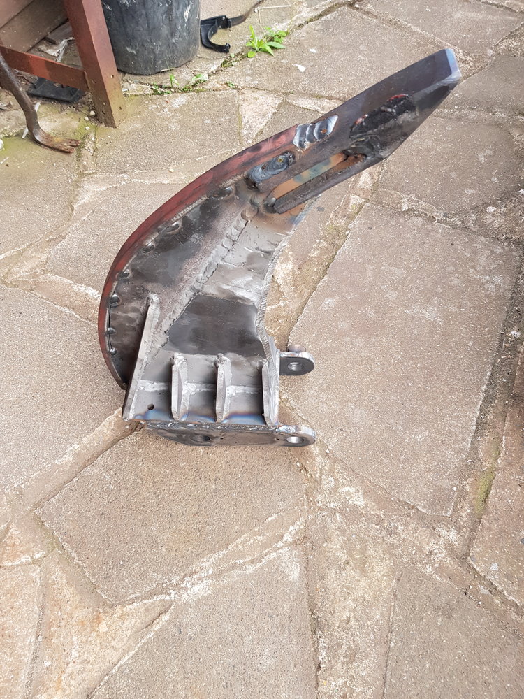

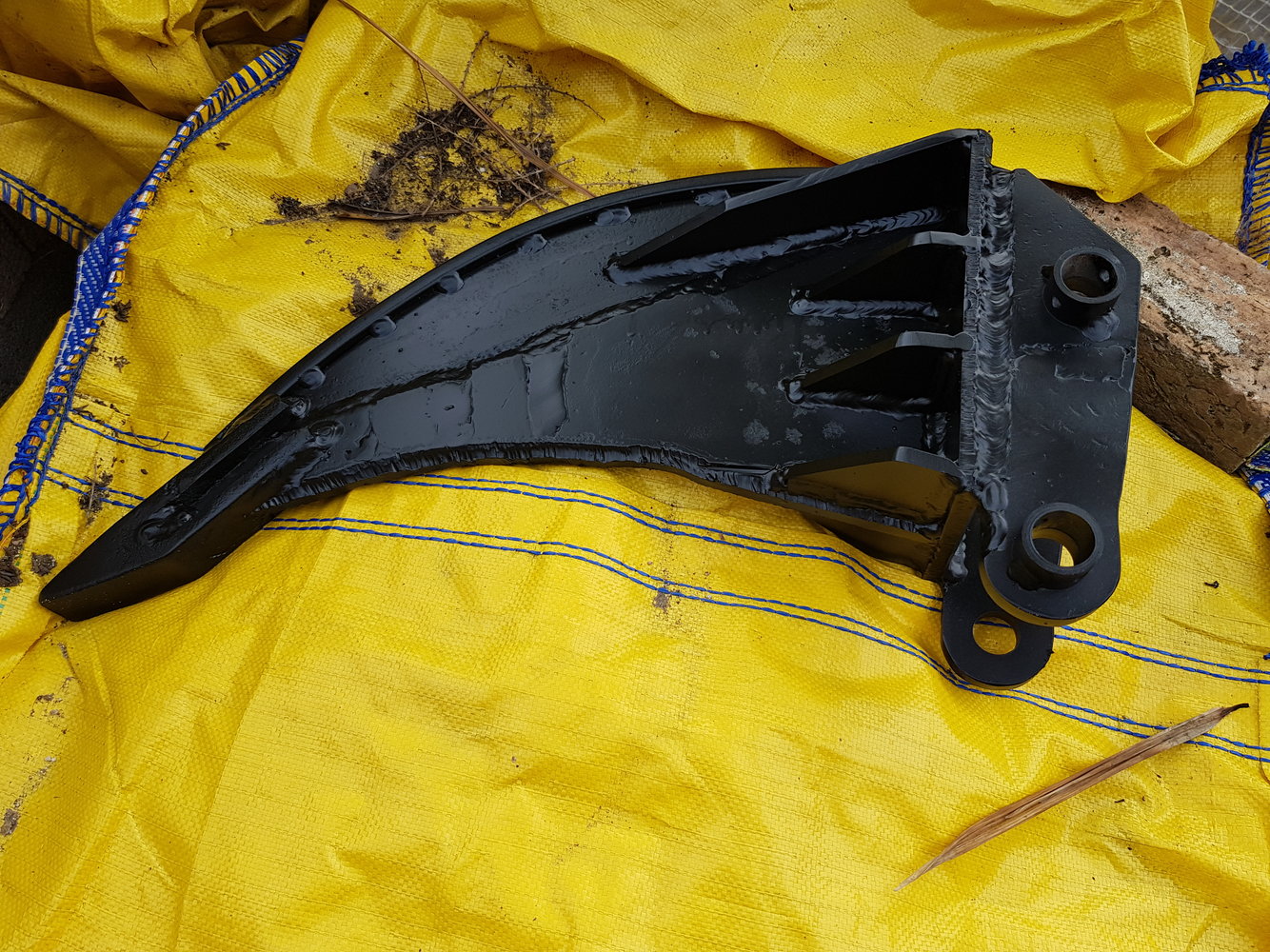

It's mild steel, not much snapping going on....Not if it bends or snaps !![]()

If my welds holdIt's mild steel, not much snapping goin

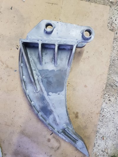

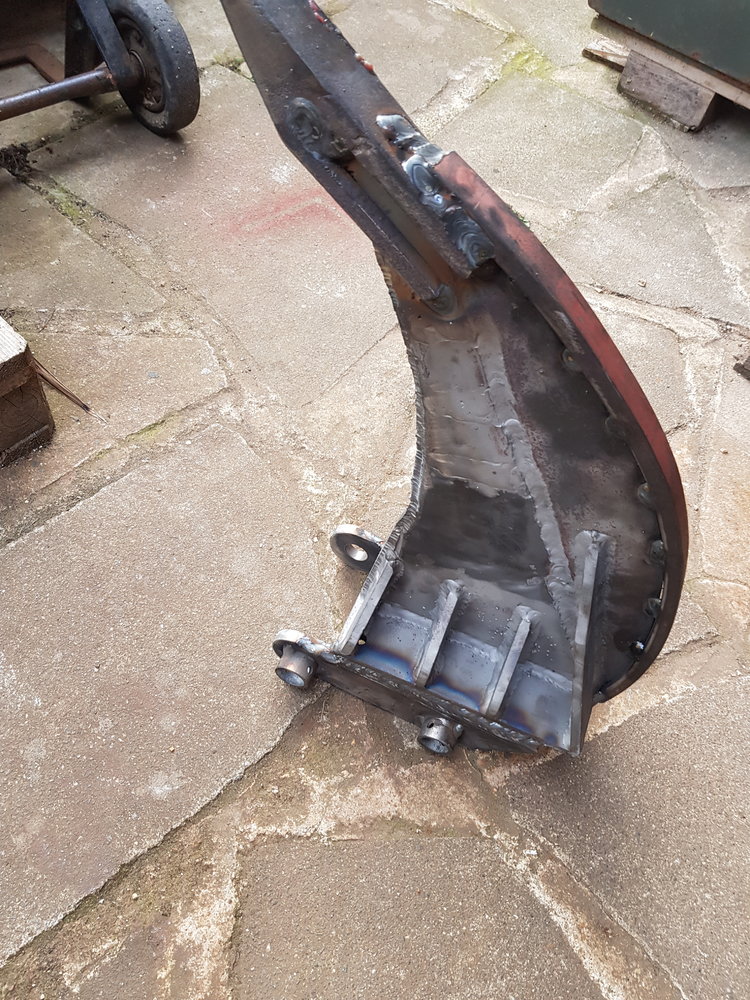

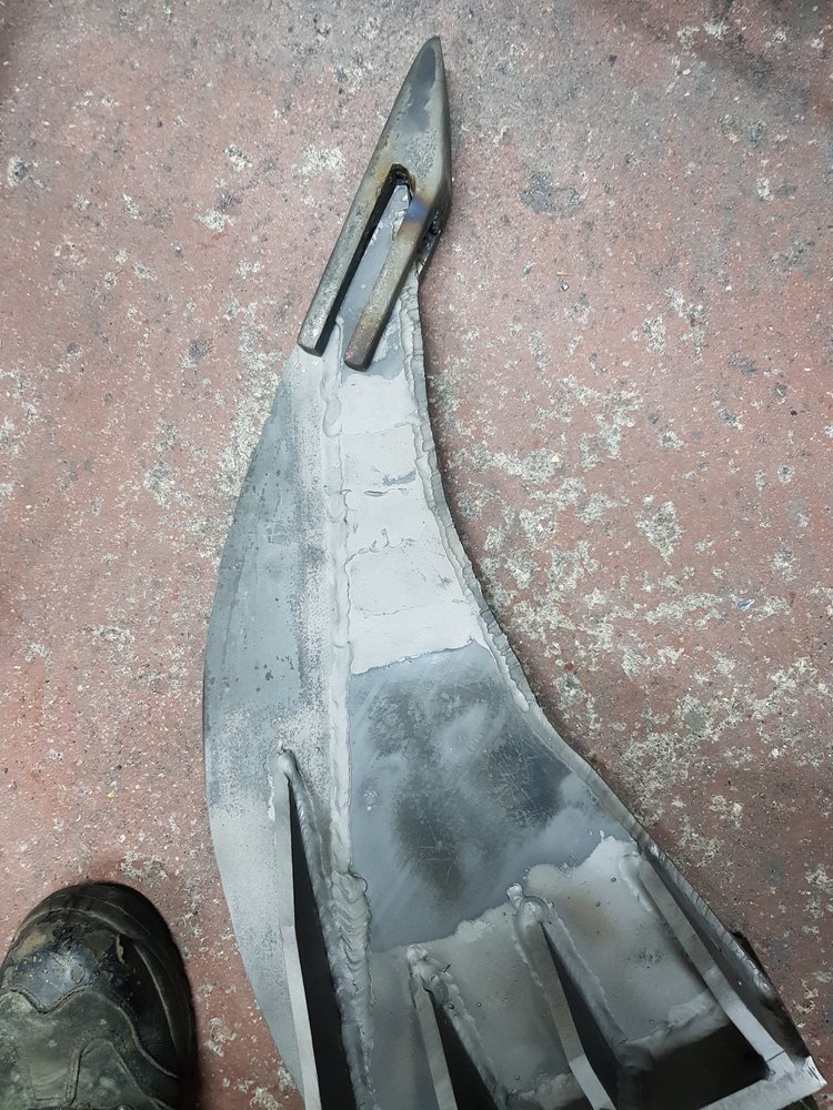

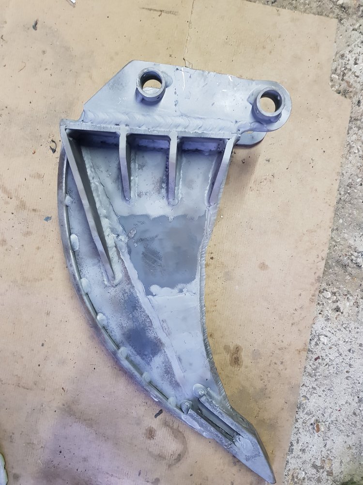

I am impressed with how this has turned out. I was going to make one for a machine a few years ago but got offered a second hand ripper, just had to fit a new tooth and change the head stock to match my machine. I think it came with 3 new teeth at the time but it is still on the original one so as you said it will last a while.Modified a digger tooth wont be replaceable but should last a while for the uses I have for it
Thanks , it kind of evolved as many things do as you make them.I just had this bit of thick plate with almost a ripper shaped bit sticking out and just thought id pull the trigger and make a start. There are so many different shapes when you google it but for a small machine i need to have a curved back to roll on when im levering stuff upI am impressed with how this has turned out. I was going to make one for a machine a few years ago but got offered a second hand ripper, just had to fit a new tooth and change the head stock to match my machine. I think it came with 3 new teeth at the time but it is still on the original one so as you said it will last a while.

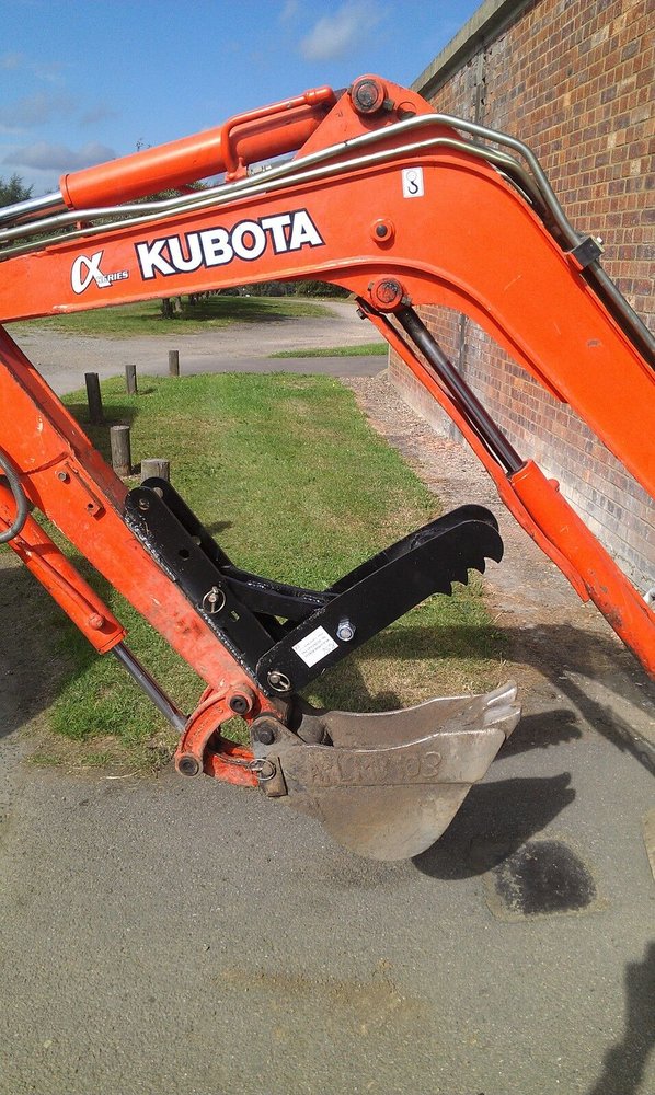

A grab would be useful but I think a folding thumb like this is next on the list as pretty sure i have most parts to make itHopefully you haven’t exhausted all your stock, as you need to build a grab/grapple or possibly a rake/riddle bucket next.
