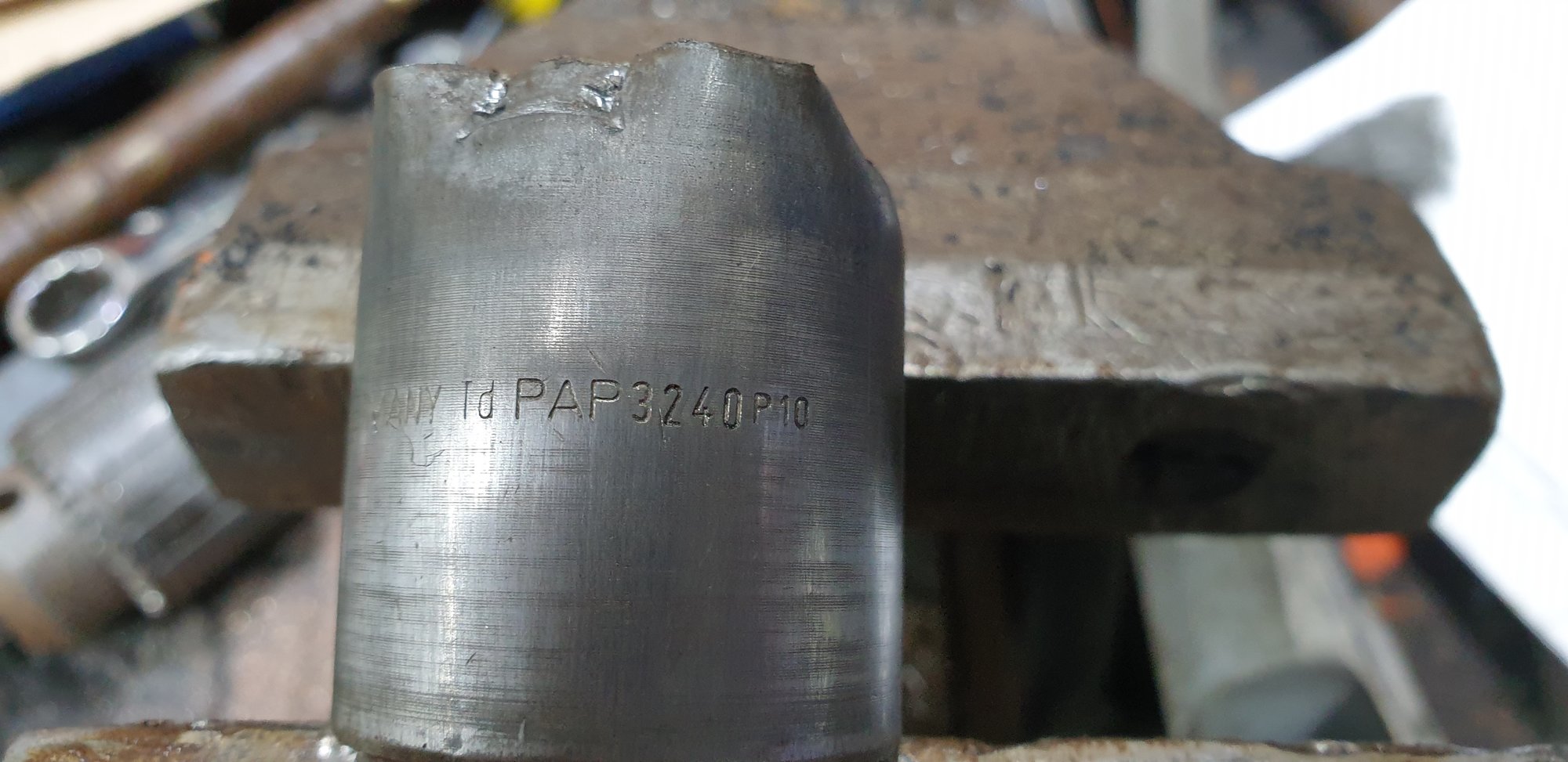

Got to the stage where I would very much like to replace a few bushes and pins on my digger, powerfab 1200xd.
Only problem is they are a weird size! 32mm bore, standard is 30 or 35mm..
Contacted a few places including digbits and computer says no, did find somewhere in the Czech Republic that stocks 32mm, but not very handy.
Anyway, I have a lathe, the bushes are supposed to be hardened but would en24 suffice? Maybe en8 or en16 for the pin? Its not going to be on a job site day after day, thoughts..
