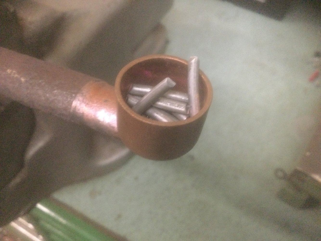

Ideal for tinning cables without frying/melting the sheath.
Idea stolen from elsewhere and thought I would try it, mini crucible using a 15mm or 22mm copper pipe cap and a gurt soldering iron.
22mm copper plumbing cap perched on a gurt soldering iron in a vice, probably a good idea to copper wire it into place.
Add some full fat plumbing solder.
Leave for about fifteen minutes

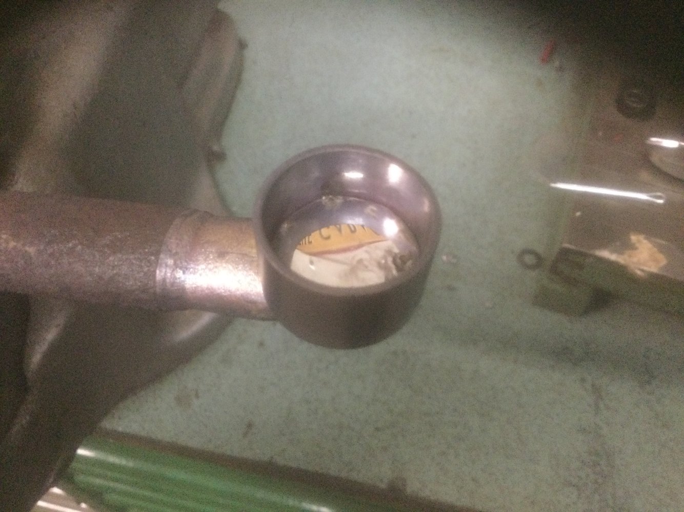

A drop of flux and dip cable end.

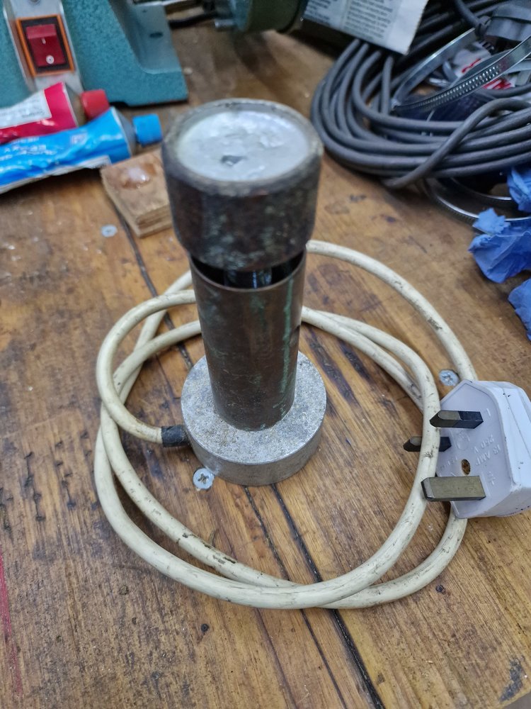

i just flux them and tin em with thin solder stick and a blowtorch and dip in water as soon as solder has taken to dissipate heat
