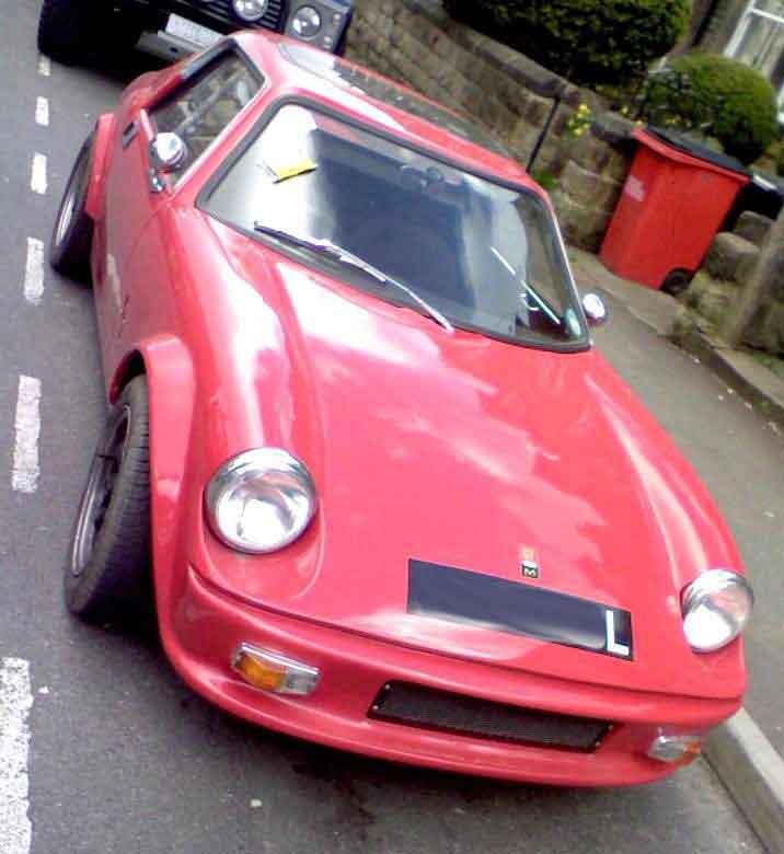

Friends of mines selling this one, 1972 Tax Exempt, 1160cc Engine based around a 1071 south african cooper S crank bored to 73.5mm.
Can forward his details if needed.
