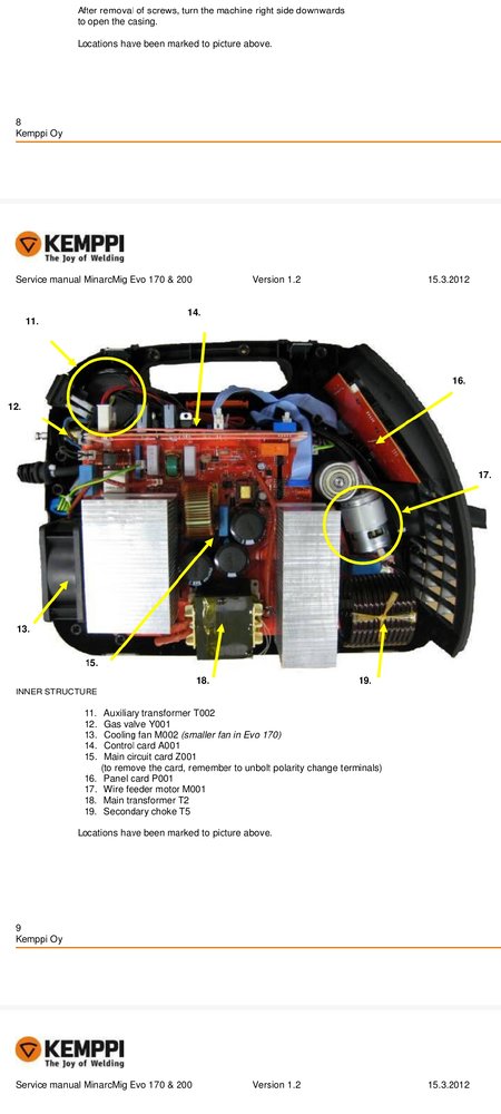

Hello. I have a Kemppi MinarcMig Evo 200, and its wire feeder is not working.
I've tested the motor with a power source, and it works just fine. When I press the trigger on the handle, I hear a "click" from the main circuit board, and at the same time, the machine's screen dims slightly. However, the wire feeding motor does not turn.
I've measured that there is no voltage on the wire feeding
motor connectors while pressing the trigger.
After repeatedly pressing the trigger multiple times, the overheat light turns on.
What might be broken? Is there any way to test which component is faulty?
