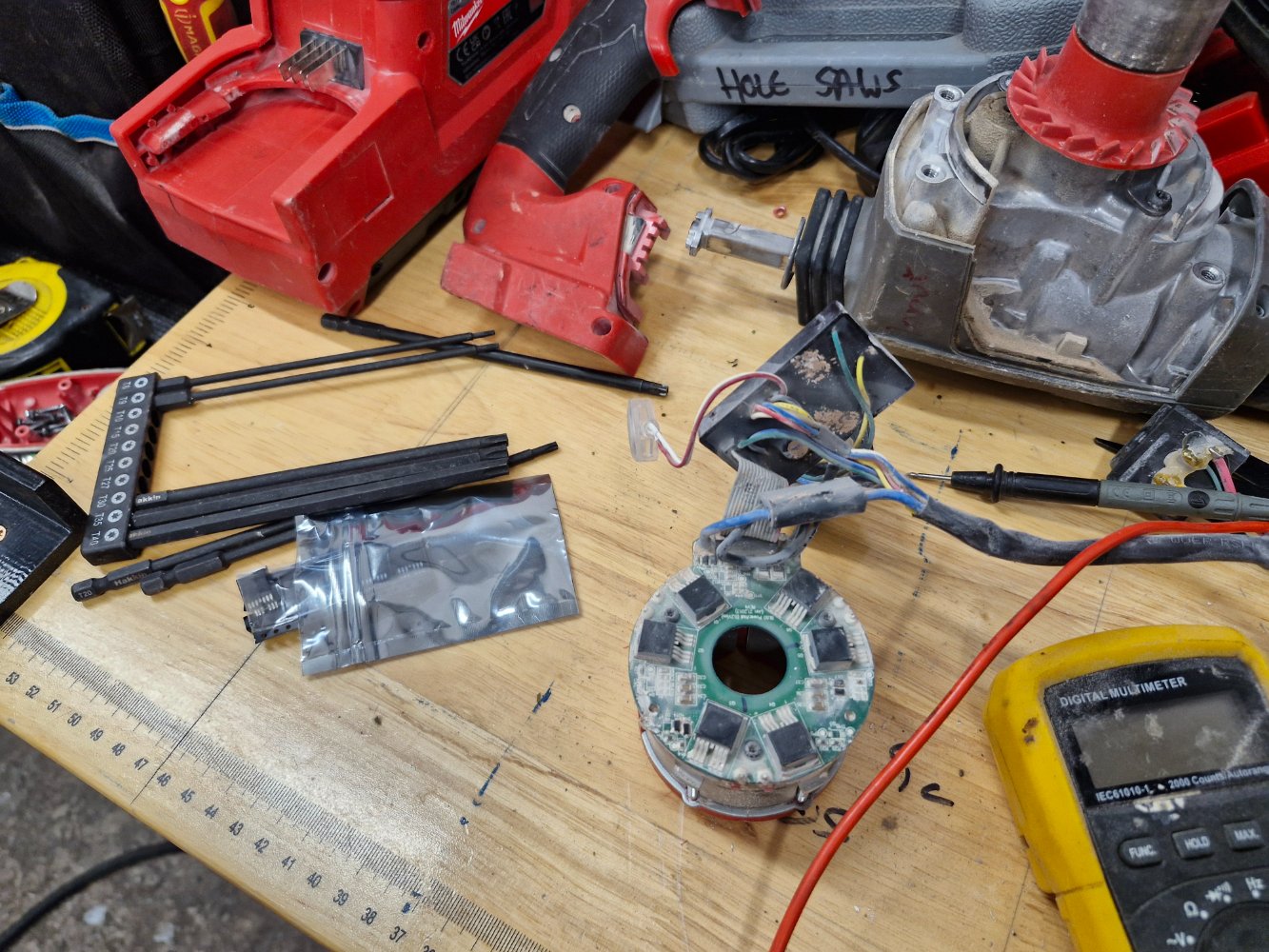

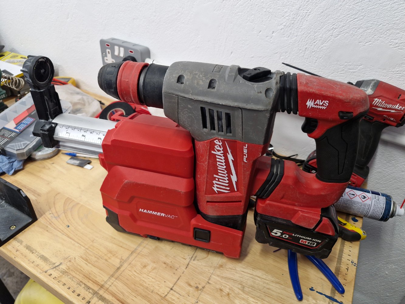

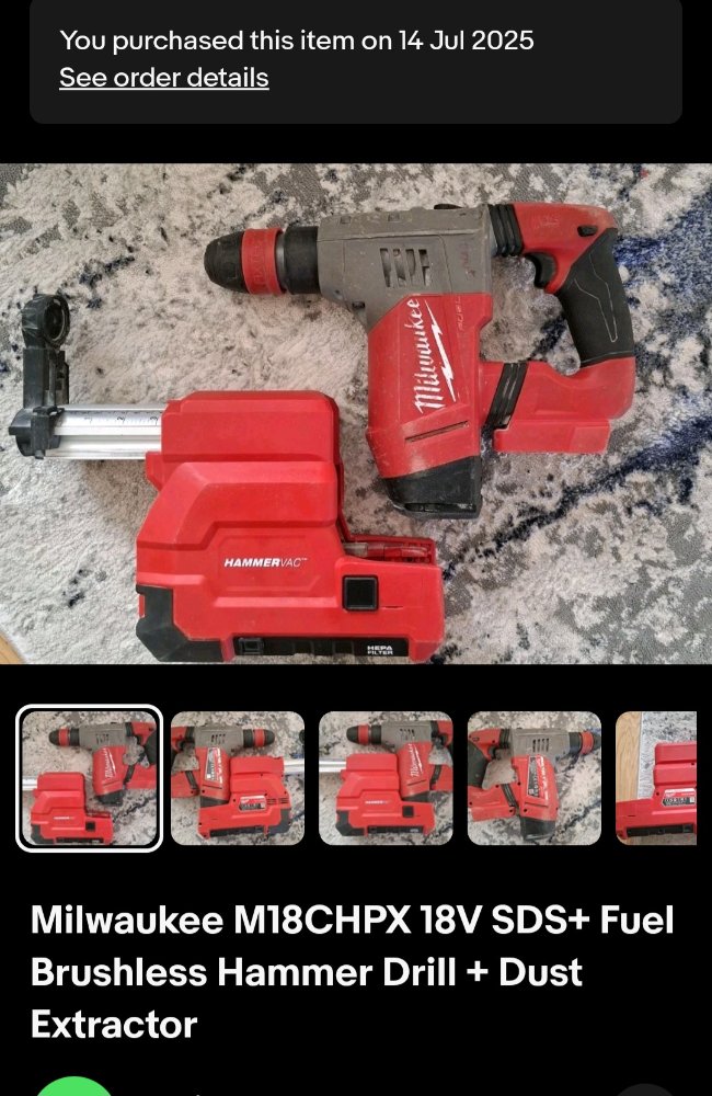

I have successfully repaired quite alot of my Milwaukee items. I buy a good few tools as spares or repair and see if I can fix them.
My latest purchase arrived today-
Vac said to be in full working order but SDS drill dead.

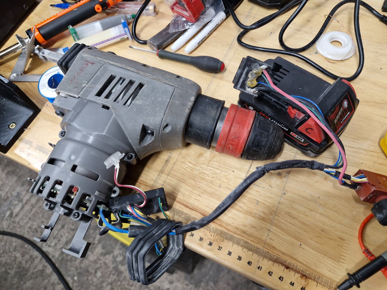

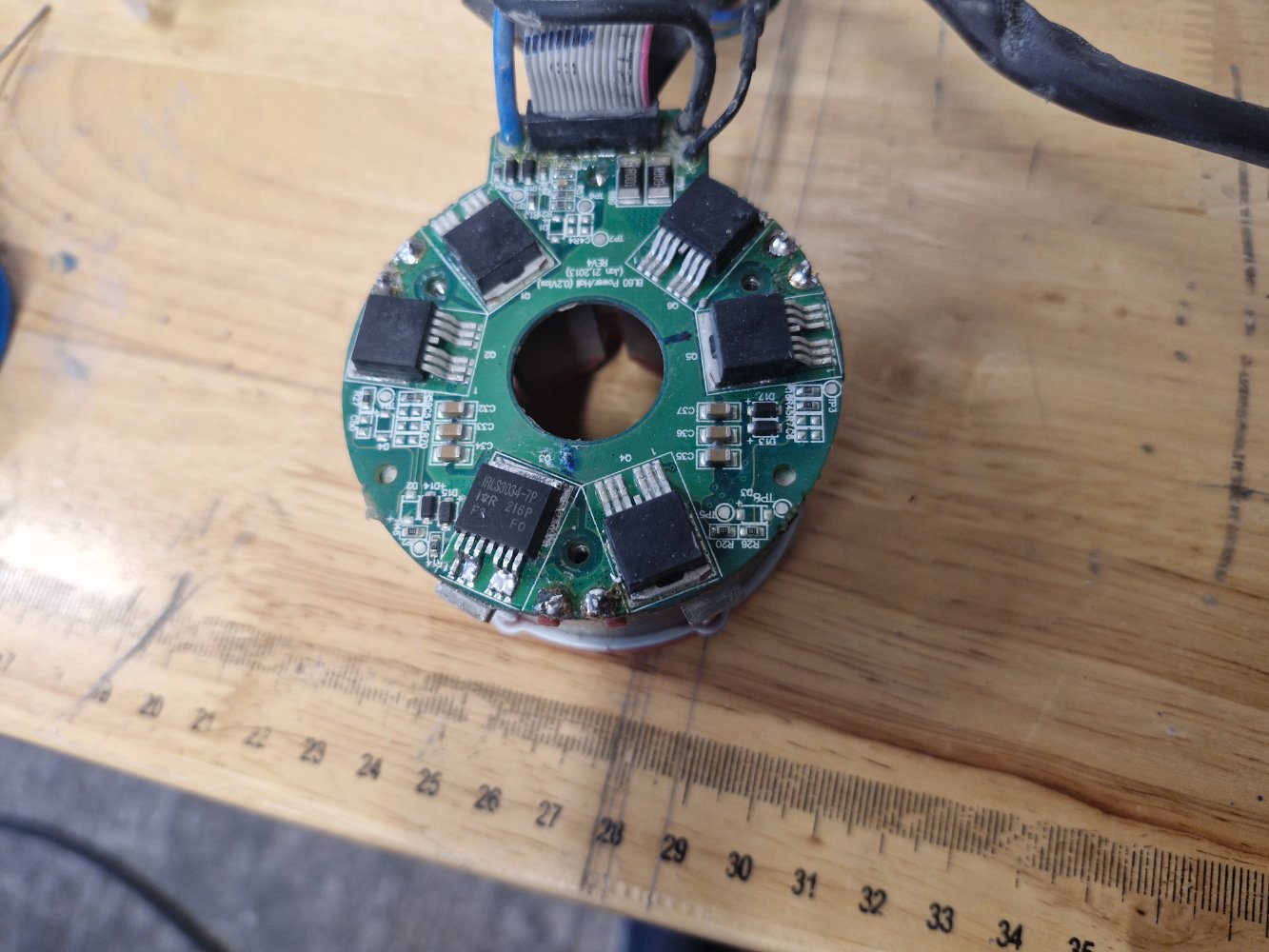

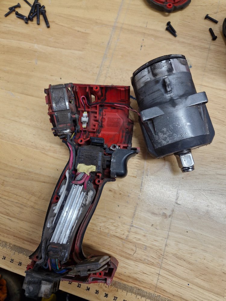

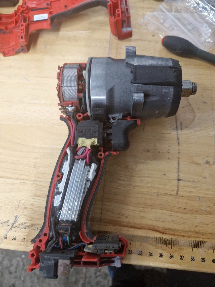

I checked the drill and sure enough of course it's dead. LED light comes on which is a good sign but motor not going.
I checked for an easy fix of a broken wire inside but no such luck. On further checking I can see shorts in a couple of the mosfets.
Handily I had a set of 5x new mosfets on the shelf so I guess I ty replacing 2 or 3 of them tomorrow with my hot air soldering station and a soldering iron
First time ive found shorted mosfets first attempt to replace them.
