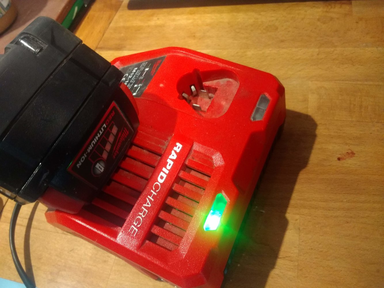

rc charger ?
I fed the two low ones 5v at 200ma, CPC lists the charging voltage as 4.2 so maybe the cells are baked now rather than a bit low.
Maybe I should have looked up a charging voltage before that but I didn't know the cell type.
Hindsight is great.
The specs on them are impressive, peak current of 25A, I can see how these micro jump packs can step up to cranking an engine and still fit in a pencil case.
Q5 and Q4 are plenty big enough to handle that current if specced appropriately. I've had SOT style packages rated at almost 100A if you design the PCB appropriately. It's fairly easy to get sub milli ohm Rds(on) FETs and if they're switched hard on or hard off then minimal power is dissipated in the package.Some Li-ion power tool batteries contain one or two large MOSFET transistors on heatsinks, which cut or enable power to/from the cells. There are no components on the PCB of this Milwaukee battery large enough to switch the 20- to 40- Amps involved, so the board only monitors voltages, and balances and temp-checks the cells. The 20-odd volts should always be present at the outermost two terminals. The PCB will use one of the other terminals to signal the tool to shut down on low voltage, and probably to control the charger too.
It should be possible to charge the battery using a generic ( Radio-Control ) charger, and to test it under load ( 2 x 12v headlamp bulbs ) across the outermost two terminals.
