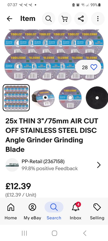

							Been using them for years, used to buy 100 at a time, 50 for me and 50 for workmate.

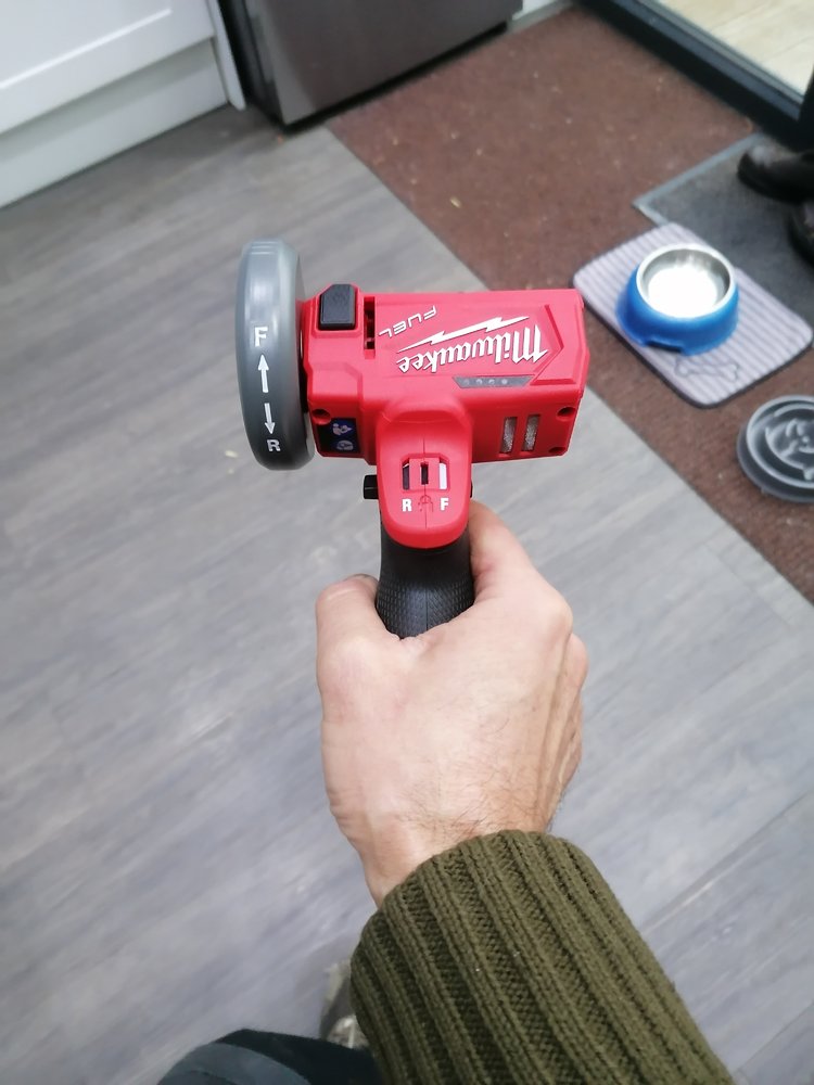

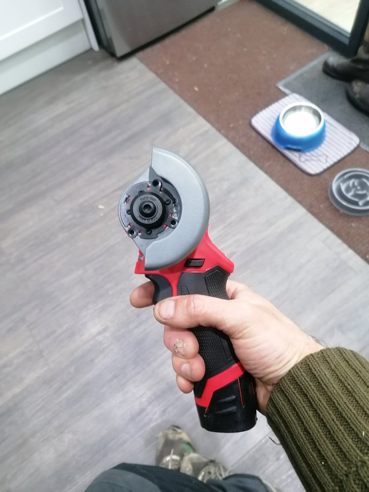

				Theres a stop on the guard for how far round it can go I think. I broke it so I can spin it all the way round if that makes sense. It’s handier like it. I can get it in more tight places
I shall have a closer look later after work. ThanksTheres a stop on the guard for how far round it can go I think. I broke it so I can spin it all the way round if that makes sense. It’s handier like it. I can get it in more tight places
I think so. It’s been so long. If you wait till Monday I can show you. I think I remember taking the four screws out.I see the little tab you mean, @KimB did you have to remove the whole little ring with the 4 screws to break that tab off?
I looked i would have to revove the 4 screws cut the tab off then the magic would happen! it has a few other tabs with dimples that locate in the holes as it is sprung loaded. I can see exactly what you did and snapped off.I think so. It’s been so long. If you wait till Monday I can show you. I think I remember taking the four screws out.
from memory there’s still something that locates each of the normal holes to stop it spinning easily.
If you have a pic it may jog my memory.
