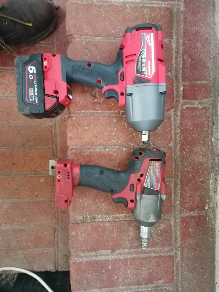

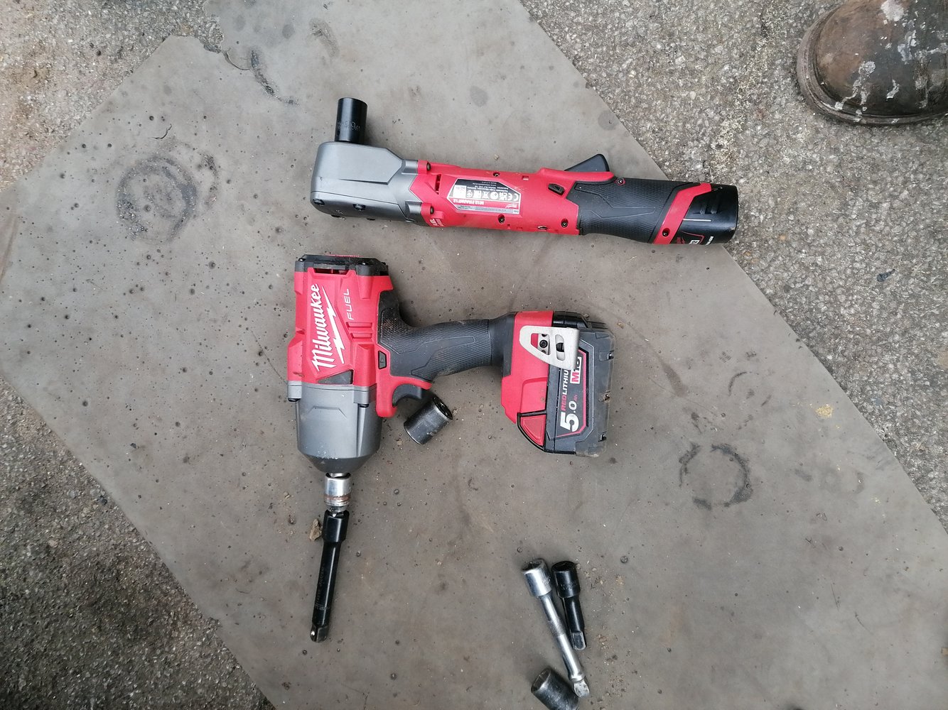

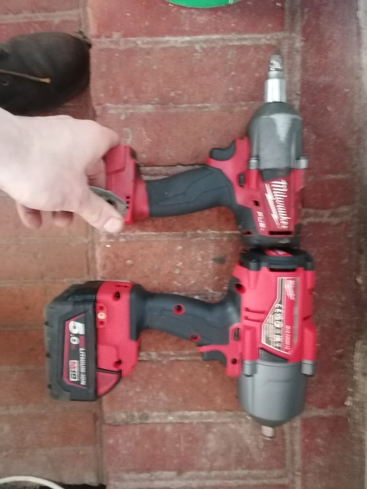

The 12AH really shines over the non genuine ones I normally use- not sure about a genuine 5ah. Using the 3/4 with a UJ to reach some tricky shackle bolts- no go with a 6ah Waitely battery, slap the 12ah genuine in there and she's away (just!) You also need the high output geniune batteries when running the bigger M18 grinders (I have the 150mm)- they'll trigger overload in the smaller batteries.I have that High Torque and it’s never failed me. Spins hub nuts off the old Shogun with ease.
On a slightly separate but related topic. Has anyone used the High Output batterie? I use the big torque gun with either a 5 or 9Ah battery and whilst I notice the difference with the bigger battery the 5 still does everything. The 12v stubby I use most and wonder in if the new M12 5Ah High Output would give it a bit more umpf over a 6ah

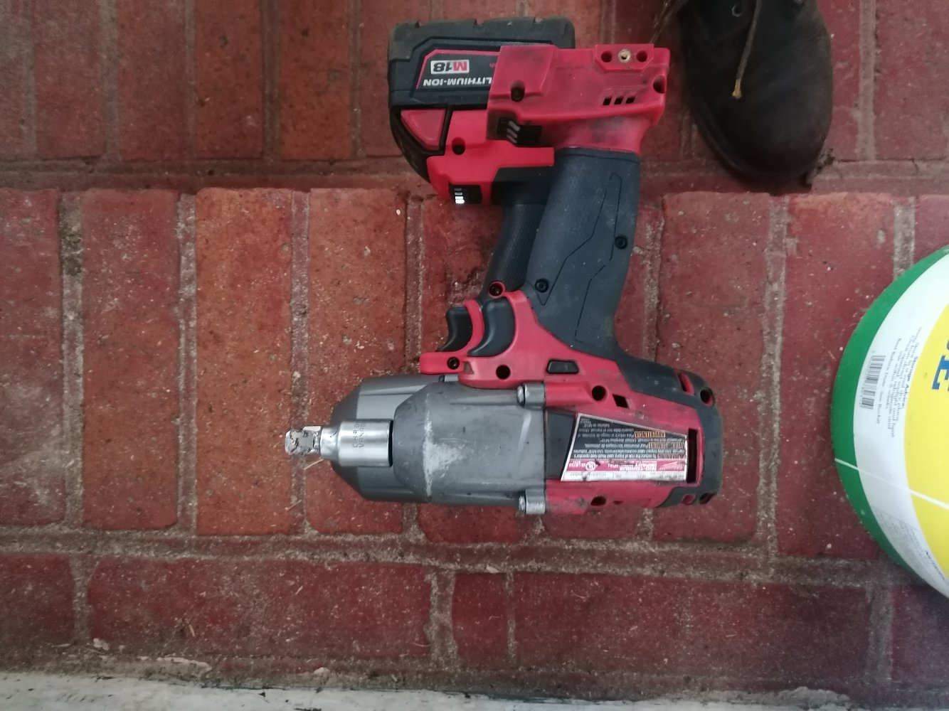

I still have my first gen 1/2, but now use it at home so it is officially retired, even still have one of the original 4ah batteries, gun and battery well over 10 yrs old.Don't the latest generation of high torque 1/2 and 3/4" impacts have an issue with snapping anvils?
I've got the first gen high torque 1/2" and it's indestructible. Seen quite a few reports of the latest iteration of it not lasting at all. One customer in the states bought one from Home Depot, broke it first time he tried to use it on some wheel nuts. Went back into Home Depot and they didn't believe him. They pulled 7 units from the shelf and proceeded to snap all of them in the car park.
