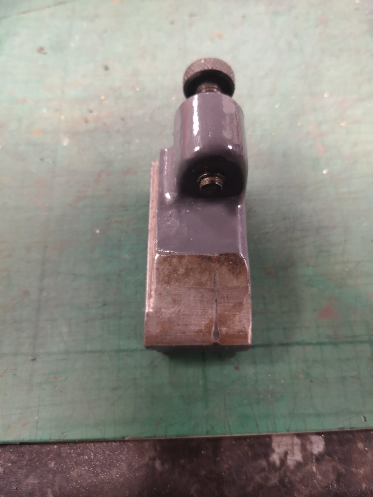

A few jobs, sort a front cover out for the horizontal, this will save you a load off hassle.
Grub screws (if you haven't got any I think i have spares!)for the 4 attachement mounting holes, although I use the bottom 2 to hold a sheet over the back to the bed to attempt to keep the worst of the ways
Not sure what the floors like, but i ended up putting mine on levelling feet
If you intend to run coolant really think about an internal tank

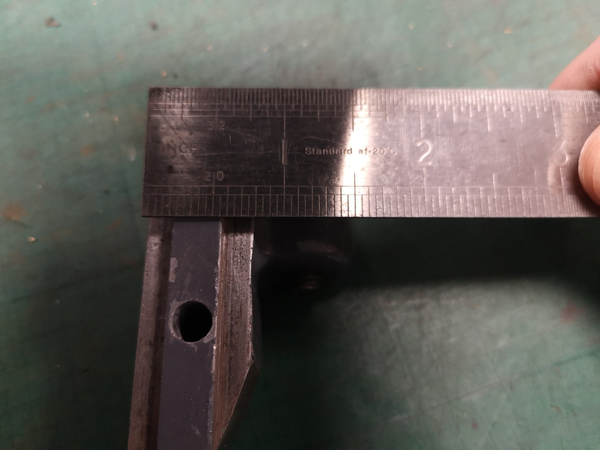

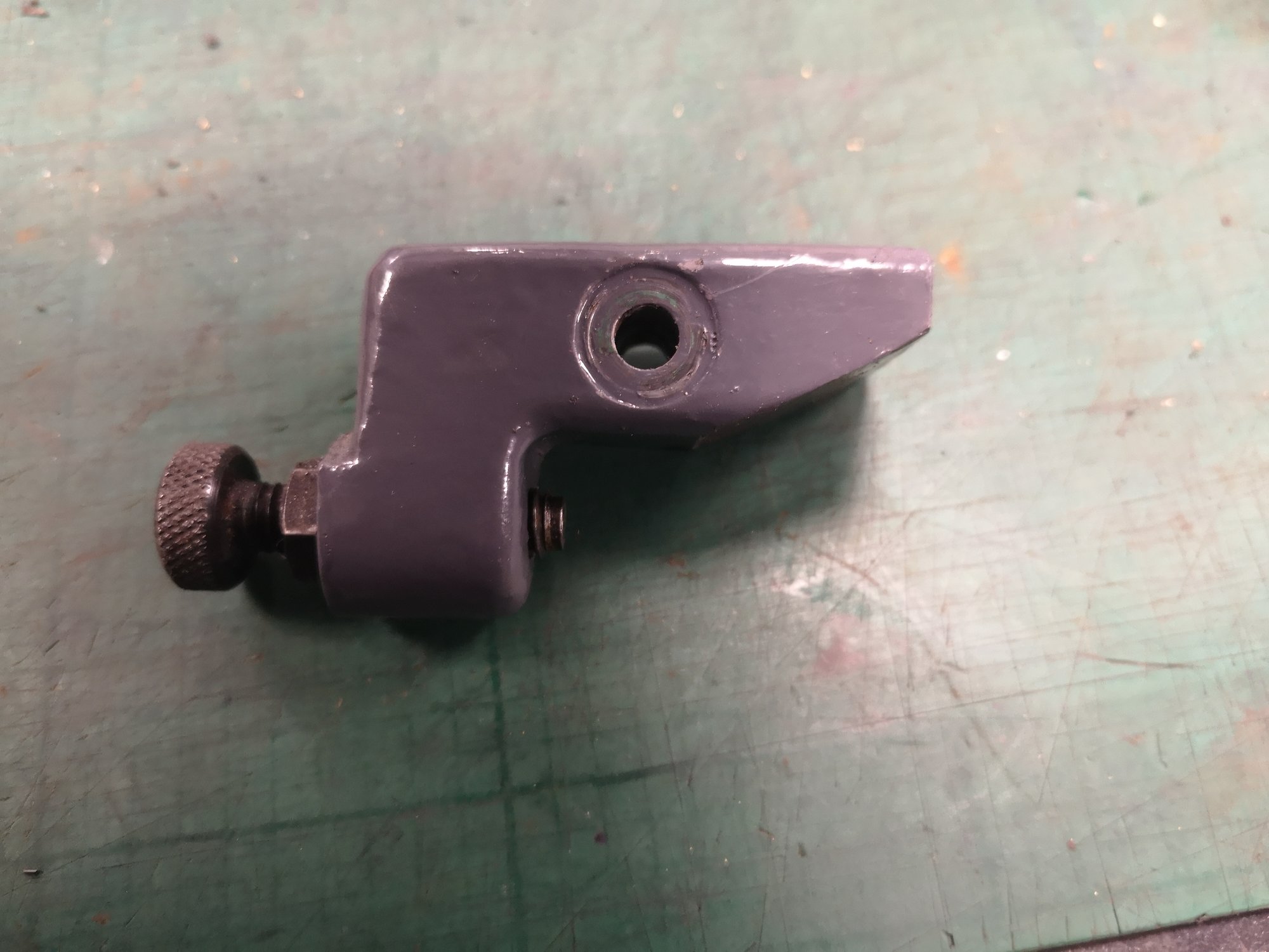

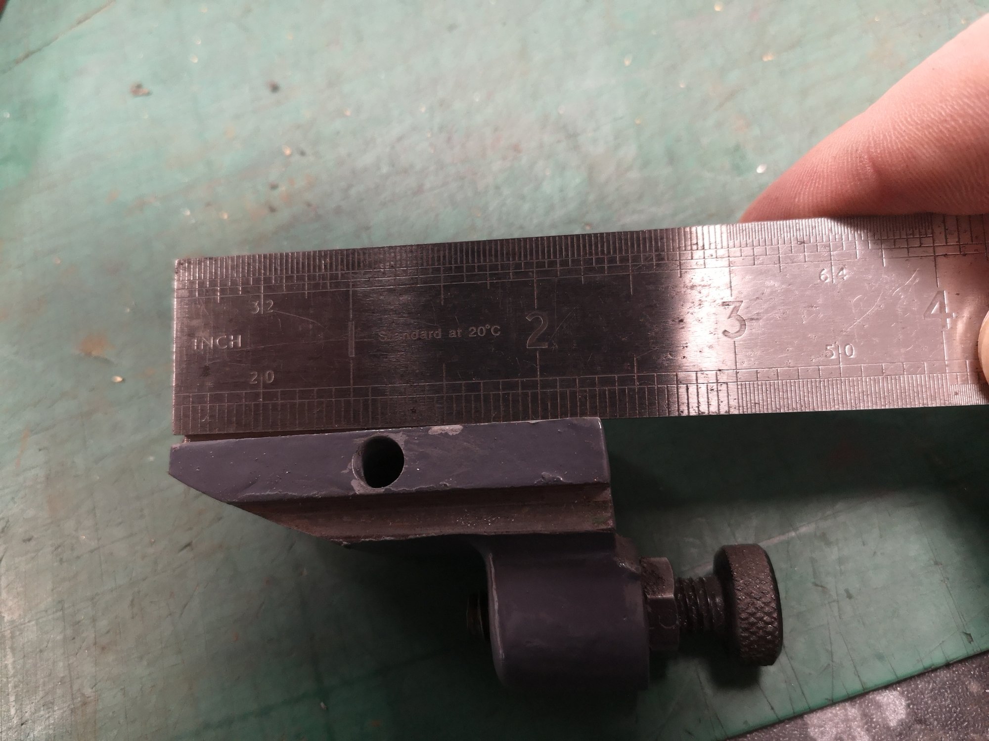

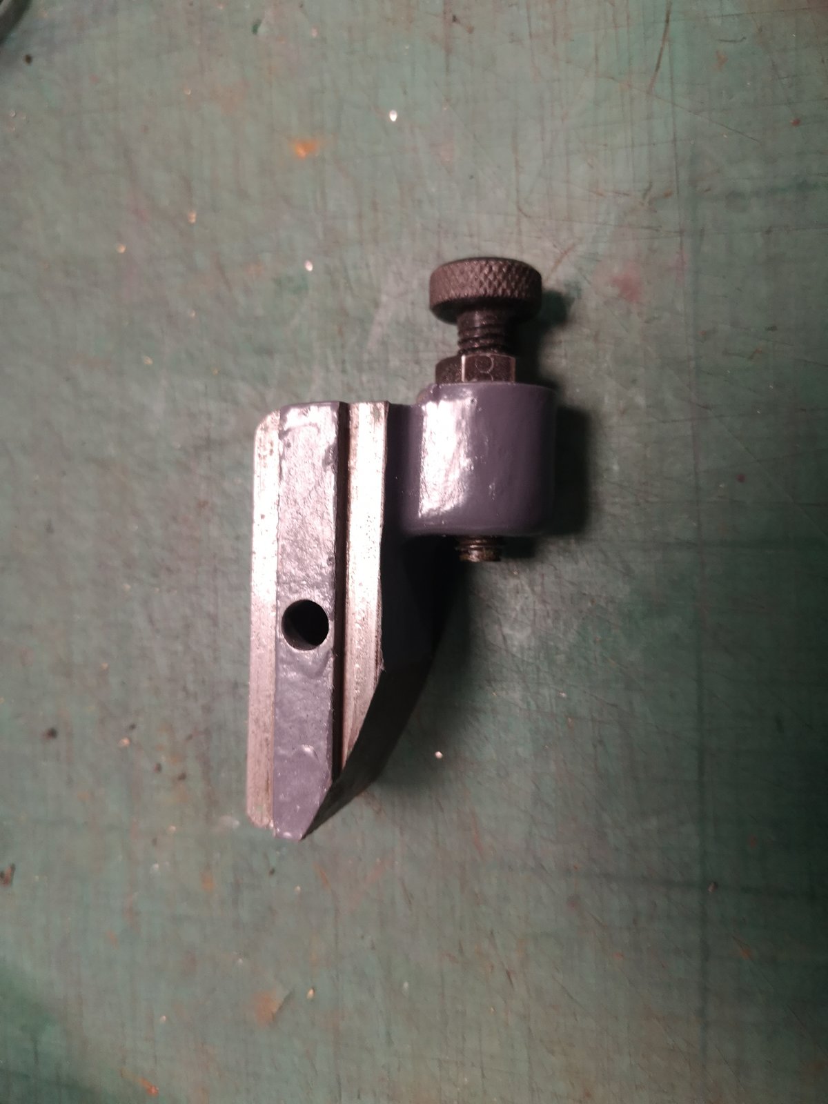

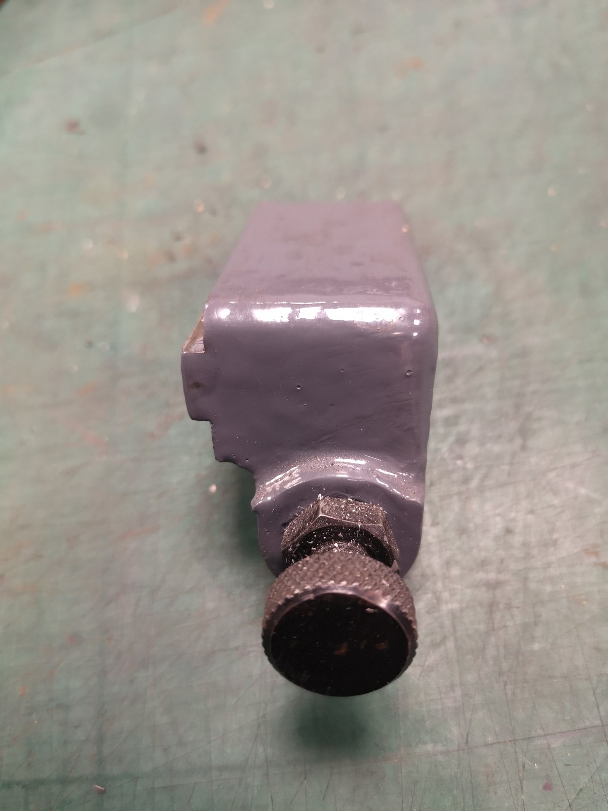

No promises but I will try and draw out and photograph the stops at some stage this week, they have a slope to gradually disengage the feed.
