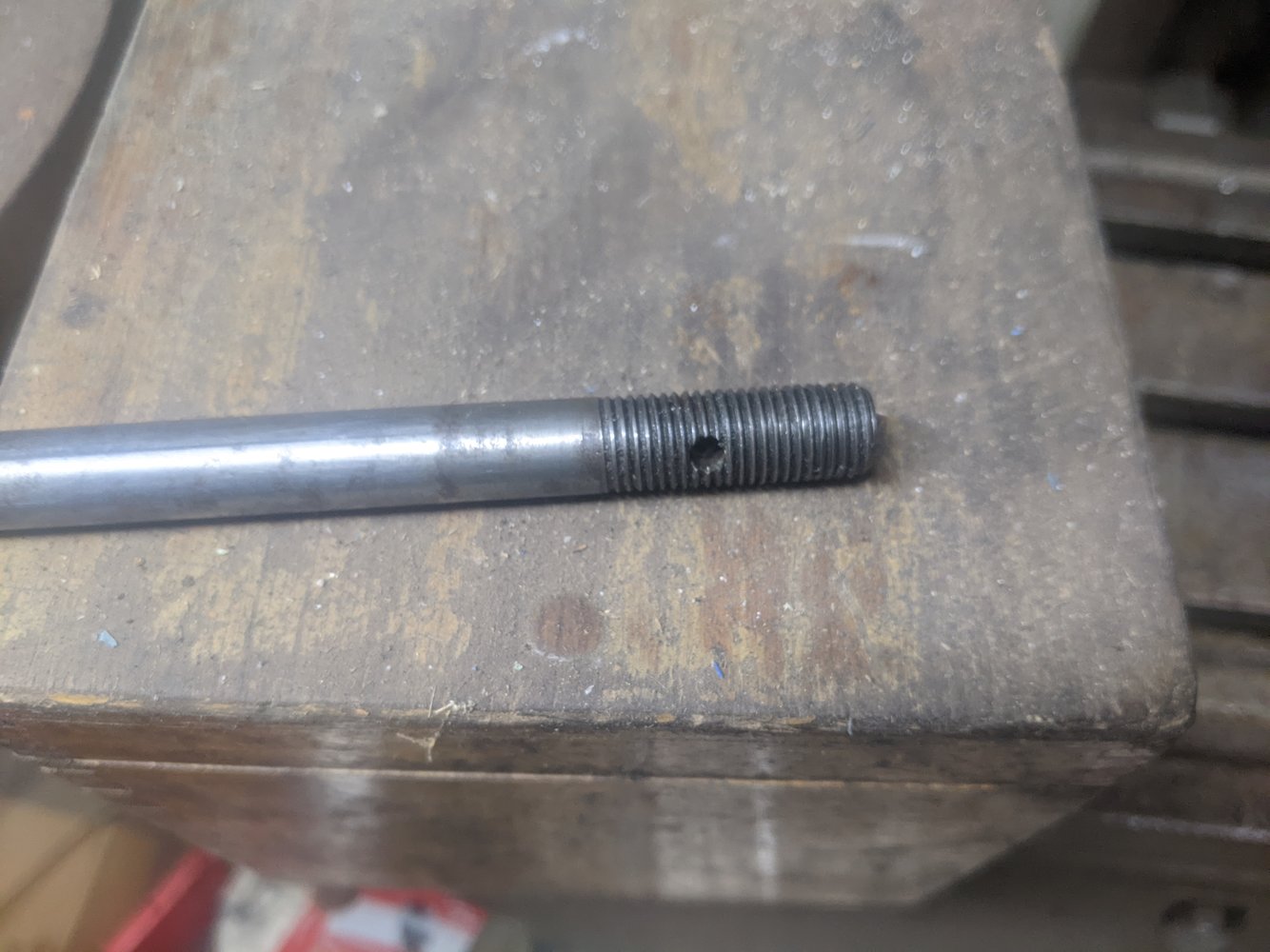

I'm ok on the pulley end, it's the shaft I'm doing

Pulley held in the lathe chuck/on faceplate, parting blade (with attention to rake etc.) on its side in the toolpost so it can reach into the pulley bore and shimmed to centre height, back n forth until your arm gets tired cranking the carriage*, taking a couple of thou" each pass by adjusting the cross-slide, I've done quite a few like that, no slotter (yet...)I have always struggled with "broaching" internal keyways in pulleys on repair jobs.

*power feed would be good *if* you can run it without the spindle turning - some can, some can't - can on my Holbrook, on others it might mean pulling the pin for backgear but not actually engaging backgear?
