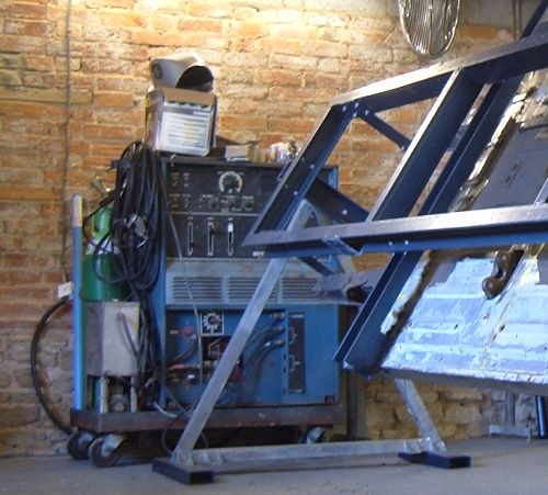

Check out their pdf manuals for details. I think all syncrowaves had a choice of voltages, but the choices varied. Some offered 240V. Mine had the option of 208V which works OK on a 240V supply. With mine I had to open the side cover to find out which voltages were covered.
I assume you are talking '70's and '80s machines like mine. Bear in mind they are huge machines - not something you can hide in a corner, and they will trip supplies with the inrush current. Mine is happy on a 40 amp type D breaker, but would trip a 40 amp type B. Ideally I've have it on a 110amp supply for the full 375 amp output, but I only weld thin stuff so haven't troubled the 40 amp breaker.
Naah - mine is a Synchrowave 300P (p for really efficient) dating from 1979. Not quite sure when they started but they did go on for about 20 years.
Funny you should mention the current - must be non-linear as I've done some accidental blasting with mine while getting used to the foot pedal without blowing the trip.
Voltages do vary - you'd have thought a welder sold in the UK would have jumpers for 415V (2 or 3 phase) and 240V, but mine was 415V and 208V. Alabama spec I think.
Hmm, did not think they went that far back. Looking at the schematic, I can see mid-70's parts used.
