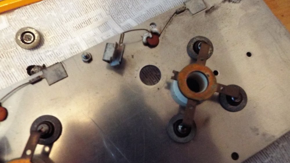

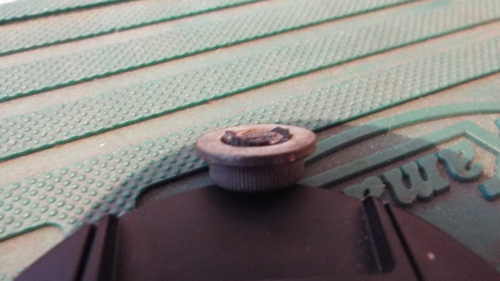

that number doesn't come back to anything in a search, as long as the diodes tests good that's all you are looking for, maybe miller have just configured them that wayive tried to pull the knackard one out but its just breaking up - the diodes on the opposite plate to the one with the brocken diode seem to sit slightly prouder and i think i can read the number 28819547 but they seem to test the opposite way round with the multi-meter or are they the same diode just fitted the opposite way round
They are the same diode, however they're constructed so that the polarity is opposite, one to the other. In physical terms it means that if you get a reading on one set with the positive lead connected to the alloy heat sink then, for the other set, you will need to connect the negative to the heat sink for a similar reading.are they the same diode just fitted the opposite way round

I would be looking at getting the amperage of the diodes and buy some new ones and save some cash I would imagine they are in banks of four so they will handle the power between themim right handed and have a auto darkening helmet so as long as it only costs my left arm i should be ok ..... from looking on the internet and other people who have had to buy similer rectifiers for other welders i dont think im going to get much change from £200 and thats if they can get one
higher ratings are fine, all you need to do is find a supplier and speak to them tell them the spec of the machine then they can advise if they have match, bolt in would be idealthis might make no sense because i dont really know what im talking about but if i replaced all the diodes with ones that are bigger / higher rating than the ones fitted would that work or do they have to be a exact mach for the old ones
you could build a complete new rectifier, only 2 ally platesyeah i have noticed them bolt in ones with tail wires coming off and they do look like they could easily enough be retro fitted into the rectifier so looks like thats my next route if they cant get a new rectifier or want daft money for one
