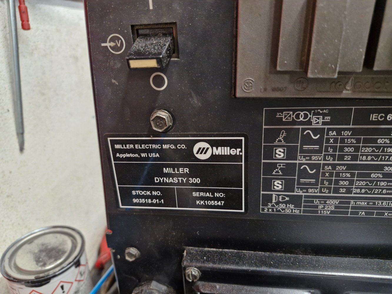

In USA on a single-phase supply Black is Live and White is Neutral.
( Think "Black Death" over there, here it is "Sh1t, that's Live" - i.e. Brown.... )
So yes, it would be Brown to L1 and Blue to L2.

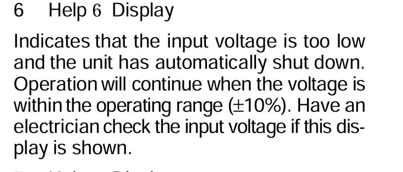

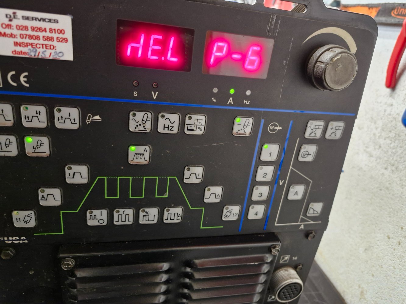

Have you found any W1 and W2 relays on or near the Control board?
