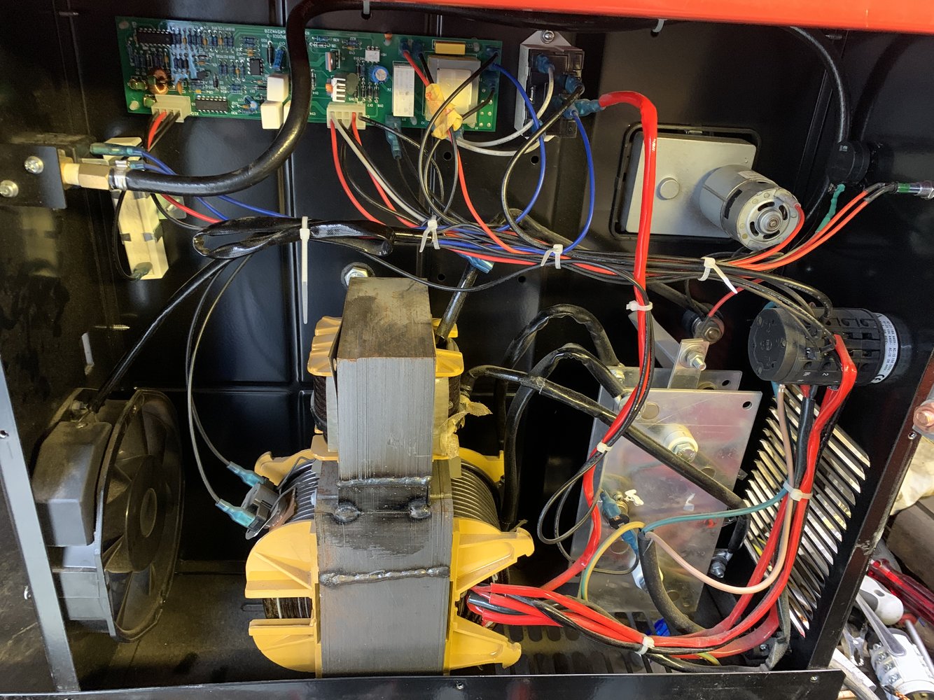

H Hutcho Forum Supporter Messages 672 Location Derby Oct 5, 2021 #1 Had someone drop this mightymig 170 of to me with wire feed problem - just one speed , if anyone has this problem check the two irf trannys - 540n 640n , both had gone in this one .
