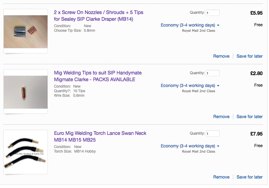

Trying it cold, the feed seems to work fine, but I have found the tip is fit for the bin and the neck is falling apart, and there is no gas shroud, so i'm planning to buy a new neck, shrouds, and tips - then hopefully I can get practising
I think i'll treat it to a new wire liner too.

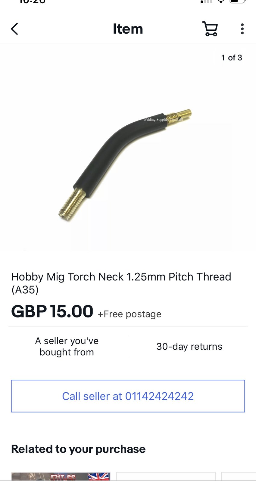

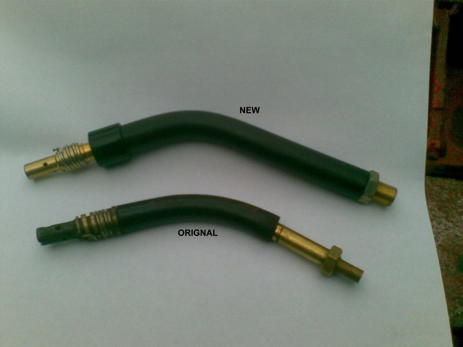

Can anyone confirm the neck type so I can replace it please?
I think the neck is an MB14 hobbyist type neck with screw on gas nozzle/shroud (but the old one has a nut on the torch end, which clamps down onto the torch internals, and i've not seen these nuts on the MB14 necks on eBay - I can put it on a new one though). The broken bit is the remains of an internal part of a gas shroud, I think, looking at pictures online?
I thought it might be an MB15 and that the broken part might be a tip adapter and that the spring and shroud are missing, but I think it's possibly a broken screw on shroud, since the tip screws straight into the end of the neck.
