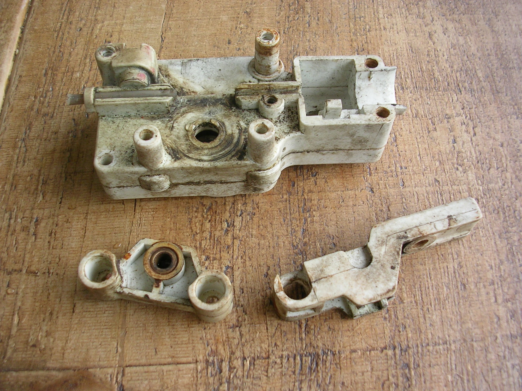

    Quite some time ago I was given an old MightyMig 100. The feed was very erratic: the wire would not feed smoothly or it would simply stop, even though the motor was running smoothly. Constant adjustment, new liners, clean rollers, new tips and fresh wire made no difference.
    I then looked closely at the roller assembly and realised that the plastic from which the outer support for the feed roller was made was slowly crumbling like Edinburgh rock. The more that I adjusted the tension, the worse it crumbled, stopping the roller from exerting any pressure on the wire.
    I fabricated an alluminium replacement part and the machine now welds faultlessly.
    If anyone else has similar, elusive problems, it might be worth inspecting this part carefully.
    James.

    I had similar drive problems on my Cebora till I realised the pressure exerted on the drive roller by the ball bearing roller was being dissipated by the plastic pivot bending. Made a small bracket to prevent the pivot bending & never looked back. The drive mechanism is definitely the “achilles heel” of budget welders.

    I've got a spare tensioner arm from an early MightyMig, if anyone needs that part.

    That is useful to know. I shall bear it in mind as the rest of the assembly is not in the first flush of youth. The outlet where the wire runs is showing signs of cracking as well.

    I'll also be getting the a whole MM wire feed mech. and torch in next week, if you need a replacement.
    I've found the weakest link with these is the plastic gear train losing teeth.
    Also, the 'hold down' piece for the torch lead tends to break (which is why it is missing from the photo below)

    Actually, it seems I have nearly the whole plastic assembly already, including the motor (not shown).
