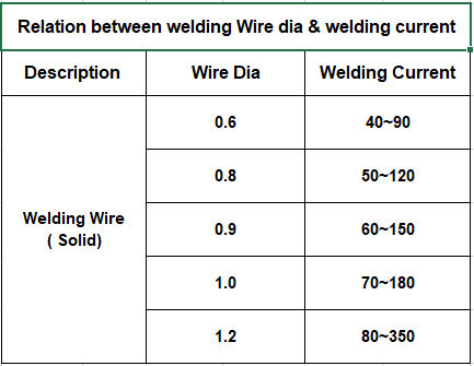

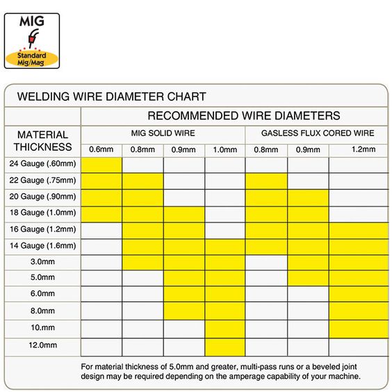

I bought a synergic mig or semi-synergic mig where i input the amperage the mig wire diameter and type of gas and the welder chooses the wire speed.
The welder is a 40 to 200 amps monofase and can handle 0.6 to 1.0 mm wire. I want to know from you more experts than i wich is the amperage range for 06, 0.8 and 1.0. Also the amperage for the tickness for the piece to weld.
