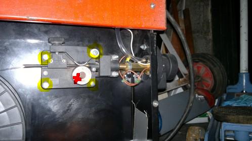

Don't think your ground socket should be making an electrical connection to the chassie of the welder.
Don't think your ground socket should be making an electrical connection to the chassie of the welder. If you get a meter and meter (set on lowest ohms setting) between the roller marked with red x and the chassie of the welder you may find there is a low reading indicating that the roller (and wire being fed) are shorting. it is possible that one of the bolts marked with yellow circle or the euro socket you have fitted? are shorting it out.
also check the size of the tip if its worn the wire may not be connecting to it as it passes through because that should be the last place the high current connects with the wire so that it heats up and melts only between the tip and the job.

Ah so the dinse socket was earthing to the case therefore the current was going both ways...
Ah so the dinse socket was earthing to the case therefore the current was going both ways, passing back from the tip through the feeding wire and back to the rollers, and also across the wire gap ?

good tipif it happens again check the reel of wire doesnt have some wire sticking out of the centre of the reel coming into contact with the welder body as it turns, you will have to remove the reel to check, it has happened before

Right, first thing to look for, is there a 'tail' of wire sticking out from the side of the reel which might be touching something inside the case and earthing it?
Ok right Ive just popped back round the garage to check to see if there is a "tail" of wire touching the case. "No there isn't" And I can't see anything else glaringly obvious.Bobo
