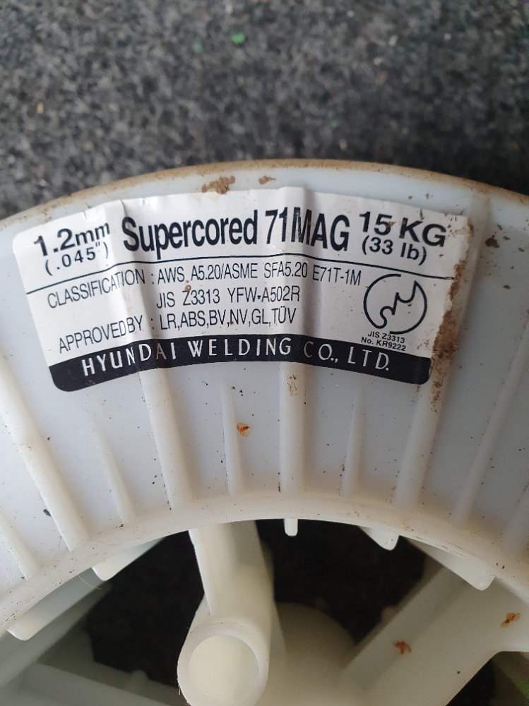

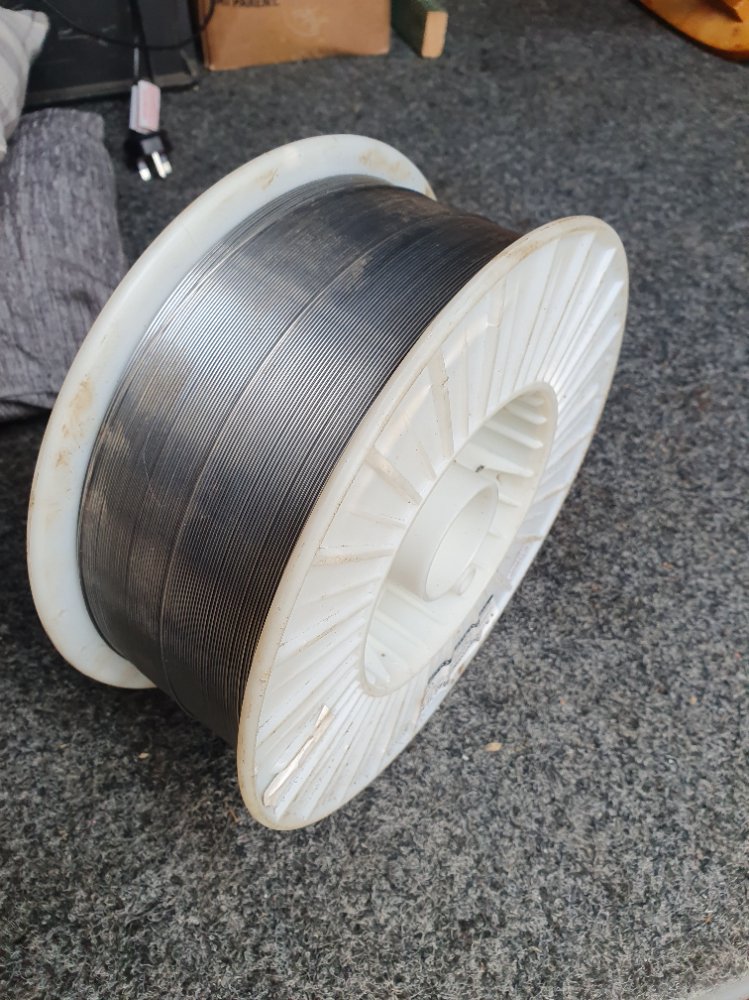

roofman Purveyor of fine English buckets and mops Messages 13,002 Location North West with water on 3 sides Tuesday at 1:02 PM #1 Rooting around my local scrappy this morning i found this large reel of wire..its mild steel but i dont know its application. Anybody ??? 20260113_125826.jpg 163.4 KB · Views: 30 20260113_125808.jpg 108.5 KB · Views: 31

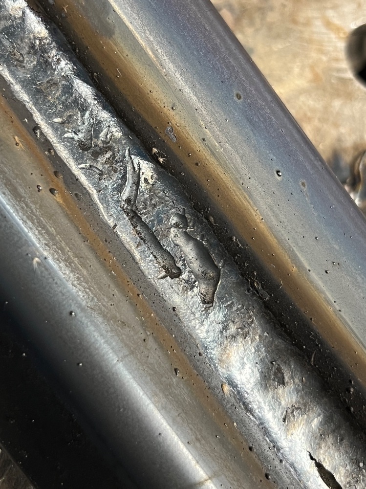

Jan-DIY Member Messages 852 Location Lower Saxony Germany Tuesday at 1:12 PM #2 Standard rutile flux cored. These wires comes in vac packs because the powder will draw humidity. If it is a closed wire it maybe is ok. Open or folded wire can result massive impurities.
A Agroshield Member Messages 6,261 Tuesday at 1:17 PM #3 Datasheet from the horse's mouth: https://www.hyundaiwelding.com/data/file/consumables/ttr/Supercored%2071MAG.pdf
BrokenBiker Member Messages 12,739 Location Newport, South Wales Tuesday at 2:47 PM #4 Flux core for big amps
J Jack Ryan Member Messages 735 Location Adelaide, South Australia Yesterday at 2:39 AM #6 I agree with Jan, there is good chance the flux has absorbed moisture, a recipe for worm tracks, worm holes and other porosity. That's probably why it is there. Jack
roofman Purveyor of fine English buckets and mops Messages 13,002 Location North West with water on 3 sides Yesterday at 6:52 AM #7 Thanks lads Shedendman said: @roofman you gonna give it a go? Click to expand... Dont think my SAF 165C would be up to the job mate...might spool a bit through this coming weekend to see how it burns

Jan-DIY Member Messages 852 Location Lower Saxony Germany Today at 1:24 PM #9 This is what you get when dealing with wire that contains moisture. IMG_1088.jpeg 319.8 KB · Views: 8
