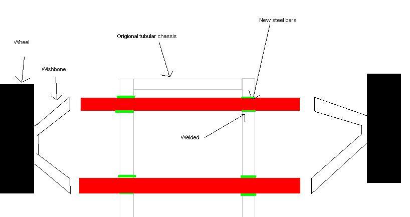

Rather than using the brackets that bloke used I was thinking of something more along the lines of this out of short lengths of box section (see attached image)

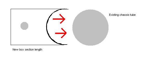

My only concern with this is that it is going to put a lot of rotational stress on the existing round chassis bars.....
I'm guessing the £70 includes fabrication time. Stainless sheet shouldn't be so much more expensive than mild.

The £70 was just for the stainless box section!!! I would have needed 4 meters of the stuff if i was going to go with plan A which was to put complete lengths of box section across the chassis.

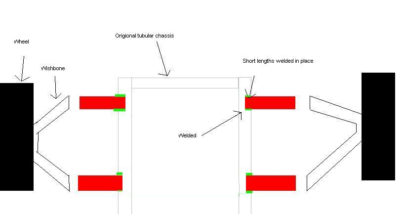

plan B would be cheaper as it requires less material, but will it be strong enough?
I think it would look neater done as in the pics, with the brackets fab'd from 4/5mm stainless.
Nut sure on the diameter of the tube, 38mm? Make the brackets quite wide on the back (25mm ish)so it eliminates the twist and wont peel off.
I would agree with you about the method in the photos looking the smartest.
The tubes are about 40mm with 1.6mm walls...(might be 2.1) I cant measure it! (the material is the stuff they use to make exhausts out of!)
My concern with the method shown in the photos is that; is it possible to get a strong enough joint? (obviously adding gussets and such like would be a must!!)
and will the tubular chassis parts take the stress without giving up?

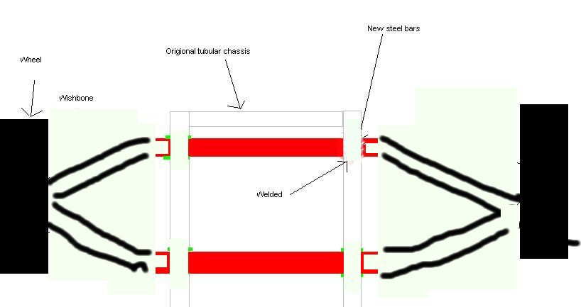

I was thinking of something like the drawing in my attachment below (please forgive my lack of effort in drawing).
If the wishbones can reach as far as the chassis then U shaped brackets should secure them OK. A total thickness of 3mm for the brackets should be OK.
My concern was about the load transmitted from the wishbones. They've got lateral, vertical, longitudinal and torsional to choose from. Assuming you have rubber bushes then vertical is next to nothing - push the wheel up and the bushes will twist with no effort - verticals are taken by the damper. Torsionals go away the same way. There is some longitudinal, that's why you need 3mm. But the lateral forces (towards the centre of the car) are very high. Suspension bushes are often specified up to 20,000Nm in that direction to make the car handle. That's a couple of tonnes per millemeter.
My rough drawing has the tubes between the chassis rails which would spread the load between 2 tubes rather than one. Think of puting the chassis on it's side and having an elephant sit on it. The cross tube makes both lower rails take the loads rather than just one.
A diagonal tube up to the upper rail would make 3 tubes take the sideways load. 4 tubes if you have a cross brace somewhere at the top (although the upper wishbones themselves won't take a lot of load so it's not neccessary just for them - a lot of car manufacturers have very light and slender upper wishbones).

That way makes a lot of sence. I can pick up 409 grade exhaust tubing a lot cheaper than I can get box section. So if I use the tube for the internal cross braces and then sheet for the actual brackets that should work ok.
Do you think the cross chassis bracing has to be directly behind the attachment point or could I get away with say 100mm either side?
