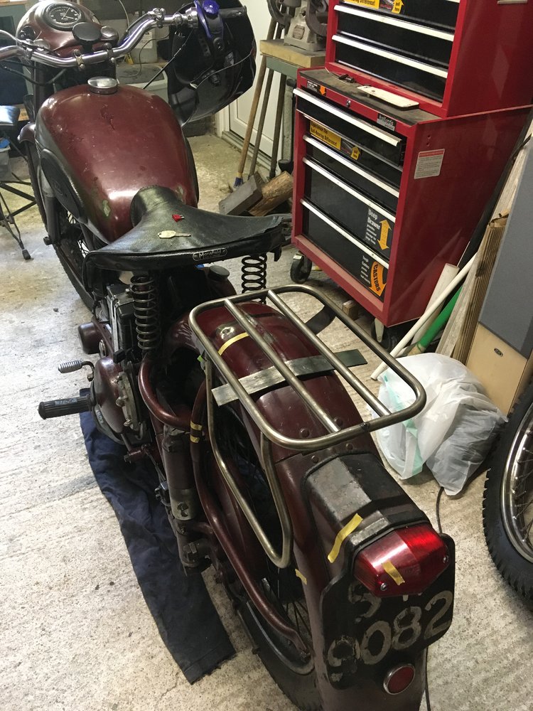

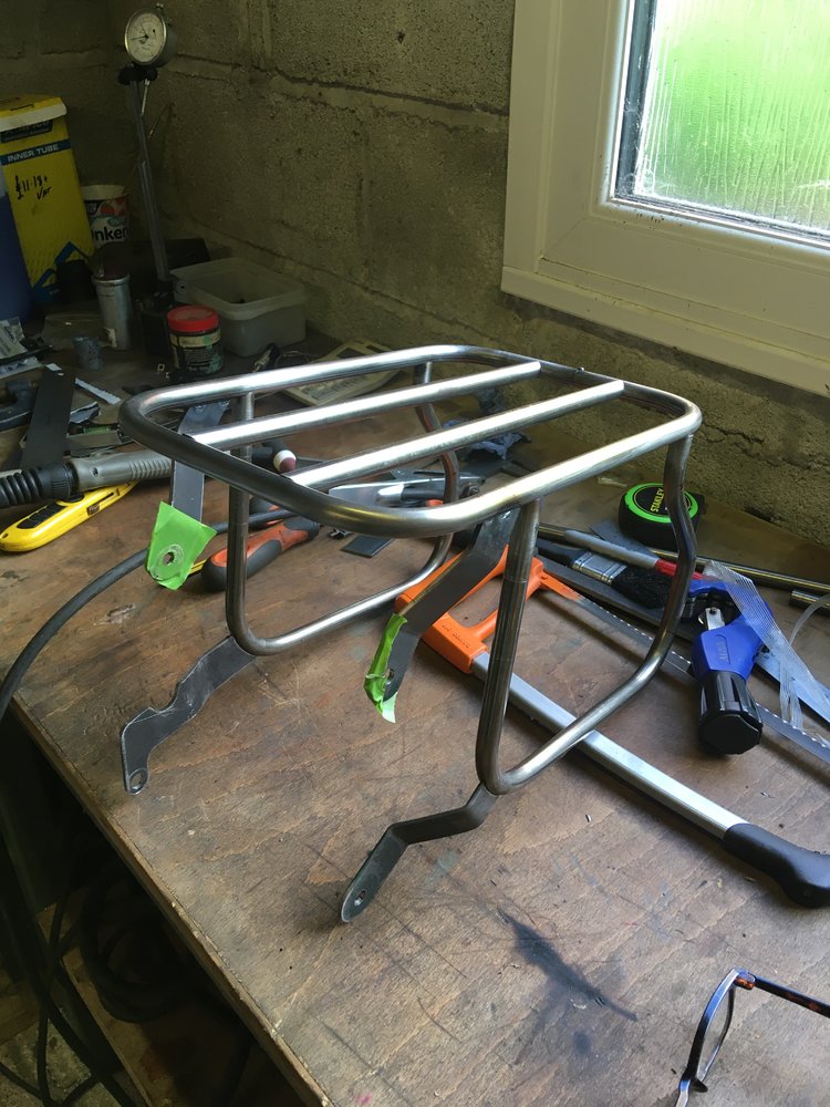

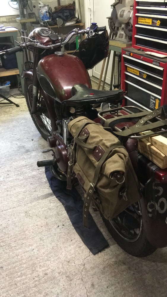

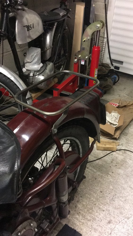

Ukracer easier on a bench? not for me.
Bolt the lugs onto the bike frame then tack the pannier frame one to them and see how it lies. I'll do a quick what I call a 'slutty build' does it get in the way of feet? does it fit nicely? yes does it look good etc etc. First build out of offcuts then copy it using decent material.
Hopefully pics in a day or two
