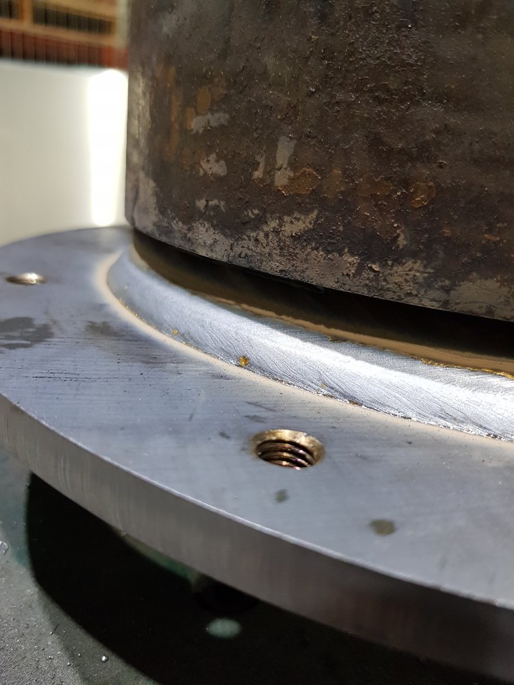

I agree, but it is hard to tell because the angles are hard to see.IMHO the nozzle is a bit far away, and the electrical stick out is also pretty long.
Need some pix of the weld, and the video of it running would help immensely.

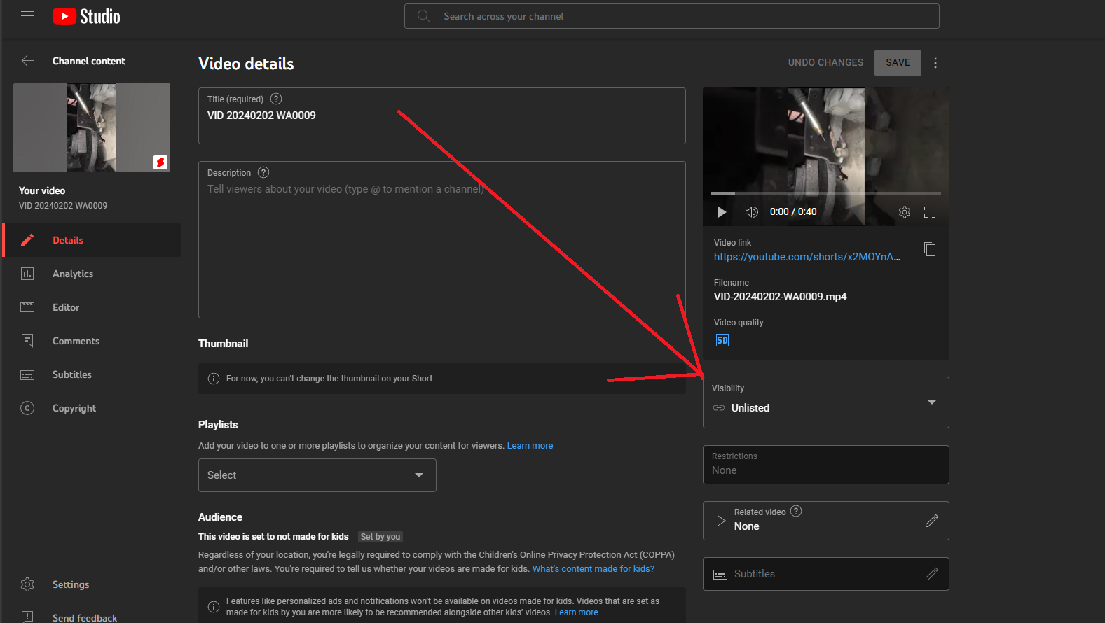

Thank youA screen shot from the video attached above.
(I have access to VMs to open files like this at work in a safe environment.
There was nothing untoward in the zip file )

Request feedback on how to reduce spatter based on details shared thus far

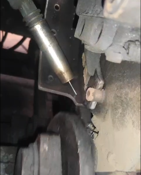

Need to see and hear the arc, and the resultant puddle.Here you go

Apologies for the delay in uploading complete video indicating how anti spatter being applied on component before clamping on machine to begin welding. Trust Video is giving required information
Please revert back on how to contain spatter

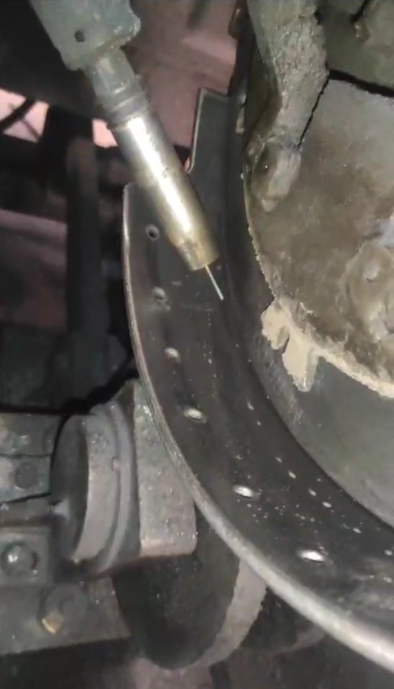

Sorry due to welding fumes, unable to take a video from CloseIt does not show us much, need a view thru a helmet, to see the wire, and the arc.
Note the "stubbing" start, sounds like wire speed too high.
Might be in short arc mode.
Thanks for your response. We will minimize usage of anti spatter. When we bring nozzle and tip closer to the workpiece, then there are challenges with regard to bending of torch head because currently gap between torch and workpiece is about 15m , moreover workpiece to be welded is semicirular so torch fouls with workpiece if brought closer than existing. We are using Argon with CO2 at 80:20 ratioFirstly, stop using anti spatter like that. It will not be helping anything and quite possibly be part of the problem. It's FAR FAR too thickly brushed on.
Next, get the nozzle and tip a lot closer to the workpiece. That stickout is excessive and it causes it to drop current (meaning the voltage will be too high for the current and therefore create globular spatter)
After that, start tweaking the voltage (if it's inverter based) and/or wirefeed to get a spray transfer with no spatter at all - easily done on a quality machine with clean workpieces.
