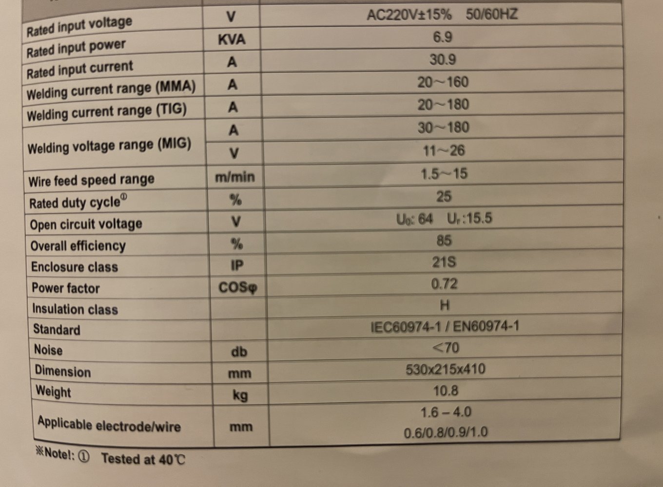

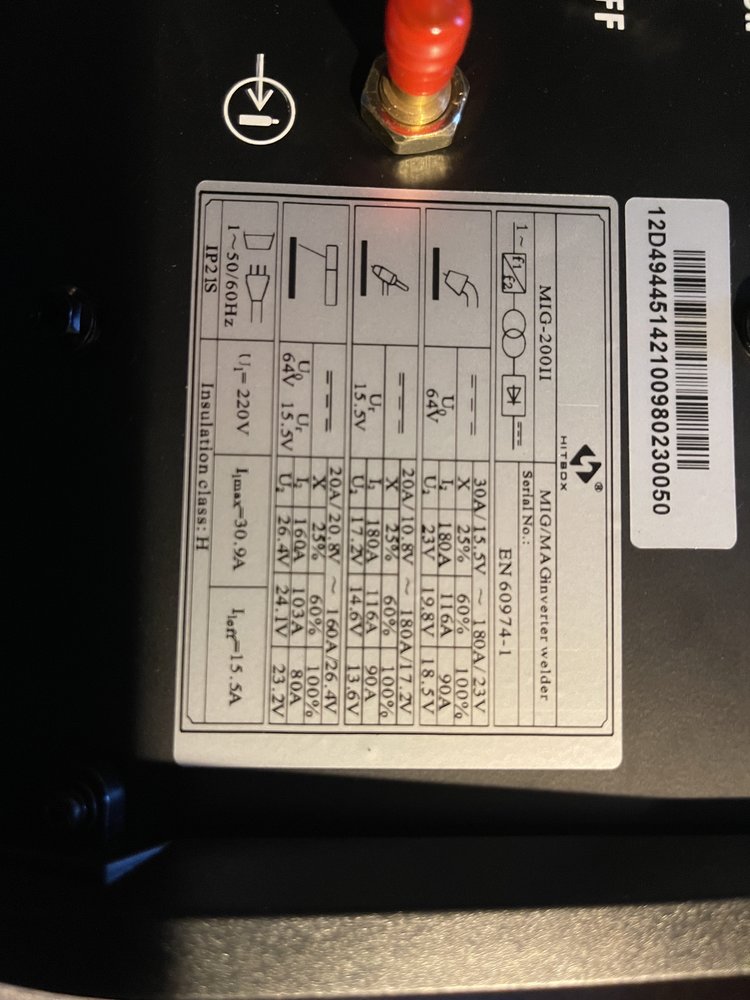

Before starting to use this BRAND NEW machine supplied by the agent, I looked through the operating instructions including the specification and noted that has an input amperage of 30.9amps.

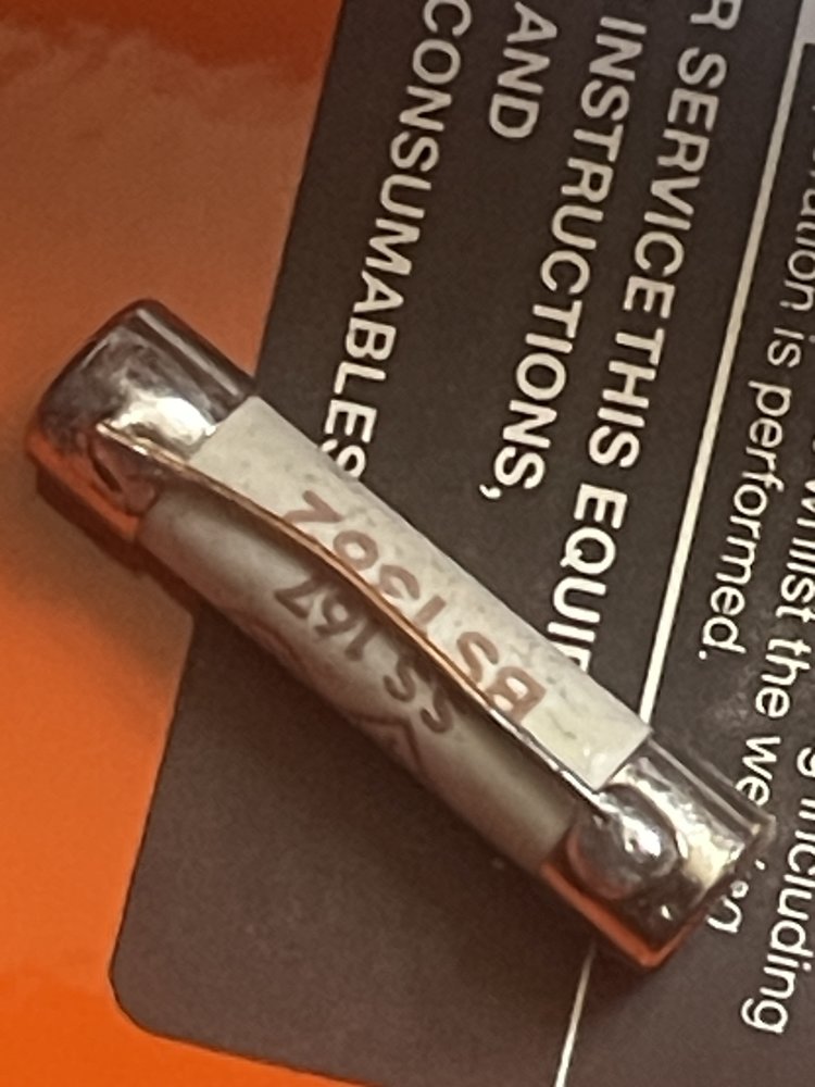

This caused me concern as it is fitted with a 13amp plug and on removing the fuse have found that the fuse has been bridged with a piece of wire (not fuse wire) - see attached image.

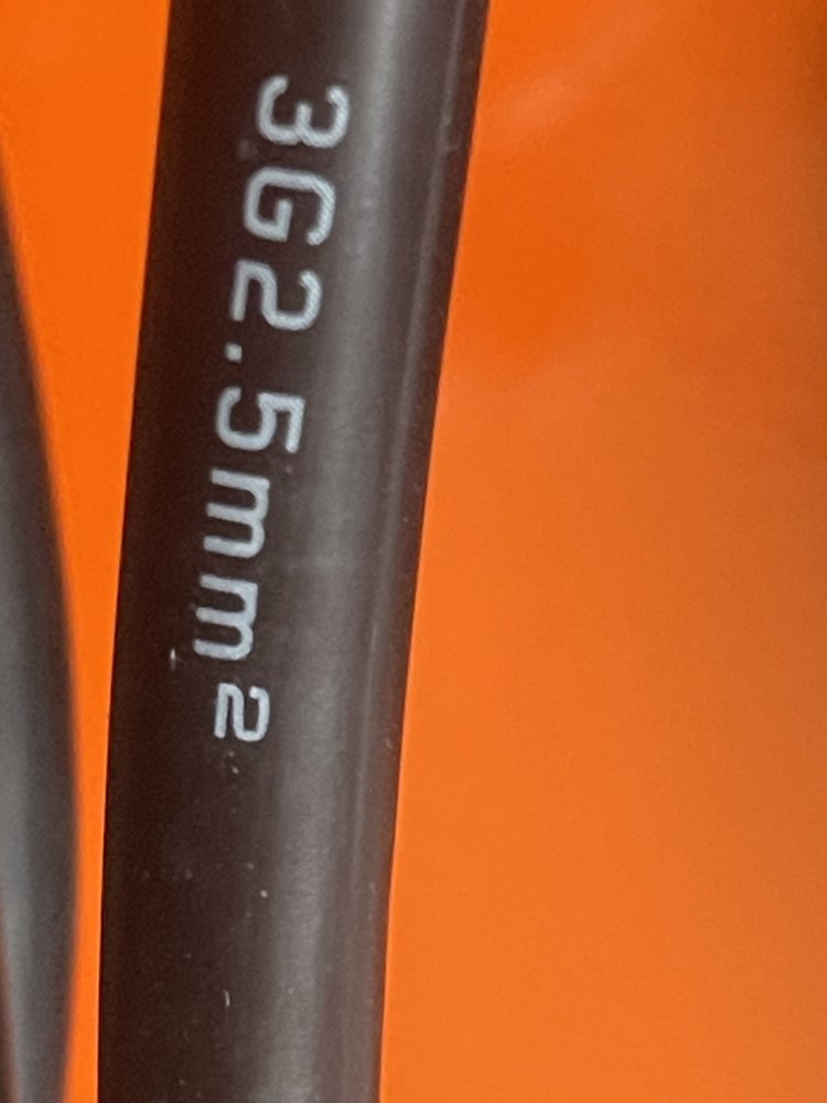

Having found this I then looked at the specification for the input supply cable (see attached image) and from the identification markings was able to establish that the manufacturers specification for the cable is 20amp.
From your experience, would you consider it safe to use as it seems to me that it will over load the electrical supply and will be a fire hazard.
To my mind, this welder should be fitted with a 32amp plug and a cable from the plug to the machine also rated at 32amp.
