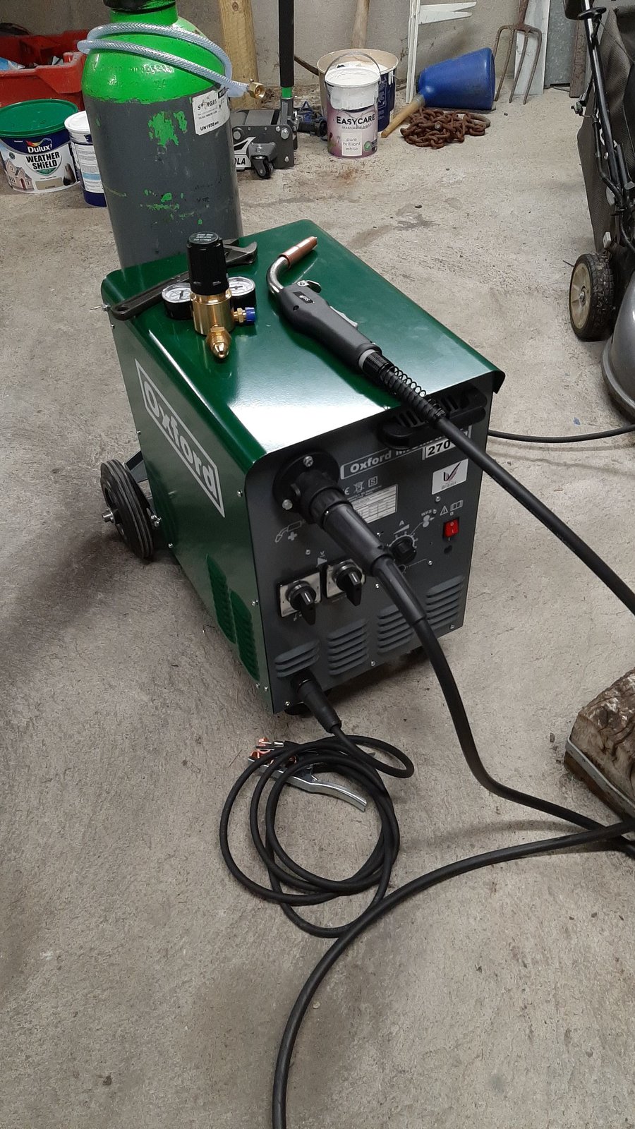

Yes i have to say I am and i am very happy with the welder I gotthe most important thing , are you enjoying it all so far.

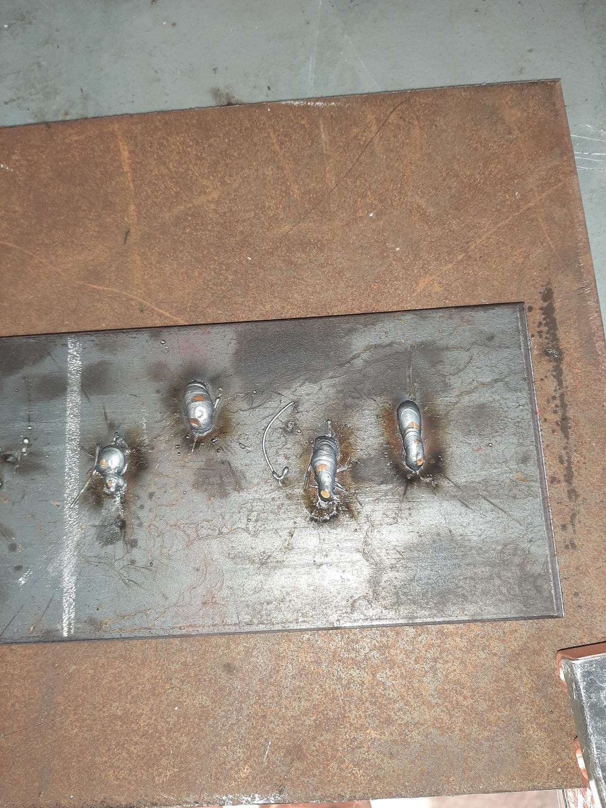

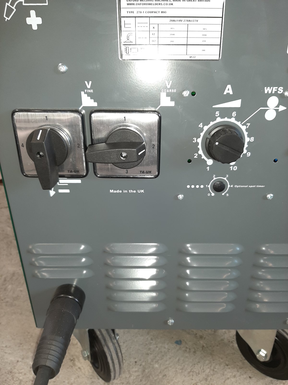

Which one do I turn up
I don't live near tom im from wexford IrelandLike I said, I'm not familiar with your machine, but it looks like the controls are "Fine Volts", "Coarse Volts", and "wire-feed" speed.
I'd put the "coarse" control up at least one notch for a start, as being in the lower half of the settings (of the available 270A) won't be enough for 5mm steel.
I'm going by the symbols, here - as I can't quite read the writing from the photo.
And what's the other control with all the dots - a spot weld timer?

You didn't post any photos of the rear of the weld, but when it's fully penetrating (which it won't be at the moment) you'll see the weld (not just the heat-signature) almost bleeding through to the other side of the steel.

With regards to the wire-feed speed - when the power setting is about right, try turning the wire-feed right up until you can feel it "pushing against" or "stabbing at" the work-piece - and then back it off until you can no longer feel it ramming into the steel (and then maybe a wee bit more!) and you should be about right.
If the wire starts burning back to the tip as you weld, you've probably turned the wire-feed down too far.
It's sometimes a bit tricky, as you have to be welding while you adjust the wire-feed speed setting - but I'm guessing it would work doing shortish runs, and then making any adjustments in-between those short runs.

I tot i was going to fastslow down a wee bit , and a tad less wire , let the puddle actually form then watch it move as you do ,,, who cares if it burns through , your only practising ,, get an idea of the look , sound and feel of burning through.
try a lap joint , its much more fun and youve a couple of bits of plate to hand
