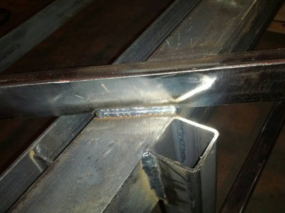

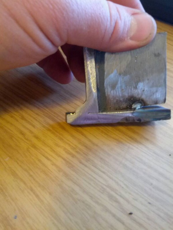

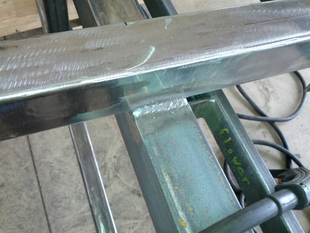

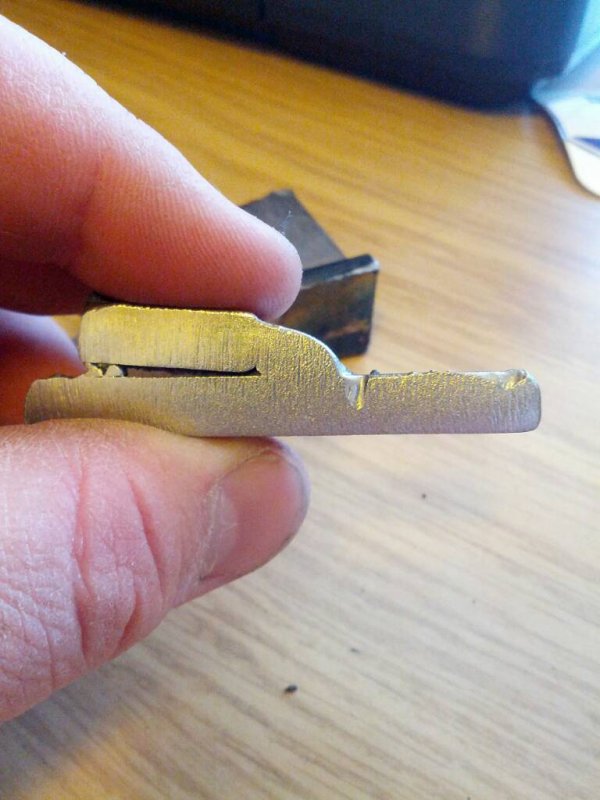

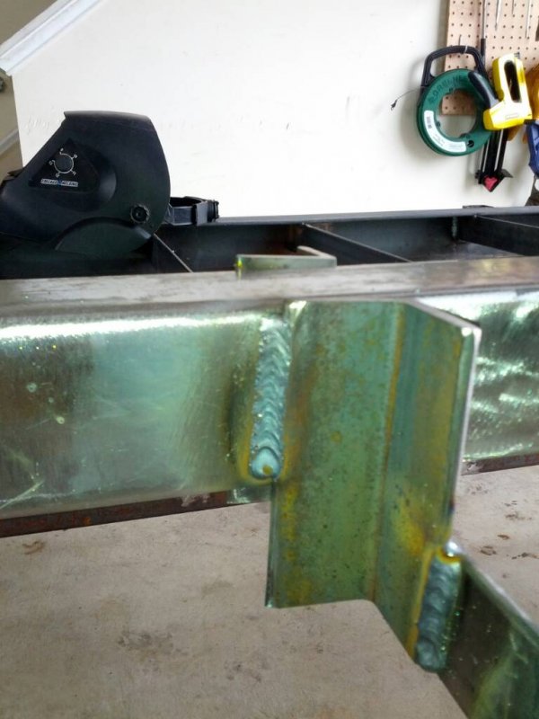

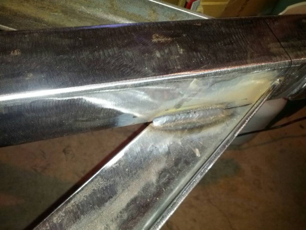

I was concerned about the welds being cold, so I did a cross section. I cannot tell, what do you all think?
To my eye those top 2 pics on this page seem to have zero penetration. There's a visible gap where the two parent metals meet which should have been filled by the weld pool during welding. The butt joint looks like the wire has just fused with the edge of the top piece and then arched down to fuse with the lower one, but none of it has run between them. The same seems to have happened with the 'T' joint. A bit more heat and a slightly wider gap between the two pieces being joined might improve that.
